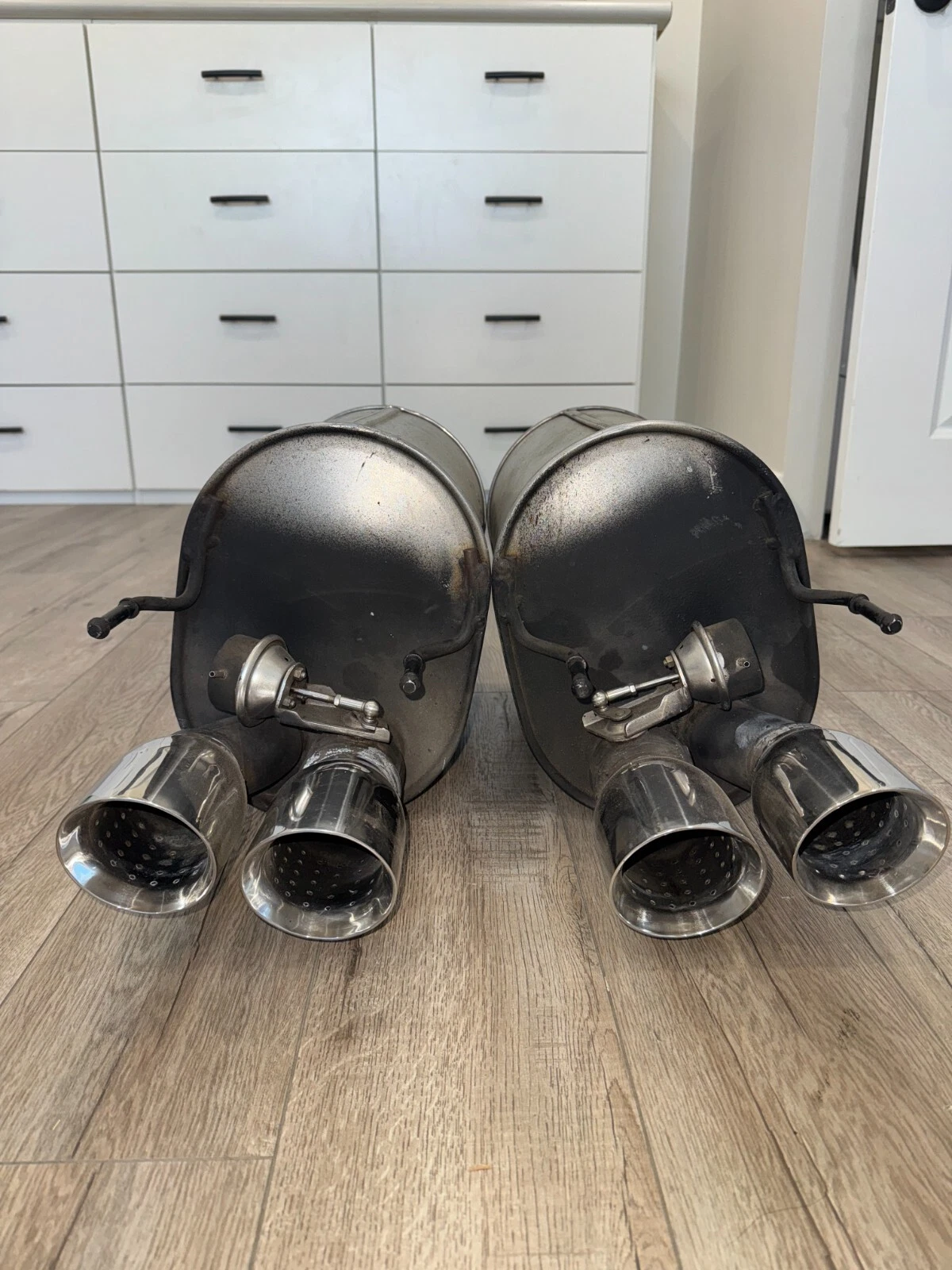

You sure you dont have the NPP in a box kit already in the car when you bought it? And it was left in the quiet mode? your just missing the wireless remote? never given to you when you bought the car. Which ever owner installed the mufflers they must have installled the NPP in a box kit otherwise whats the point of just putting the mufflers on without anyway to control the flaps--open or closed. See if you have the vacuum lines installed on the actuators that open and close the flaps on the mufflers see pic below for reference. You will have to crawl under the car and take a quick look. There should be vacuum lines connected to the nipples on the actuators on each muffler
