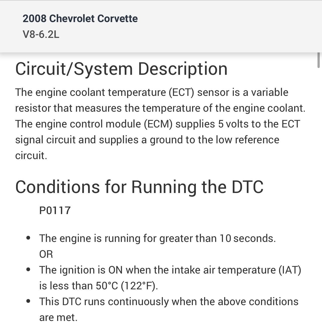

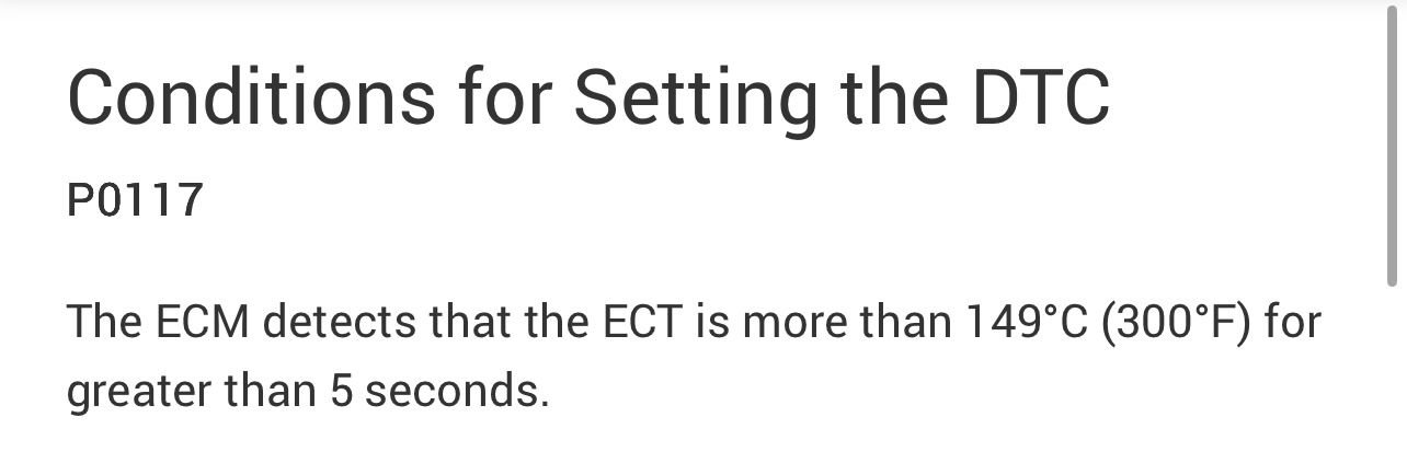

Here is the code description…let me know if you want to diagnose this yourself…I don’t know how much electrical experience you have…maybe wiring or maybe sensor.

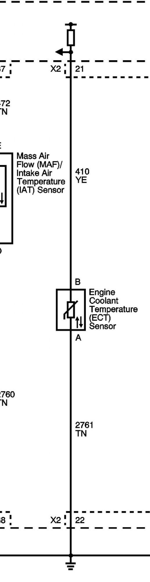

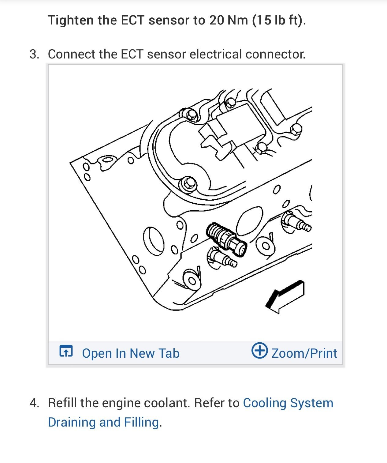

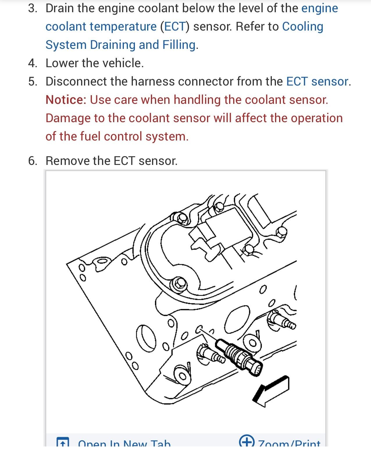

You have to understand how these thermistor circuits work to diagnosis this…no need to change the pigtail for a 0117…as I mentioned if the 5 volt reference wire were shorted to ground somewhere between the ECM and the sensor the ECT will max out as the code description tells you…if you were to take a jumper wire and jump out the 2 wires on the connector you would see your ECT max out…if the sensor is shorted out internally you will see the same thing…when you disconnect the sensor you will see -40 degrees because the ECM is seeing 5 volts…the sensor is located above the #1 spark plug and below the alternator…it gets unscrewed and always best to use an OEM sensor…you can get one on Rock Auto.

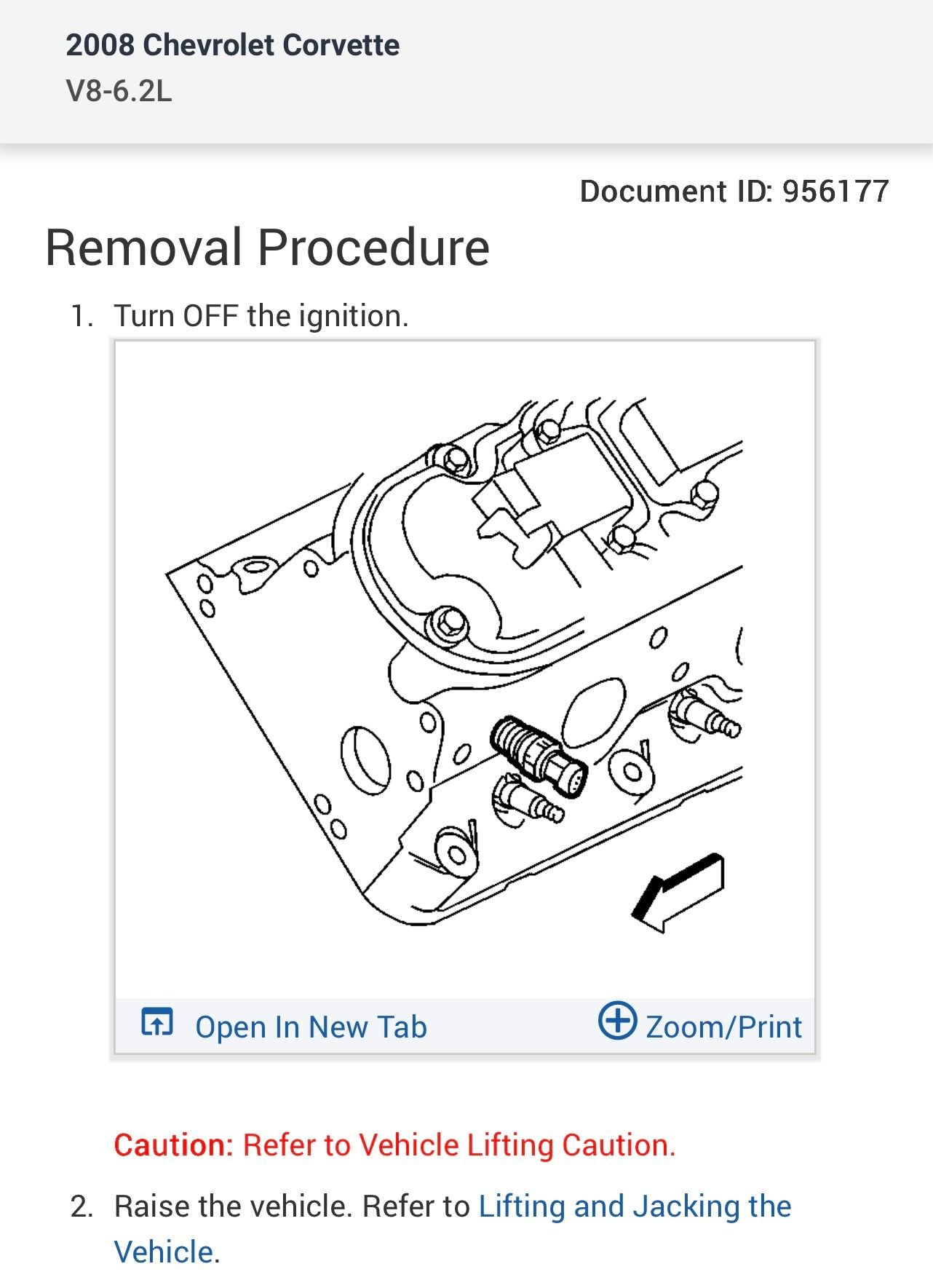

I could do this no problem. Just wondering what mm deep socket is needed to remove it?

From: Cape Coral, Florida
If you have a socket set I’m sure you can handle it !!

With ignition on first see if you have 5 volts on the yellow wire…you can try wiggling the harness as much as you can until that 5 volts goes away…one usually finds these shorts where the harness may bend around where it can contact the engine block somewhere…hopefully just a bad sensor…good video below.

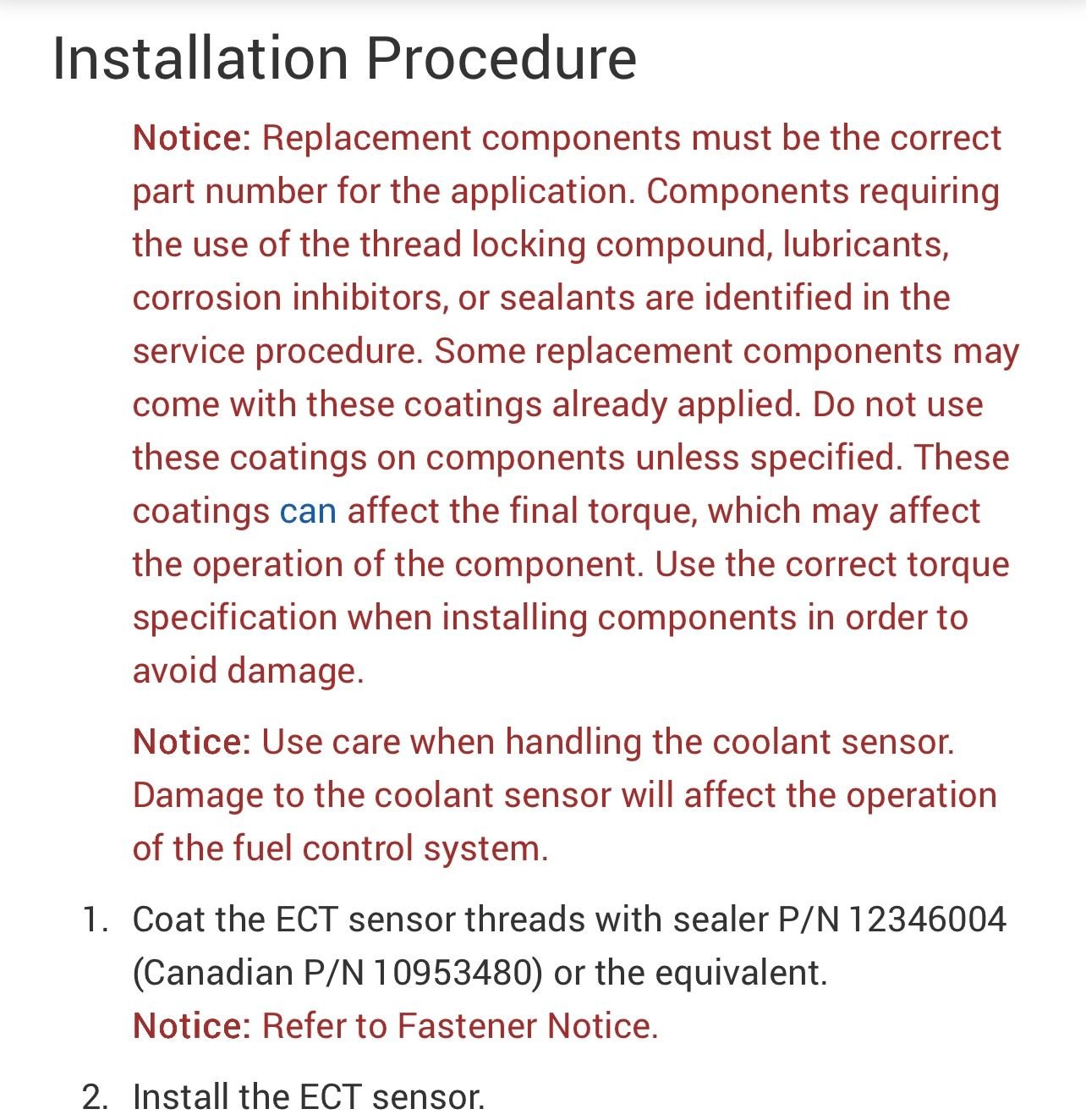

You want to use this sealant with the Teflon.
