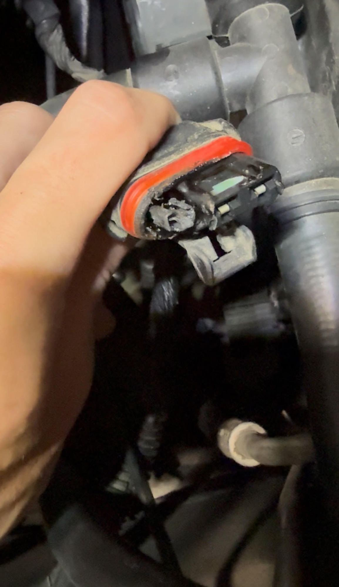

I should have clarified this, but I am not a tech at all. I work in an office and like to learn here and there when I can! Got to dive into it this weekend and found out that I have the melted plugs that tons of people seem to run into (sorry I do not know the technical term for them). I had said fans were running in the initial post, but I believe that the burned plug is making it function intermittently.
I am now looking at either replacing those plugs, or replacing the entire assembly. I have heard the melted plugs typically indicate an issue with the fan somewhere so they are likely to burn up again.
With that being said, I would love some recommendations on fans to use. GM quote is $450 for the OEM fan assembly (with employee pricing, think it was like $520 customer pricing) but I feel pretty confident I can find something better for cheaper! Any advice is extremely appreciated. (Would also like to note that I have the stock radiator in)

Just bypass that connector and hard wire them together. The fan isnt the issue. Even if you replace that connector it will melt again.
Old Jul 22, 2025 | 08:44 AM

I have read some people state that doing so will push the issue elsewhere, any proven truth to that? I daily the car so just trying to find a semi permanent fix!

I did mine over 4 years ago. It doesn't move the problem. It removes the problem. The terminals in the connector cannot hold that much amperage without heating up and melting. When you bypass. The issue is fixed. But if you add any wire I would use a minimum of 10g. And do a good solder/ heat shrink splice

Fan pulls a lot of amps and over time the plug may begin to overheat. Happened to me several years back so I just spliced the wires with something similar to the link.
https://www.grainger.com/product/POL...r-14V967?gQT=1
