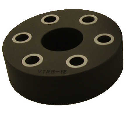

any advice on torque tube and couplers? Billet coupler?

As for torque tube couplers, pass the 6 shooter or solid couplers, since they love to break bolts in the rear coupler ,
and just go with the poly couplers instead.
Your under 1000Khp, should not have a problem with pretzel'g/twisting the oem torque tube shaft between the couplers, with the tires your running..
