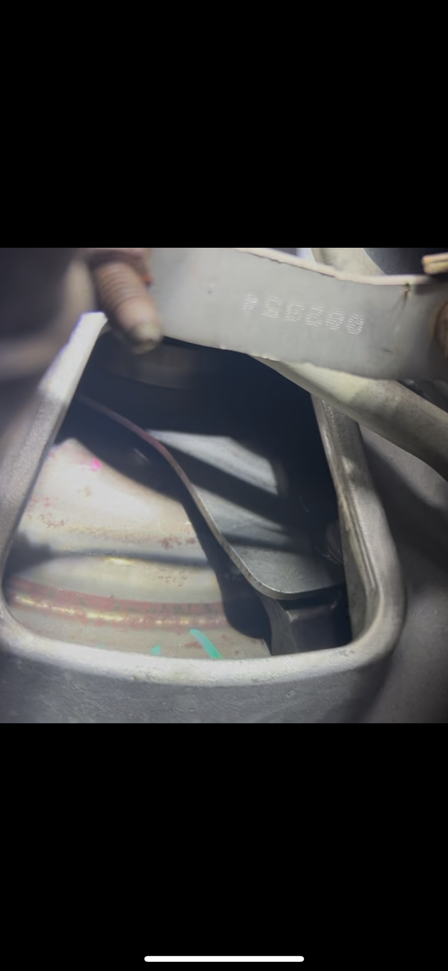

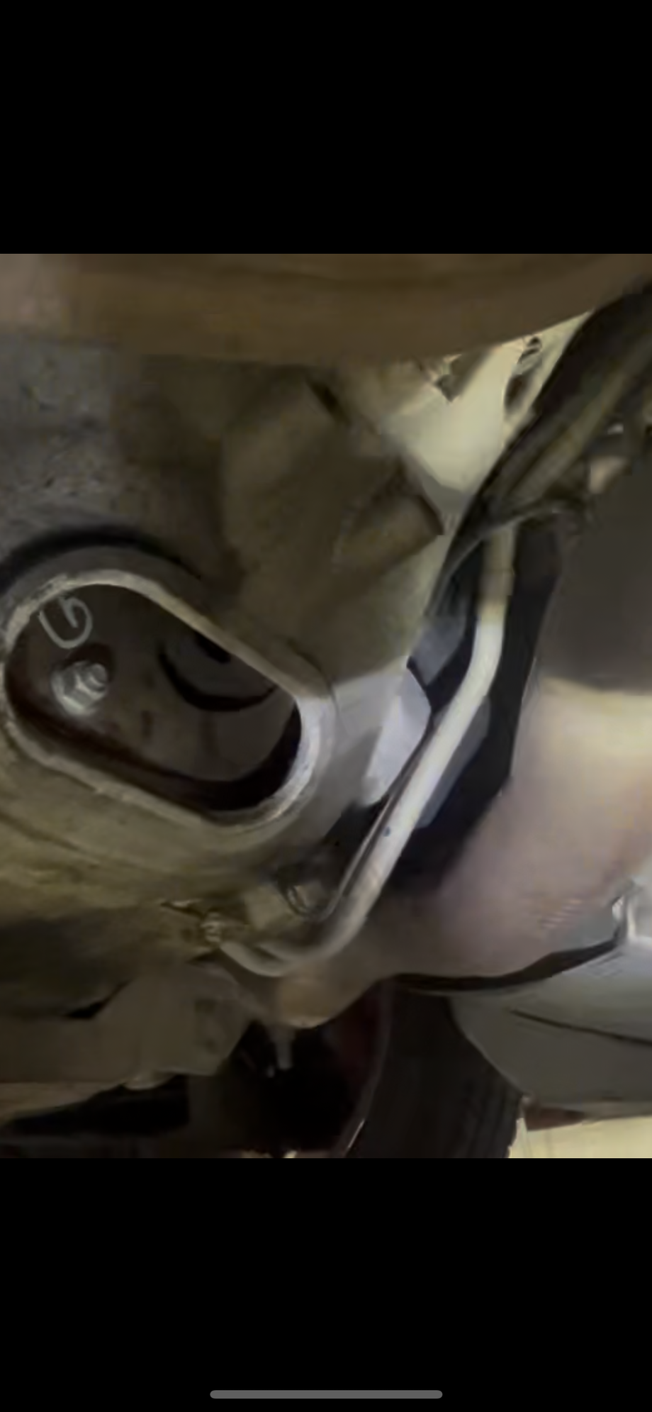

My mechanic told me that I have movement in my torque tube this is why I having misfires and engine light is on. Can anyone verify this please. This is for a 2009 corvette.

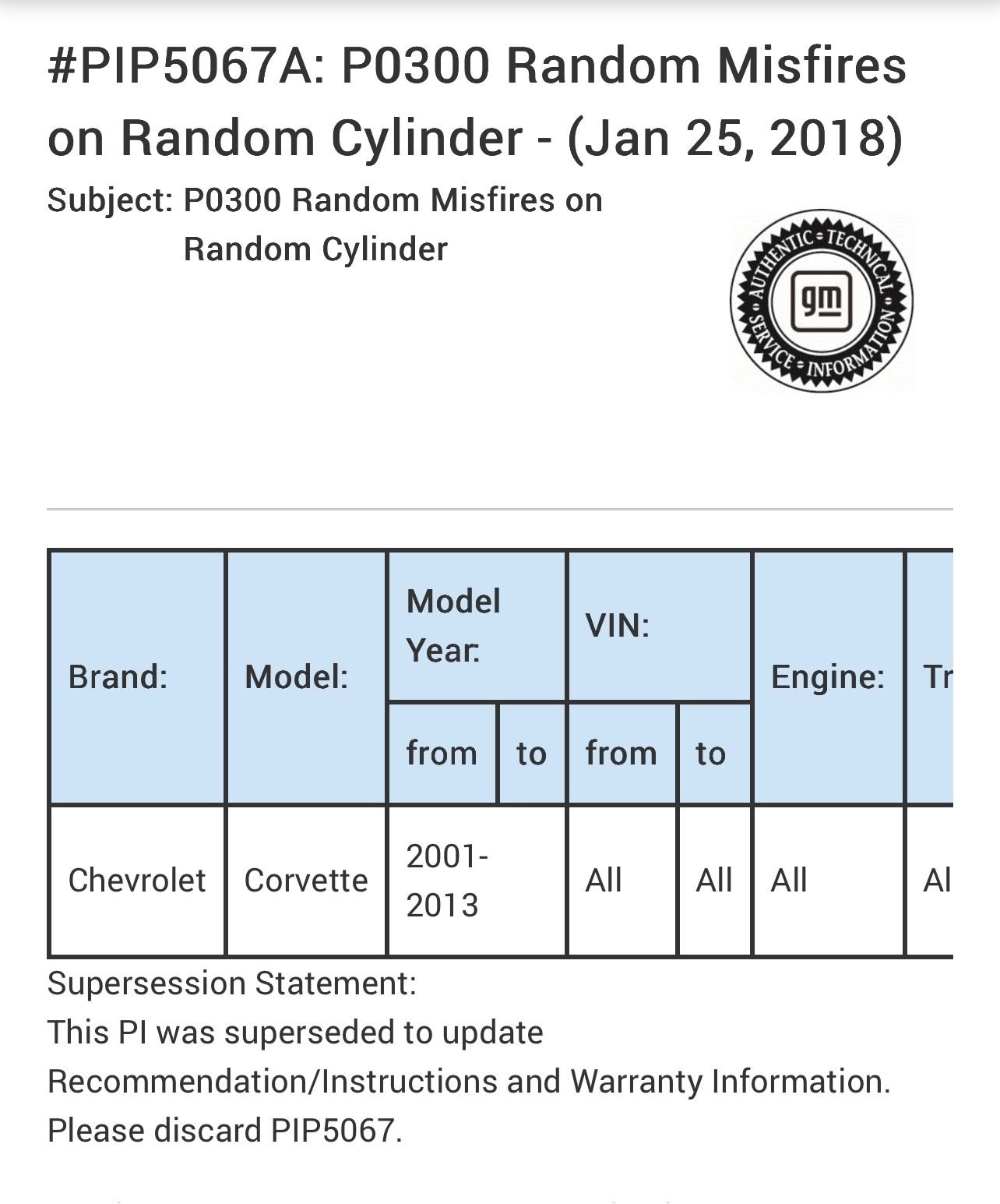

Yes, having worn torque tube bushings can cause a P0300 misfire and there is a TSB concerning this.

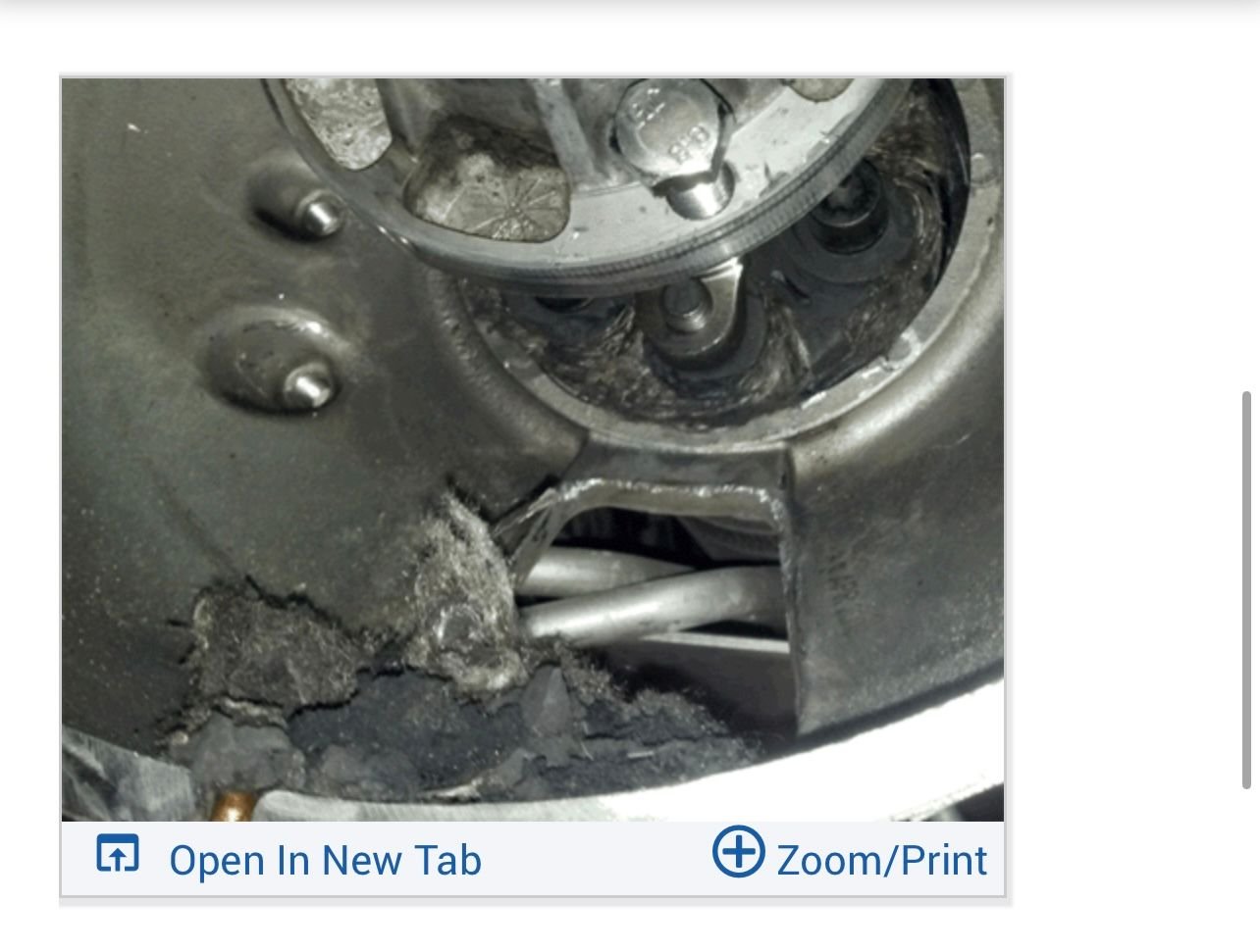

Originally Posted by C5 Diag
Technical Sevice Bulletin or TSB…
That's chewed to pieces, wonder how long that was making noise

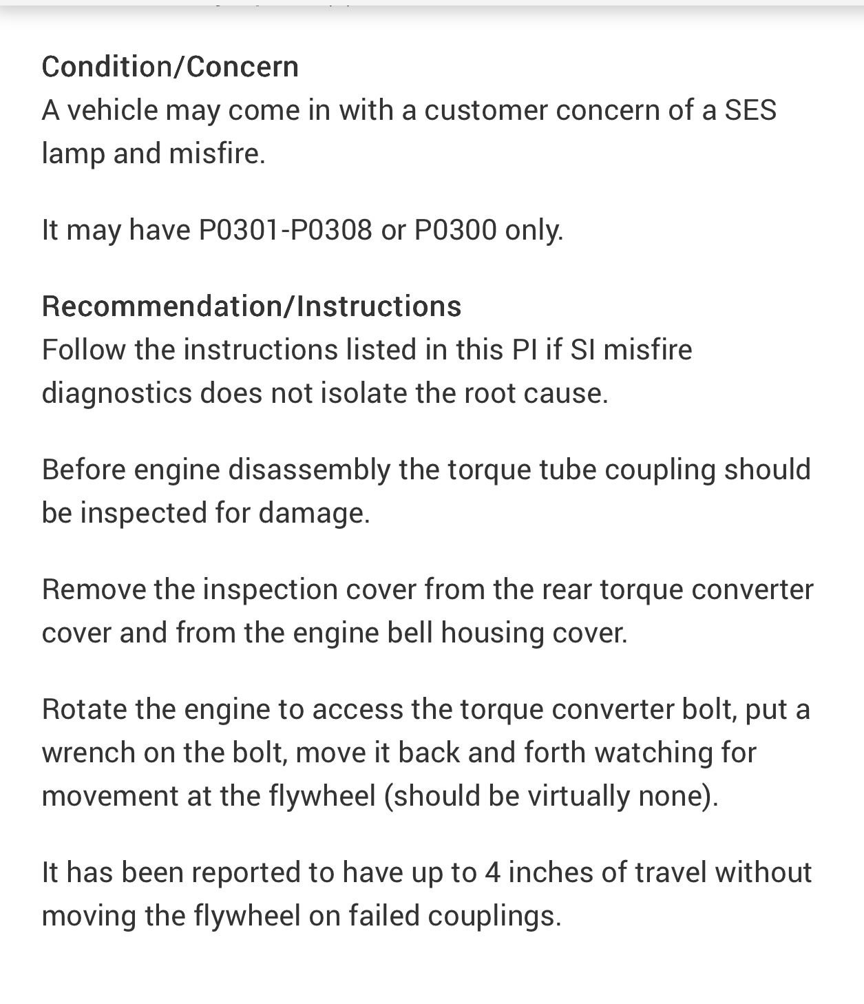

The computer detects misfires by looking for drops in crankshaft RPM. If the RPM drops are correlated to a particular cylinder, you get a cylinder-specific misfire code. If they are all over the place, you get a P300 random/multi-cylinder misfire code.
If the torque tube couplers have fallen apart, this can cause variations in instantaneous crankshaft speed that look like misfires to the computer.
Other causes of misfires are more common.
https://static.nhtsa.gov/odi/tsbs/20...12462-9999.pdf
