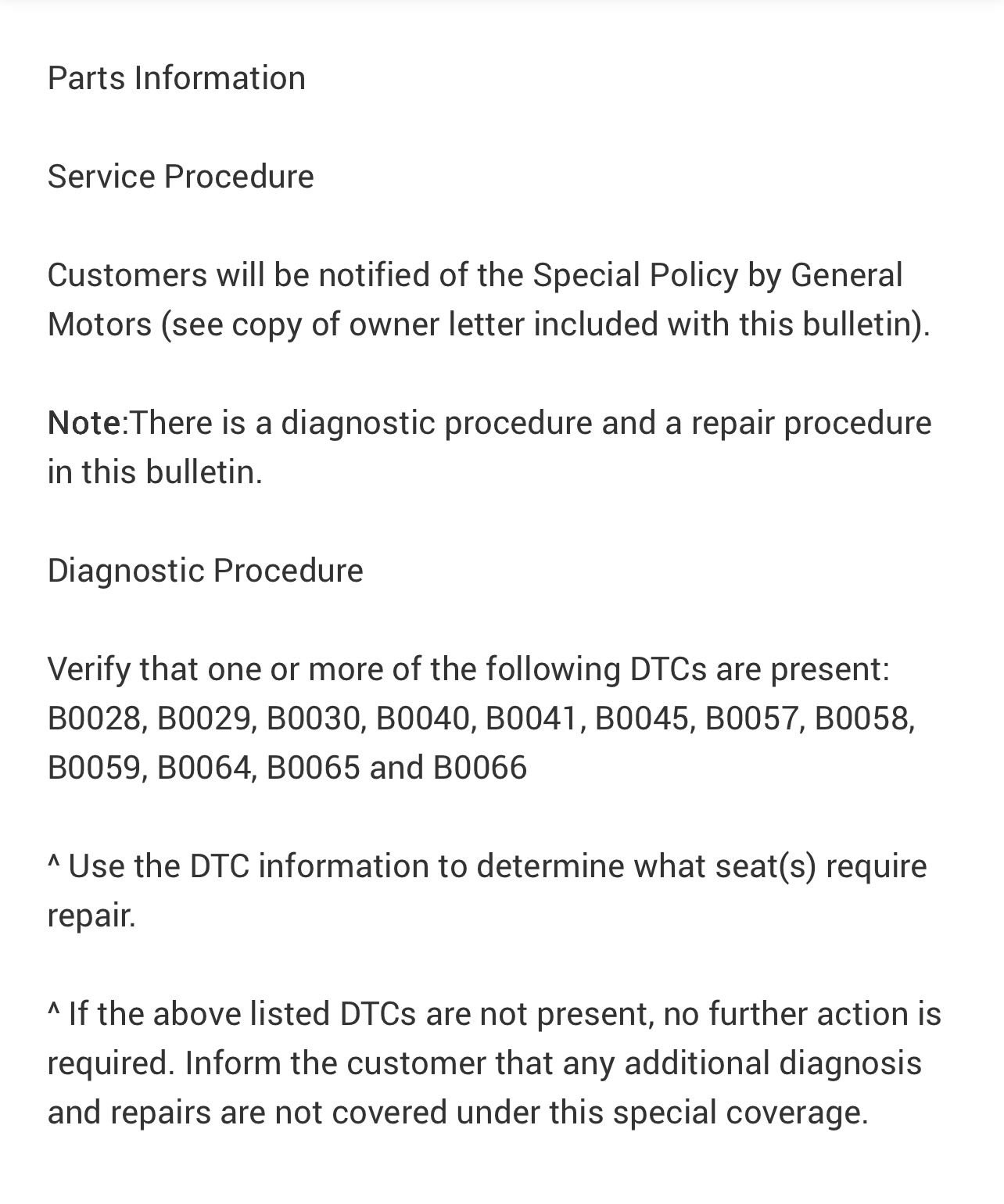

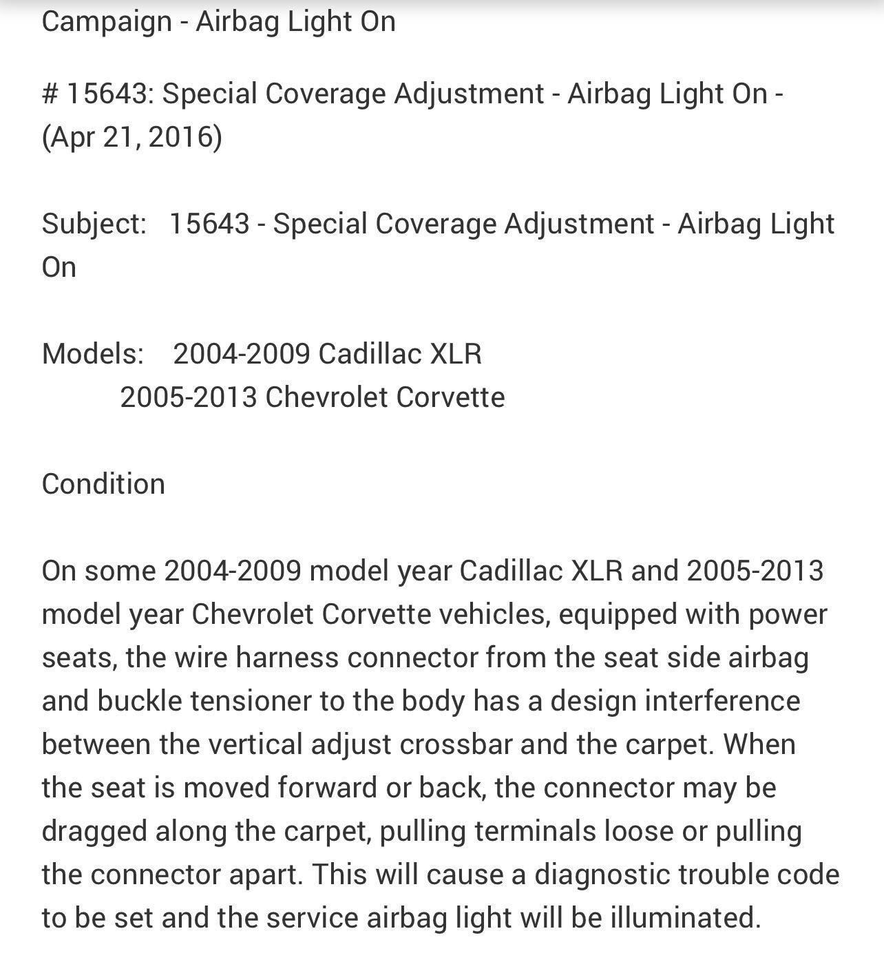

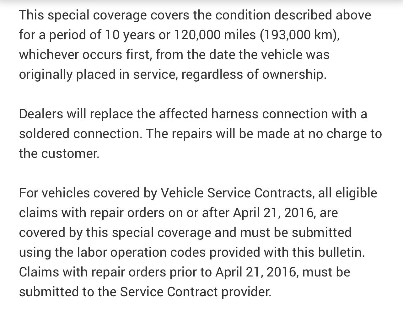

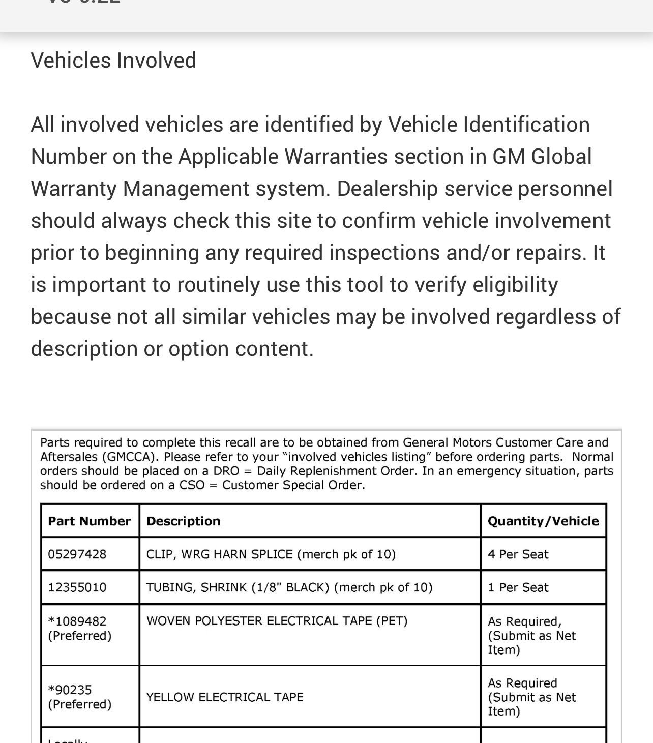

There is a “campaign” vs a recall for the airbag light which is in part below…I believe you could have been reimbursed for this issue but it is beyond the 10 year limit…if this is a wiring issue I HIGHLY suggest you either let an auto electric shop or a dealership do the repair…not a DIY repair since it is the airbag circuit !!

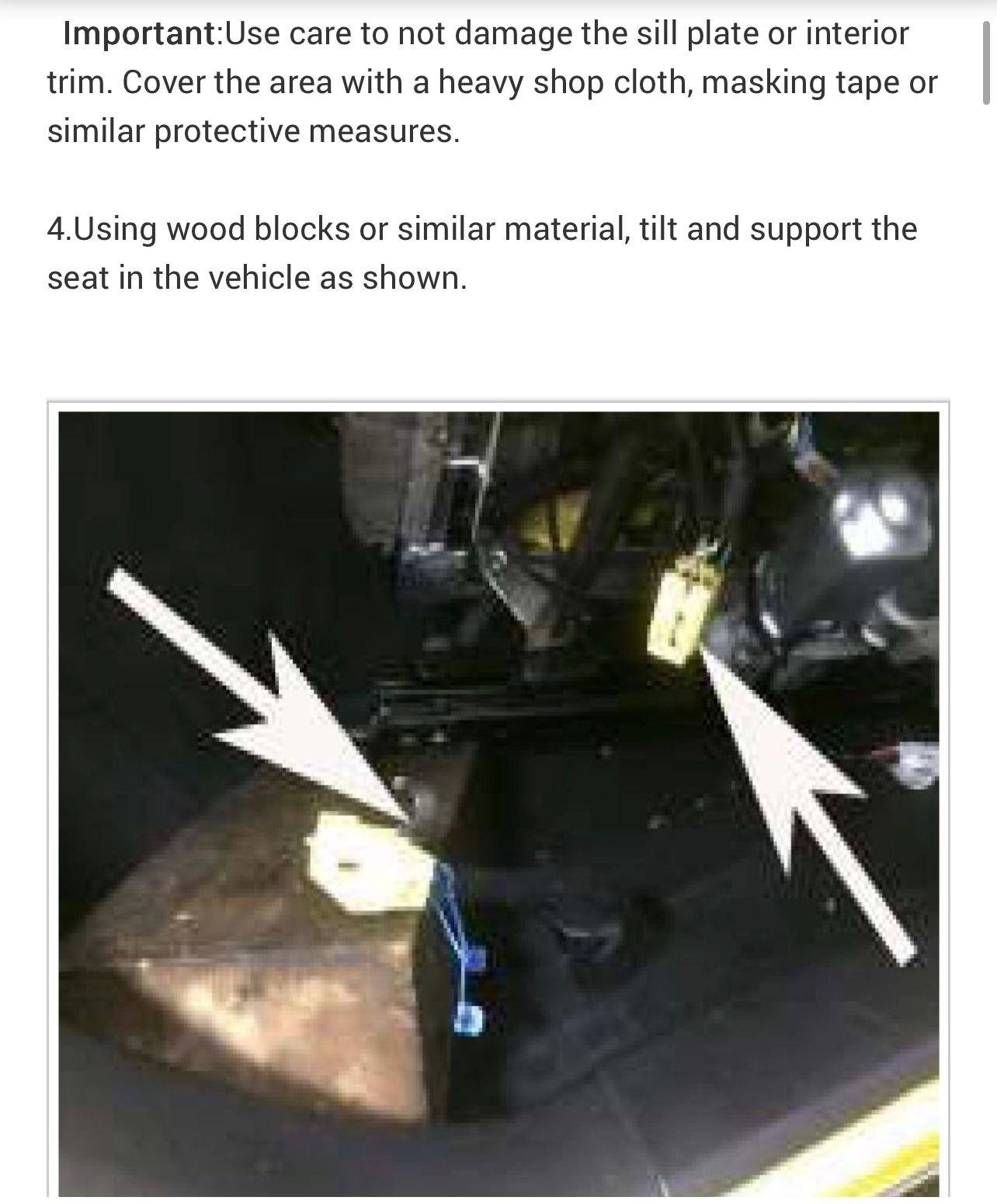

Thank you for this information. I went for a ride today and the icon did not light up.
I recently had the drivers seat out so I will double check the connector.
The pic is blurry but I guessing it is the yellow connector, correct

Yes, the yellow connector.
