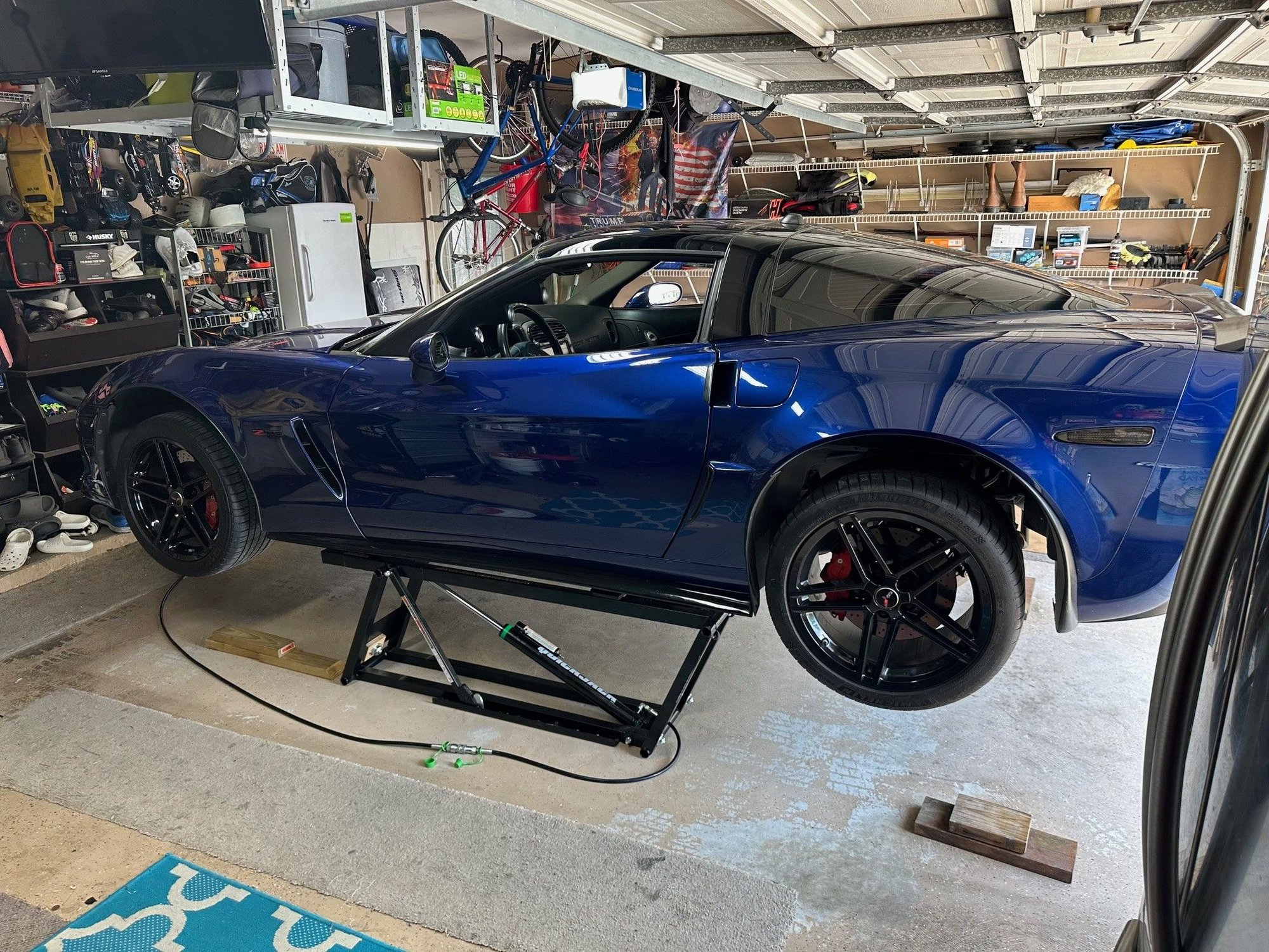

I got the 5000TL as I also do my 2018 Trackhawk with it. The pads where you put the lift blocks are only just narrow enough to contact the jack puck points on the C6
So I use a piece of wood across the lift instead, works fine.

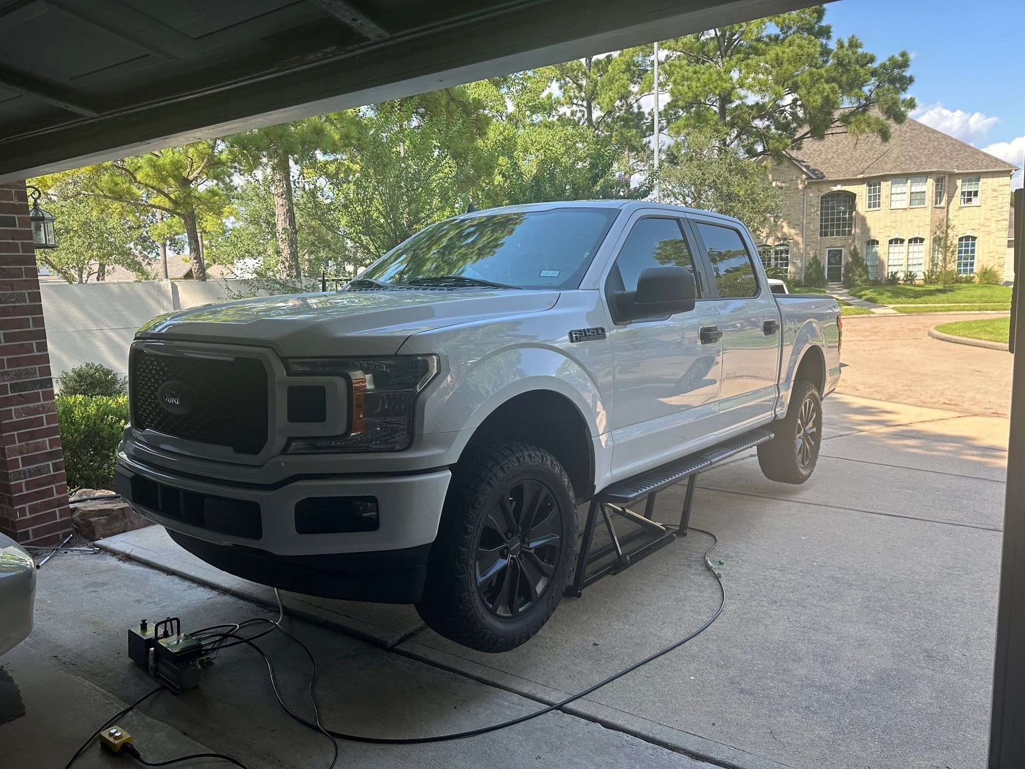

The 7000TL will work but it does not align with the lifting pucks, I use a piece of 1/2" plate across the frame of the QJs with smaller rubber blocks in order to align with the rear lifting pucks for my c6. My car is lowered with side skirts so I have to drive up on blocks in order to get high enough to place the quickjacks underneath, pain in the *** but worth it if I need to get the car up higher. Works for my son's F150 very well.

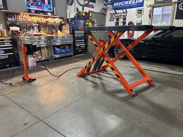

This is a TMG Industrial but there are several that make these and they are all very similar. Bend-pak, Atlas, etc.. Search for "mid-rise portable lift"
I like the lift but assumed the moveable arms would fit the width of the lifting pucks and they were a few inches shy so had to buy some longer arms that fit from a different brand.
NOTE: Measure width of lifting points on Vette (forgot what they were) and make sure the width of lifting arms of lift will work.
ALSO: Will need to either make or purchase ramps because Vette is too low to drive over lift. I got set of Race Ramps that are full length.
These are movable but need a place to leave it. I have a 3 car garage and leave it where I park my truck and drive over the lift.
Vette is parked in the winter so will park Vette on ramps and leave lift under the Vette
