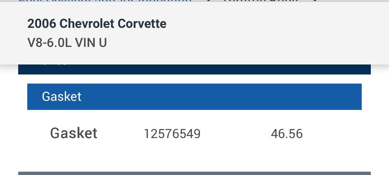

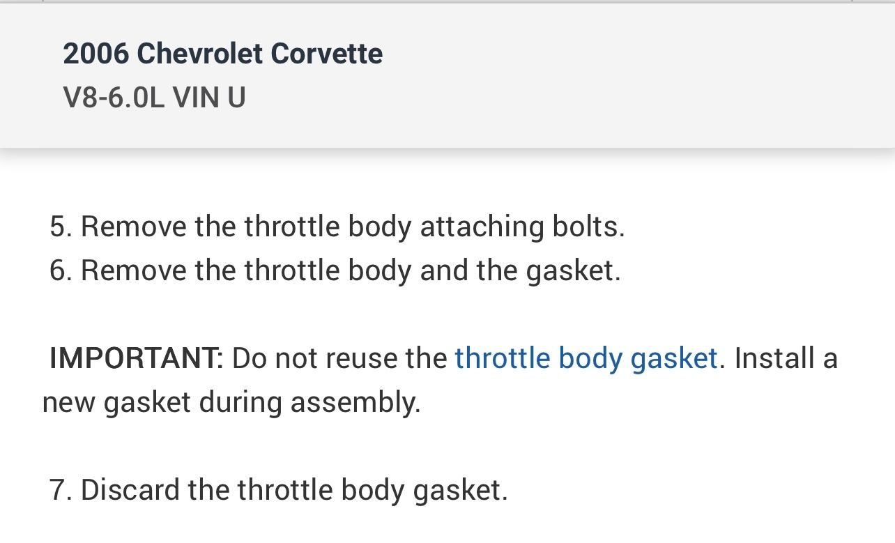

You took the throttle body or the TPS sensor off the car to clean it ???…a TPS sensor is normally not removed and cleaned because it is the electrical part of that component…I’d make sure you have no leaks at the TB if it was indeed removed…what codes were you seeing ??…you can open and close the throttle plate by hand to see if it is binding…hope you didn’t take it apart…do you have a scan tool ??…may be a vacuum leak…did you use a NEW gasket during reinstallation ??…you may have a vacuum leak there…it is ALWAYS a good idea to use Service Information when doing any maintenance on your car…this info is from Alldata DIY…you SHOULD get a subscription to it..1 month, 1 or 3 year.

I did not replace the gasket, so I will now correct that rookie mistake. Thanks
