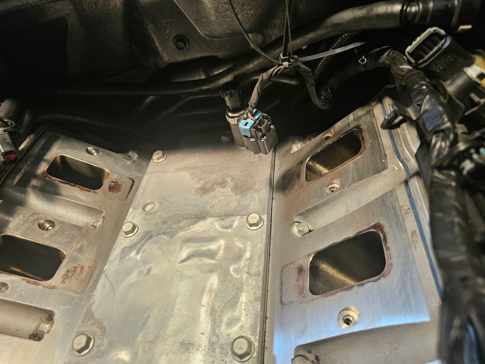

Looks like the sender... however...
I have the Atomic Air intake which does not give me enough room to get behind it. I worked on for two days (borescope camera and uncle Snap On) - just wasnt going to happen.
Its a Lingenfelter Performance Engineering build and after a couple conversations with them it became apparent I had to drop the subframe (thats what I said).
BTW - I dont have the easily removable wiper valance and wouldnt cut up my car like that. But, I seriously considered a hole through the valance and fiberglass that would accomidate an extention and then load the socket from the bottom. Its likely I would need two (RH rear intake bolt and LH rear intake bold and PSI sender) because the clearance between the Atomic Intake and the sender was not enough for even a thin wall socket. The intake had to come off. My son could 3D print some custom plugs to fill the holes.
Dropping the subframe wasnt that bad (Lower shock mounts disconnected, disconnect two front sway bar mounts (leave attached to lower A arms) and jack both sides. Loosen 4 large bolts about half way and the subframe will ride down with them.. 1/2 in or so on the back bolts (front came down 1/4 in) and I had almost enough room.
I removed the intake (another thread) and could easily get to the sensor. Im waiting on my remote kit (150 bucks from DPE Engineering) and should be fixed.
I did power it up with the new sensor plugged in - 0 PSI.

Got to ask, but whats up with intake ports/seal marking from them, not matching head ports? Hence lot of solid area under the head ports that the bottom of the intake O ring was sealing against, so really looks like major miss match of larger intake ports, to head ports..

Well it was a Lingenfelter build and I am wondering that myself.
Any thoughts on it?
My same thoughts too. That would be a major FU.
