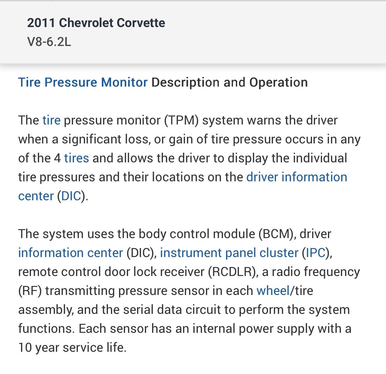

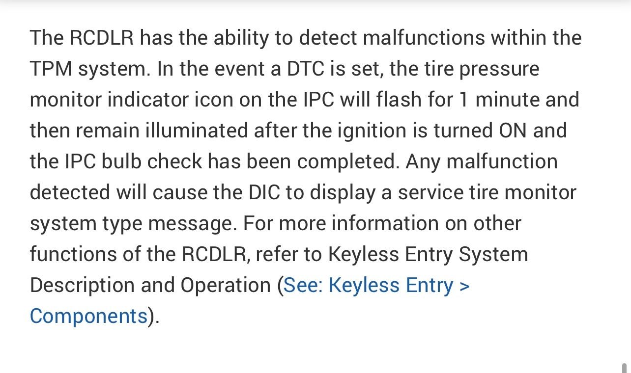

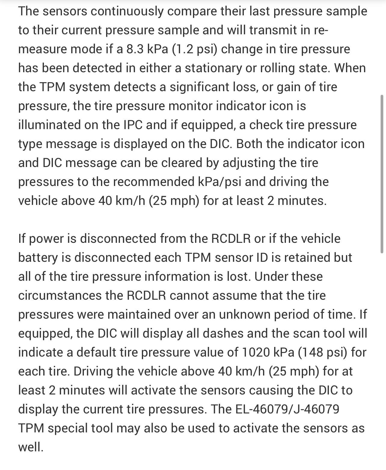

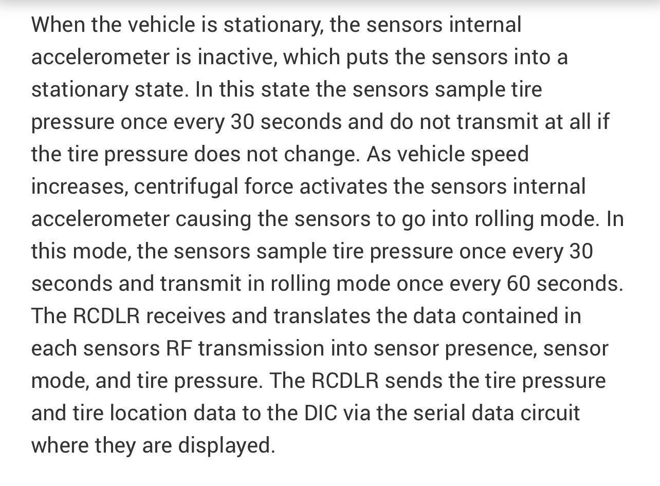

First thing it’s not a good idea to cheap out on TPMS sensors due to the added labor if they don’t work…I just ordered 4 new OEM sensors from Rock Auto when I replaced my tires recently and mine were $120.00 a piece and had no issues with the relearn…see if Rock Auto carries your sensors…also where is this “TPMS Antenna” you speak of and who replaced it ??…start out with quality sensors and go from there…how much were your sensors ??…TPMS description below.

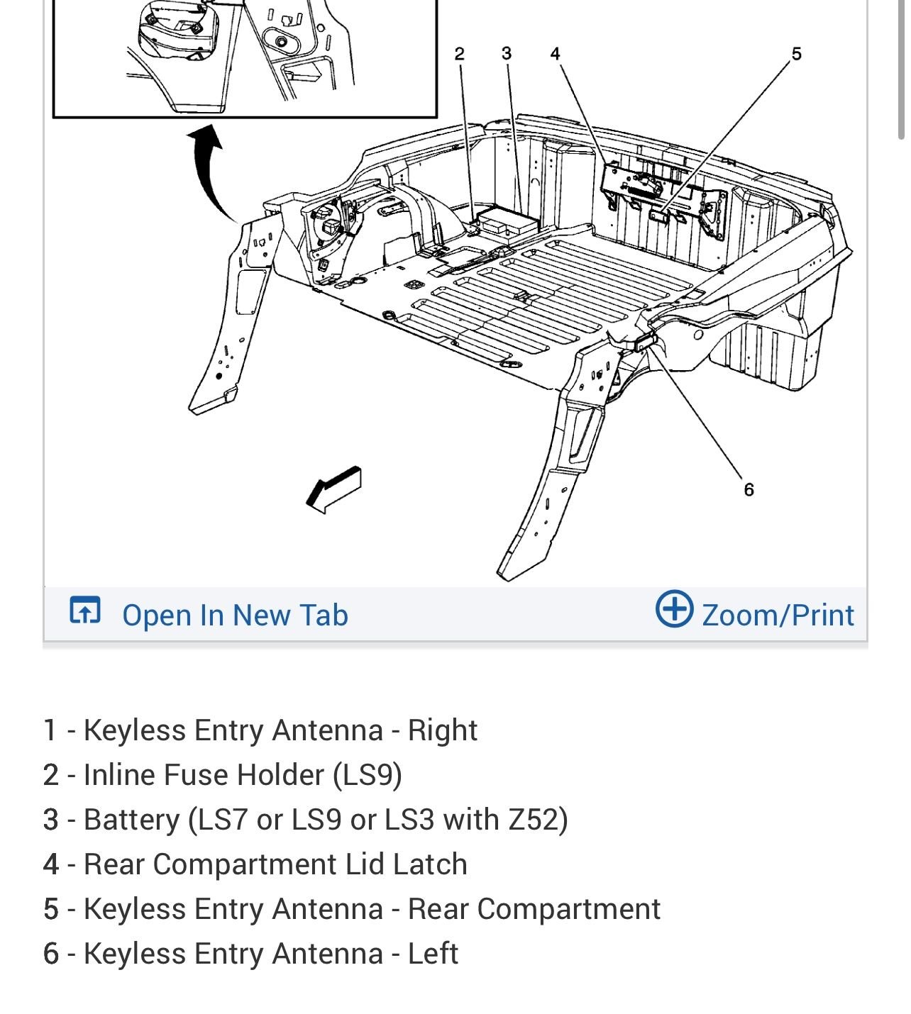

The TPMS antenna is inside the trunk, behind the carpet. My mechanic, who’s well know for his skills with Corvettes (his shop is Corvette only) replaced it.

Well sorry to say but your well known “Corvette Only” mechanic is an idiot !!…tell him to stick to oil and brake changes…there is NO TPMS antenna and that’s why I asked…the rear antenna (#5 in picture) is part of the Immobilizer system (passive entry) not TPMS…I’d get the old antenna reinstalled and get your money back…there are 4 antennas the others being the back up in the glovebox and the other 2 are in the area around each B pillar…and as far as your sensors you get what you pay for !!
