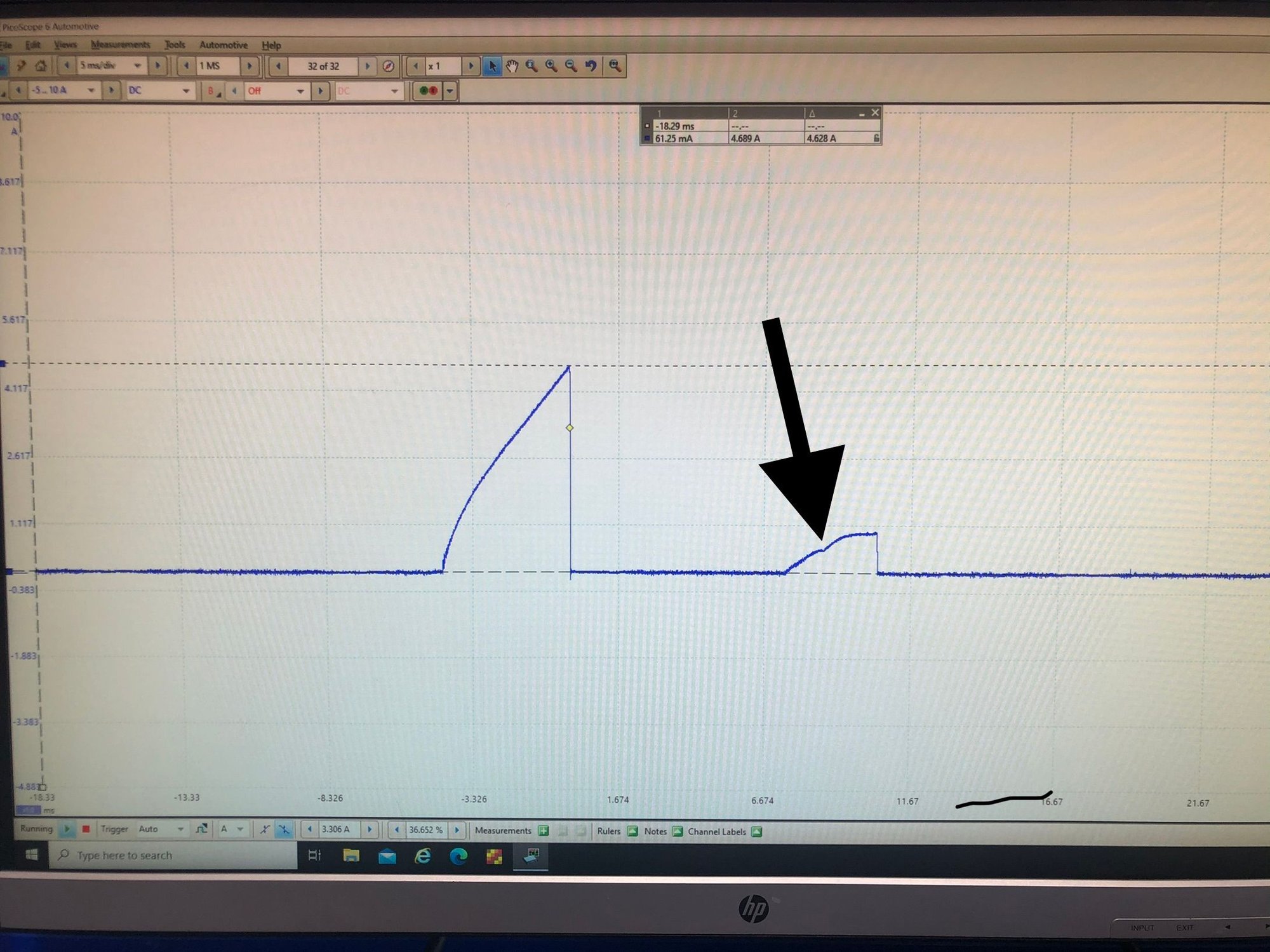

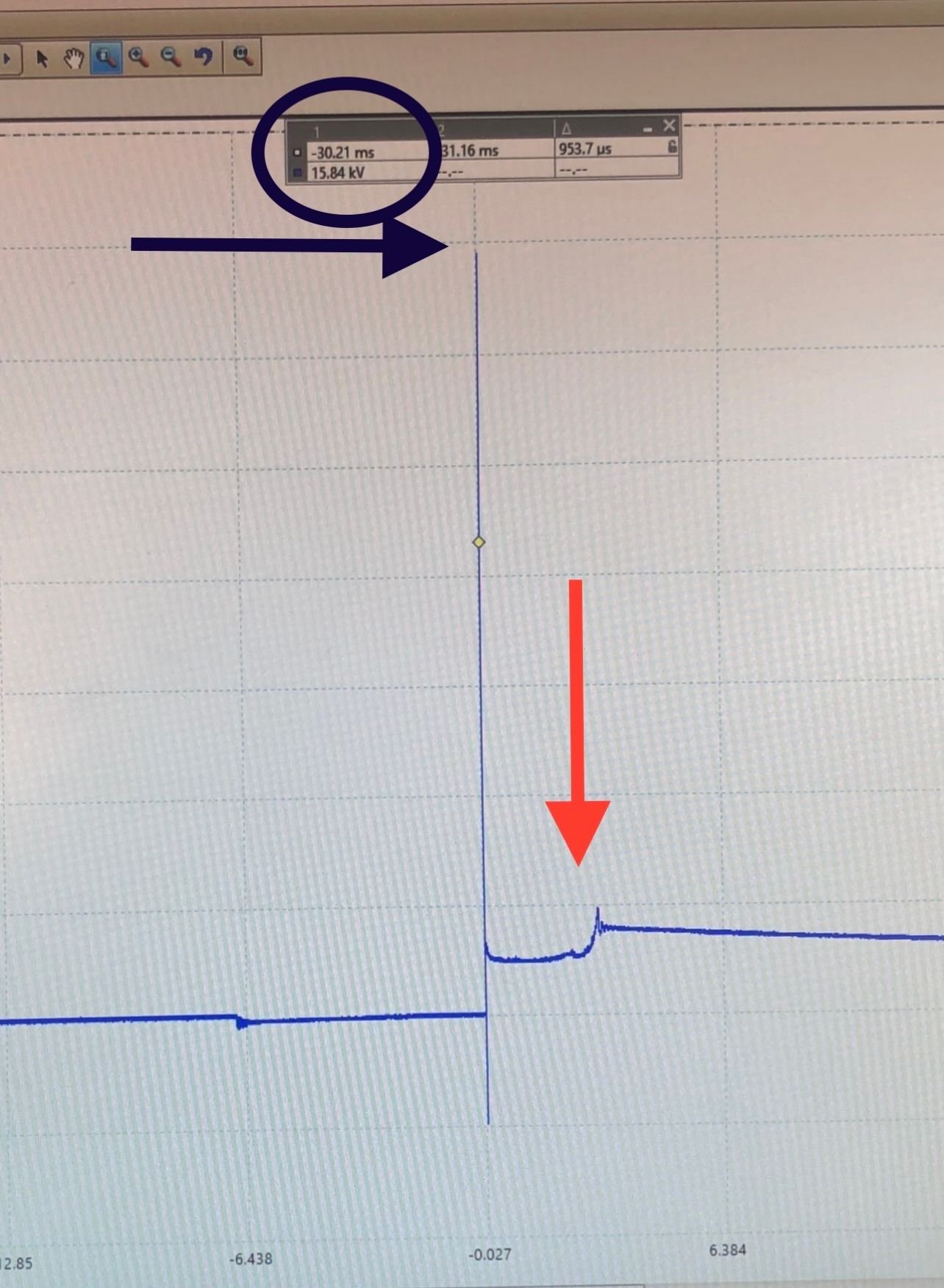

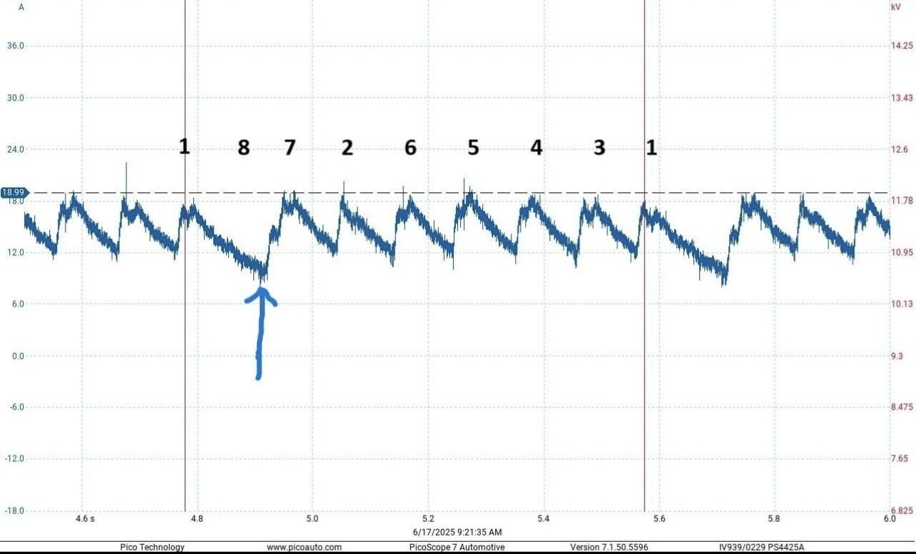

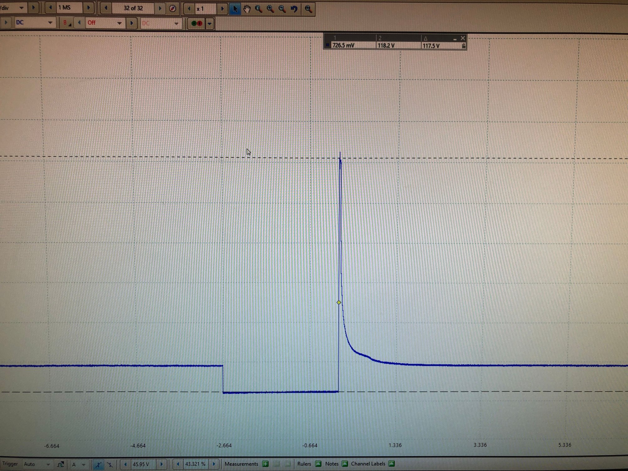

Unfortunately you really can’t diagnose a misfire with live data…unless a shop uses a labscope they will only be guessing…I use a labscope to diagnose misfires so I don’t guess…below are some waveforms I use to see where the misfire is…fuel, spark, compression…if you show these waveforms to a repair shop or even a dealership and they don’t know what these are find another shop !!..as far as your EQ or Lamda you are a little on the rich side…did those 2 idiot mechanics do a fuel injector balance test to see if your injectors are clogged or check the fuel pump under load ??..it is cheaper spending an hour for diagnostic time than changing more unneeded parts…and BTW it’s not a cam sensor.
Relative compression test…in picture no compression #8 cylinder.
Secondary Ignition
Secondary Ignition
Coil pack current on left and fuel injector current on right.
Fuel injector voltage
