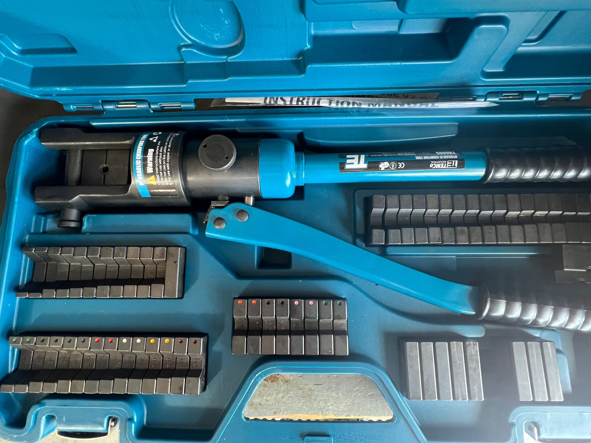

Copper lugs are cheap but a good crimper is expensive…mine is a little over $200.00…these copper terminals worked well on my ‘08.

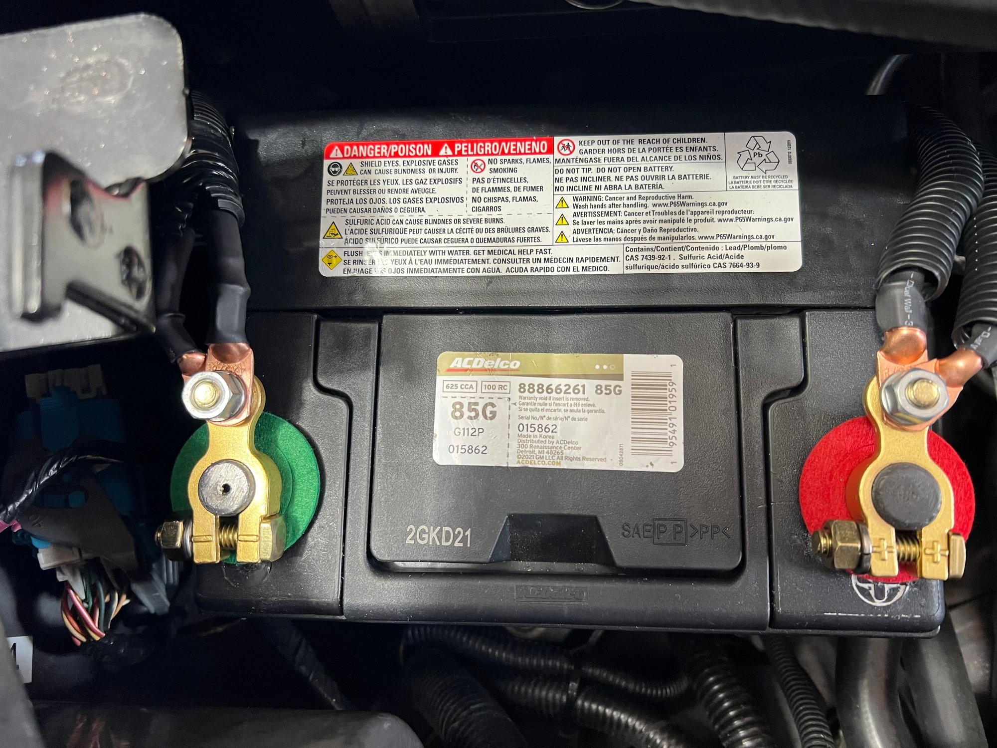

I've also seen the oem lugs break and go to a similar style as C5 Diag. I got the crimper for $70 though. Usually I look on Ebay for a vintage tool as you can get some old great quality tools for the same price as china made new ones. But got this amazon one since I needed to crimp some cable for winch use asap. What I used most recently:
Amazon Amazon
Amazon Amazon
The top post type connection is also nice for my add on electronics (sub, wide band, tender connection, etc)
