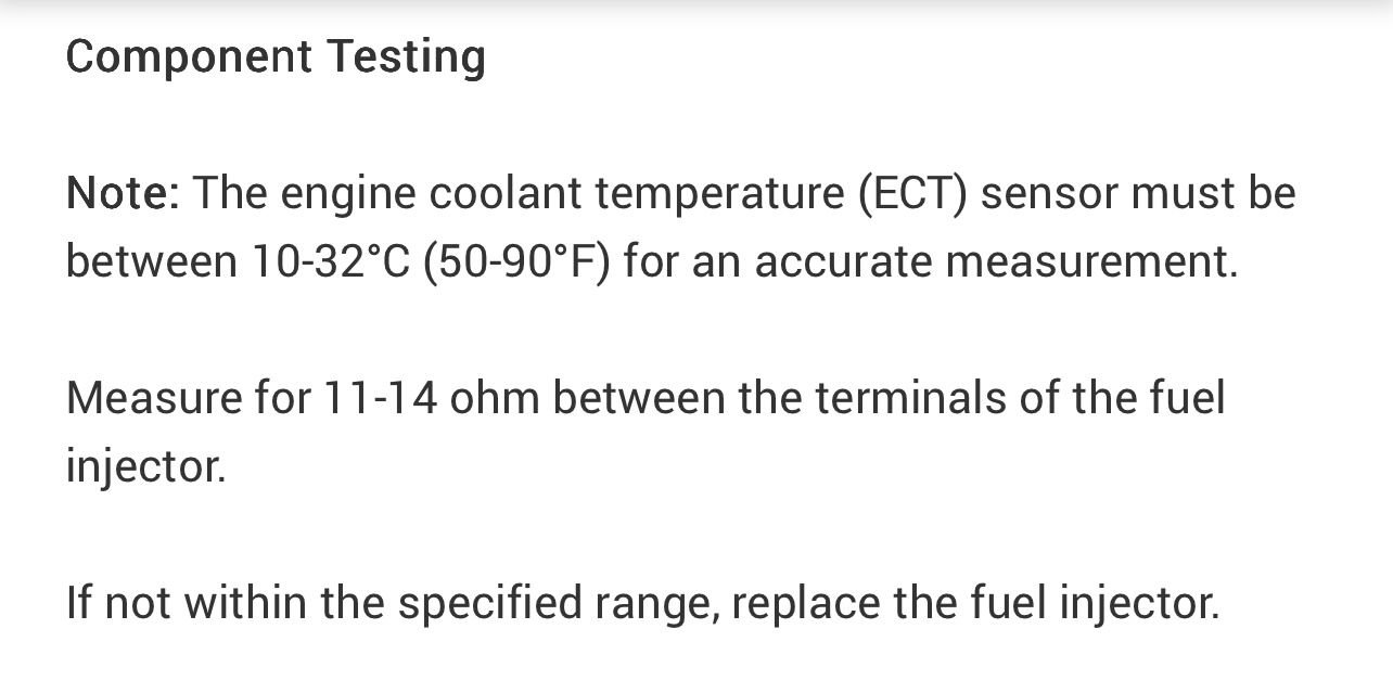

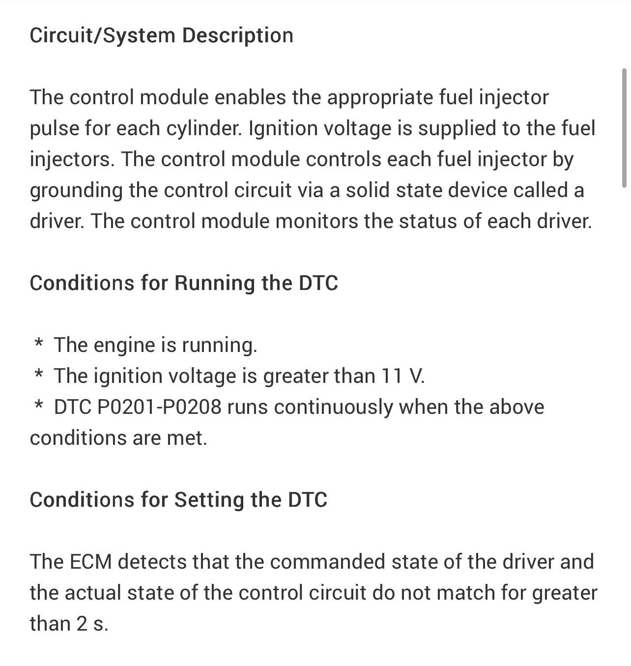

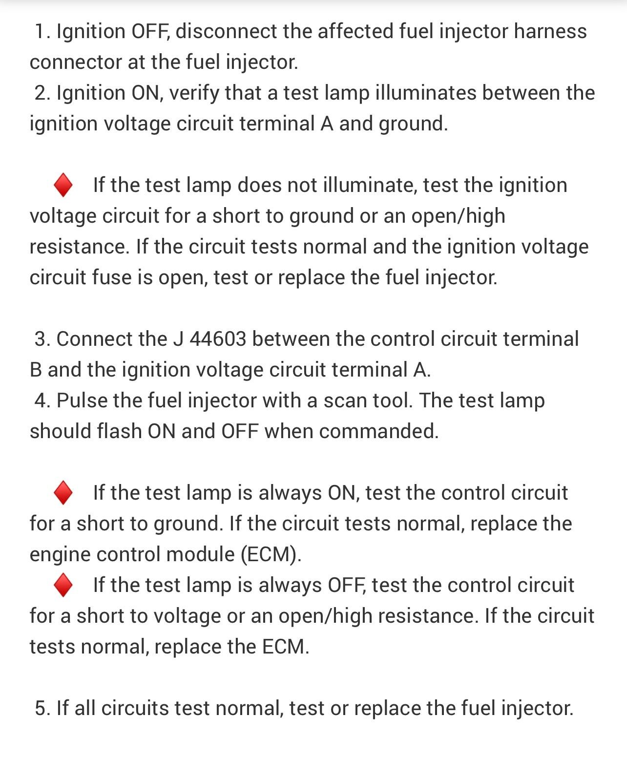

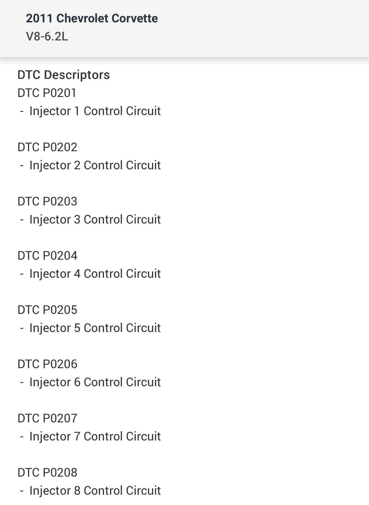

Old Sep 23, 2025 | 08:25 AM
C5 Diag's Avatar
C5 Diag
Moderator, Tech Contributor
Posts: 15,408
Likes: 3,964
From: Cape Coral, Florida
Old Sep 23, 2025 | 08:33 AM
