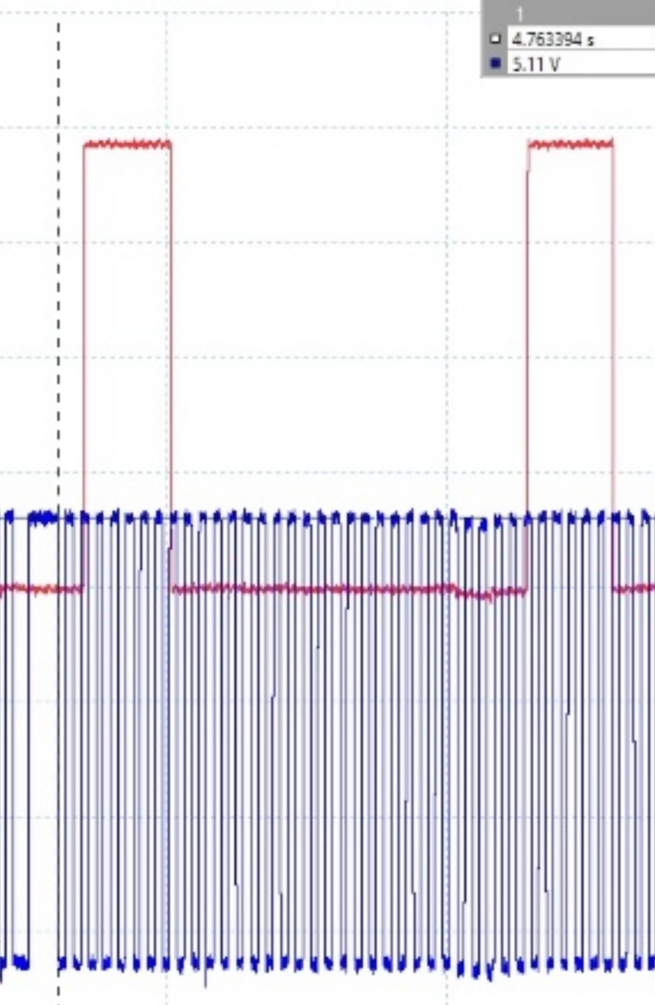

Any vibration that causes the crankshaft to slow down can cause an “ECM induced” misfire…the crankshaft position sensor is the ECM’s misfire monitor…as in the blue crankshaft position sensor waveform below on my 2008 if the time between the signal “falling edge” increases the ECM sees this as the crankshaft slowing down…there are 58 teeth on the reluctor wheel…worn torque tube couplers can also cause these random P0300 misfires…sorry but didn’t look at your video.

A torque tube would cause a P0300 random misfire and anything other than an intermittent coil “control” circuit DTC (P0351-0358) can cause a cylinder specific misfire vs (P0300-0308)…maybe a lost power on ground on the coil pack…most of the times you will see a P0300 plus a cylinder specific misfire…sometimes a random misfire can be fixed by doing a “crankshaft variation learn”…these misfires won’t be actually felt…you may just see a flashing MIL with a smooth running engine.
