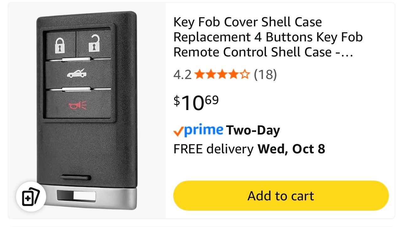

2010 GS. Case is a little loose.
Has anyone bought just a case? Is it a simple job to switch the guts.
Old Oct 6, 2025 | 08:49 AM
gdmoore01's Avatar
gdmoore01
Joined: Apr 2016
Posts: 1,286
Likes: 611
From: DFW Texas
Yes you can and transferring the electronics is easy. If you care about the fob number imprinted on the top end of your existing case, you need to purchase the right part number, as well. This is a sample Amazon link where you can purchase the replacement case & order either fob #1 or #2. This one includes the electronics, but inexpensive enough to discard and just use the case. Good luck GD

I bought 2 of these…worked fine !!
I did this to mine and after buying 3 different fobs on amazon the key fob fell off the key in a parking lot, stranding me and required a tow home, I had already intended to get a second one as it only had one. The ones I got on amazon wouldn't program so I had figured i could use the case to swap the guts but the new fobs cases were not the same size inside and the OEM guts wouldn't fit. I ended up purchasing a new OEM fob from Amazon. Swapping the guts is super easy providing the replacement case isn't cheap junk.

Ordered the one that one C5 Diag mentioned in post 3. It worked out great.
Thank you
