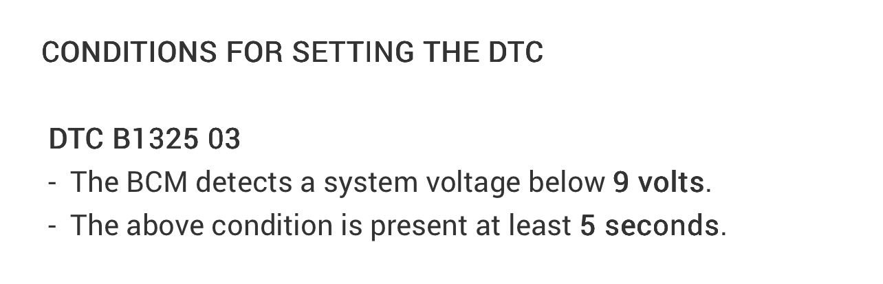

The B1325 may have set if your battery voltage may have below 9 volts due to the alternator…as far as the random misfire there can be MANY causes…you may need to check the alternator connector if your new alternator is not charging properly.
