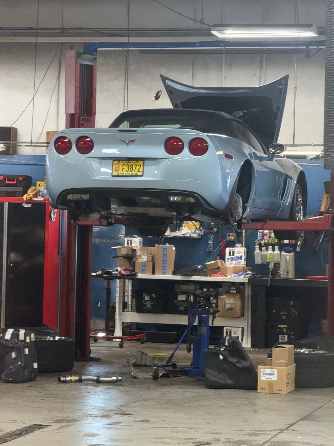

I thought it was funny in your earlier pictures that they didn’t drop the rear end. I figured they were trying to save on time since it was warranty work and not a cash job. Huge difference in billable labor between dropping the rear end and just dropping the tanks!! LOL!! Hopefully they get your car back to you soon.

******* dealerships.
They should have dropped the drive train out first thing.

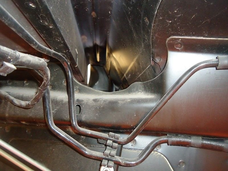

tanks, crossover, and evap tube can not be removed as an assembly. crossover goes through an opening in each frame rail.

My deepest sympathies. When I looked out into the dealer’s shop and saw everything on the floor, I was in shock. Then when I saw the service department invoice today, when I picked it up, that was a bigger shock! Good thing I bought the warranty!!! I’ll post it here.

great reply. Also the internal tank lines have to be unclipped at the xover connection to remove pump assembly from the tank. Too hard otherwise.
