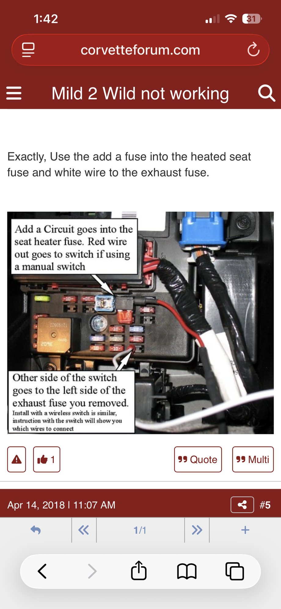

Nov 27, 2025 | 01:28 PM
Well now I’m really confused. I replaced the solenoid and the Mild to Wild still wasn’t working… I took out the mild to wild unit and just put a fuse back in and the mufflers are working as they should. So it’s looking like maybe my mild to wild unit is defective, I don’t know of any way to test that though. I guess I’ll send it back and try another one.
Reply 0
Nov 27, 2025 | 03:41 PM
Quote: Well now I’m really confused. I replaced the solenoid and the Mild to Wild still wasn’t working… I took out the mild to wild unit and just put a fuse back in and the mufflers are working as they should. So it’s looking like maybe my mild to wild unit is defective, I don’t know of any way to test that though. I guess I’ll send it back and try another one.
Ur killling me man. Im already stressed with ur other situation.
Reply 0
Nov 27, 2025 | 03:55 PM
Quote: Ur killling me man. Im already stressed with ur other situation.
ah this isn’t nearly as concerning but still something that isn’t working right. I swear every car I buy has so many issues. I came across an alternate way to connect the mild 2 wild so gonna give this a try later
Reply 0
Nov 27, 2025 | 04:50 PM
The add-a-circuit that’s attached to the wiring harness of the M2W unit has a fuse. Did you test that one? If it’s blown, the exhaust control module will never get power, so neither will the solenoid. It’ll be open all the time. Should have been the first thing you checked. And the add-a-circuit that plugs into the EXHMDL fuse location has to be oriented correctly. If you plug it in rotated180°, then it won’t work either.
