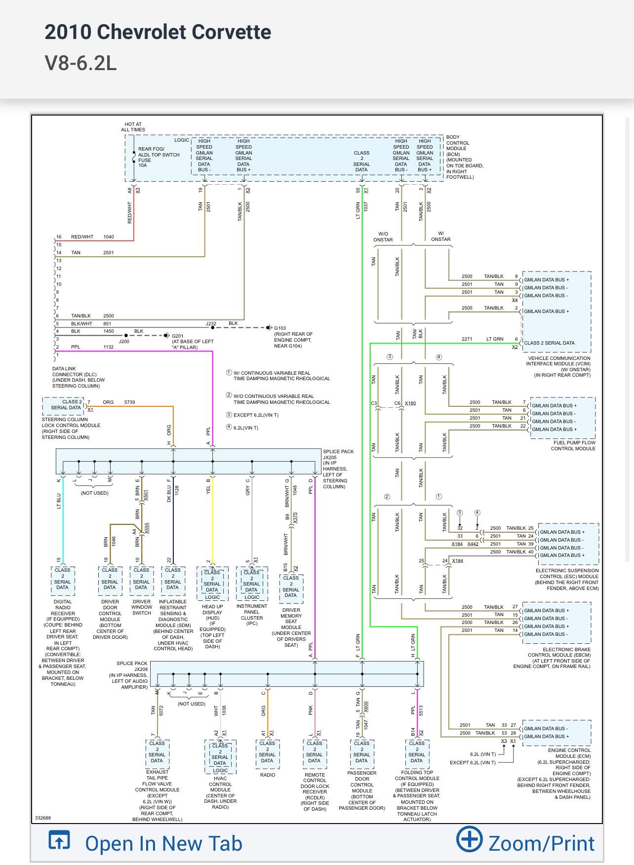

If you can’t get ANY module to communicate their is an issue on the high or low speed CAN bus…VERY few shops and even dealerships don’t know how to diagnose this…you do NOT need to change all the modules and if they told you that you can tell them I said they should close up shop and sell hot dogs !!…they’re idiots…another post on the Forum where mechanics have no clue how to diagnose a car…if you have a DMM and know how to use it there are a few measurements we can try…if not an auto electric shop is where you should take the car…these communication issues can cause the car not to start if the ECM, BCM, and RCDLR can’t talk to one another.

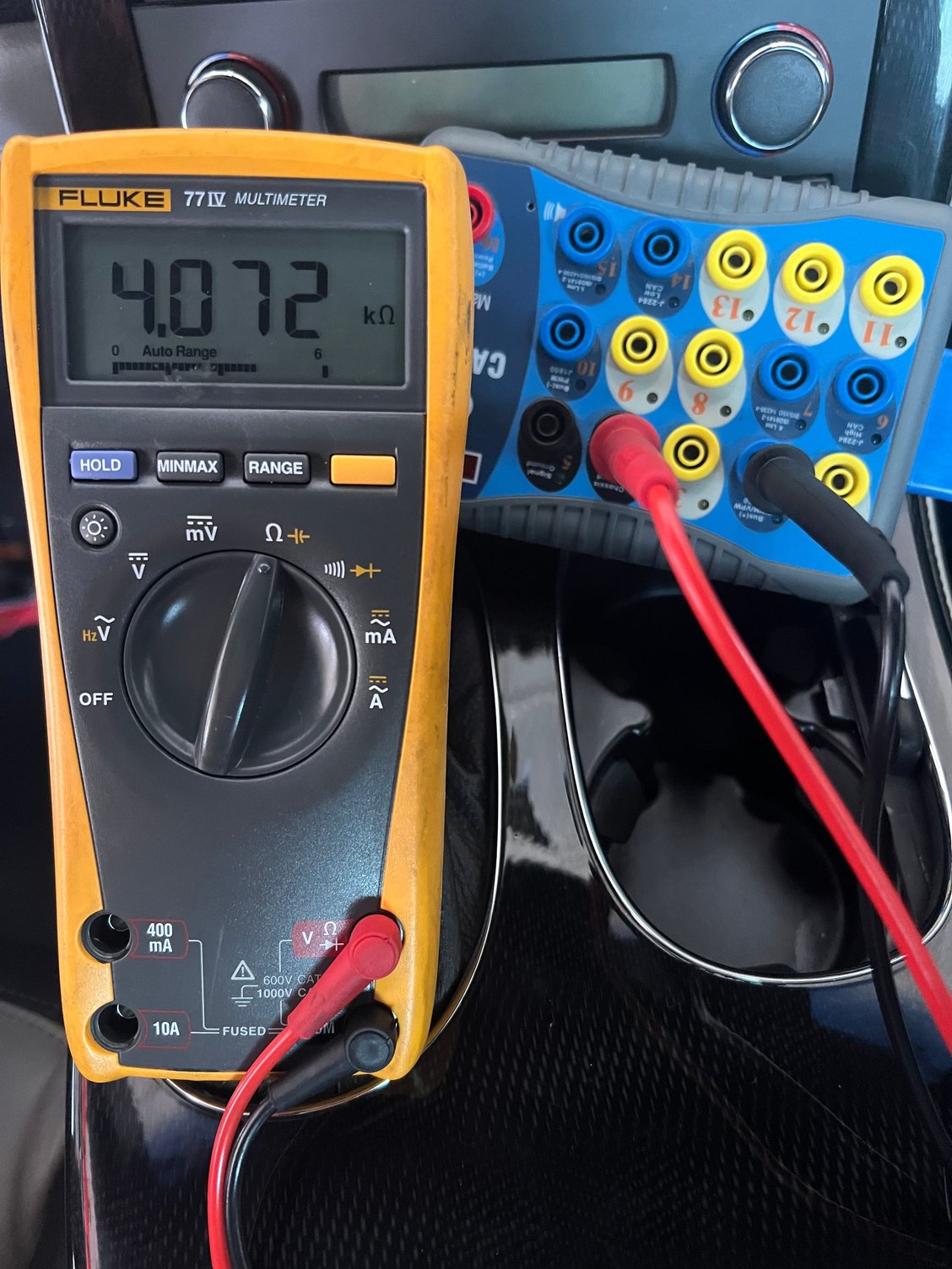

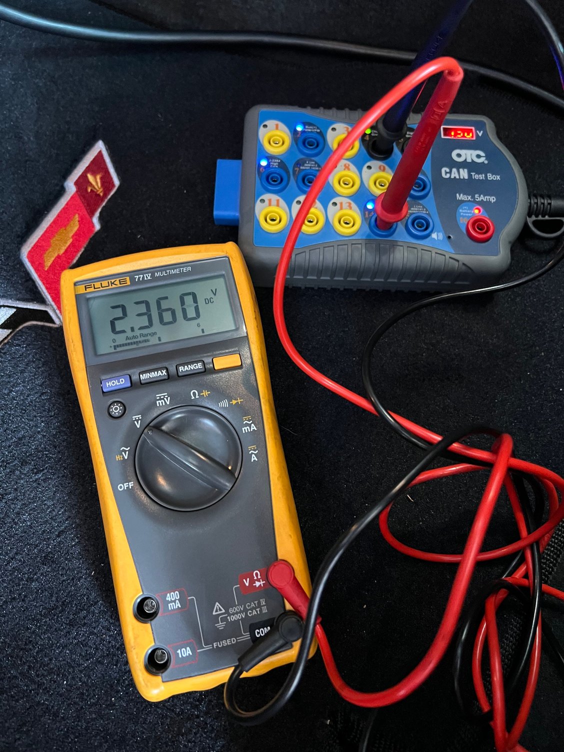

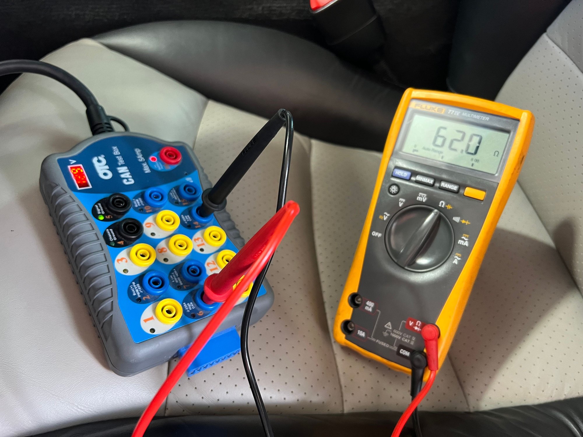

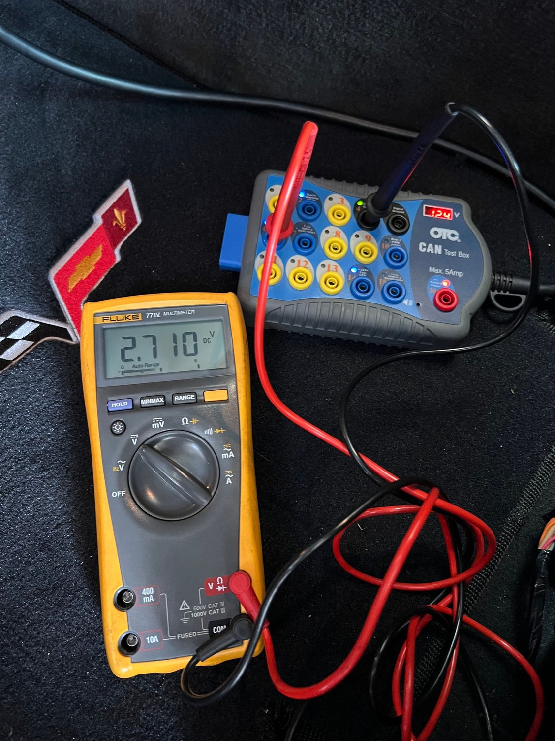

Basically there are a few resistance and voltage readings to be taken at the DLC where you plug a scan tool into…going between terminals 6 and 14 with the battery disconnected we expect to see approximately 60 ohms…with a voltmeter with battery reconnected we expect to see approximately 2.5 volts on pin 6 and again on 14…there are resistance reading to also be taken at 6 and again at terminal 14…the low speed bus we expect to see approximately 4 thousand ohms…an auto electric shop will normally be called Joes “Auto Electric” shop.
