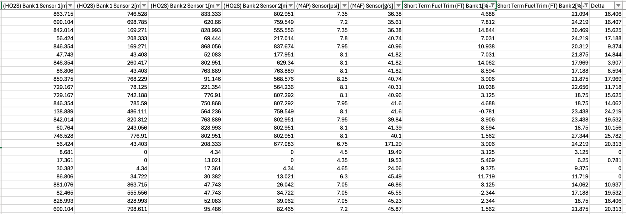

If you are seeing a big imbalance between banks it would NOT be something like a MAF sensor or a intake vacuum leak which will affect BOTH banks…this could be something like a bank specific intake runner vacuum leak or bad injectors on that bank…maybe even a clogged cat…can’t read your file so can’t comment…BTW, a misfiring cylinder will cause a lean condition and not a rich one.

No cats on the car. Below is a table with a quick snap shot of the short term fuel trims - highway cruising.

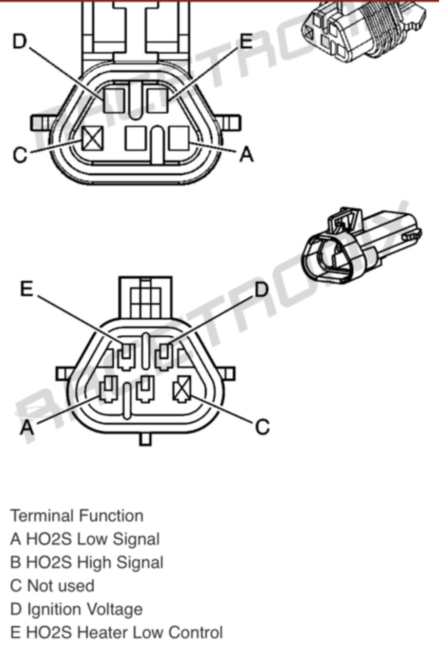

02 Sensor Readings were 12v between D & E 8v between B & D and .2v between A & E

All GM narrow band O2's will read a bias voltage of 450Mv's with key ON for all 4 O2 sensors...is that what you see ??...also just a snapshot of short terms is basically useless info...one must look at other live data PIDS to see actually what's going on.
