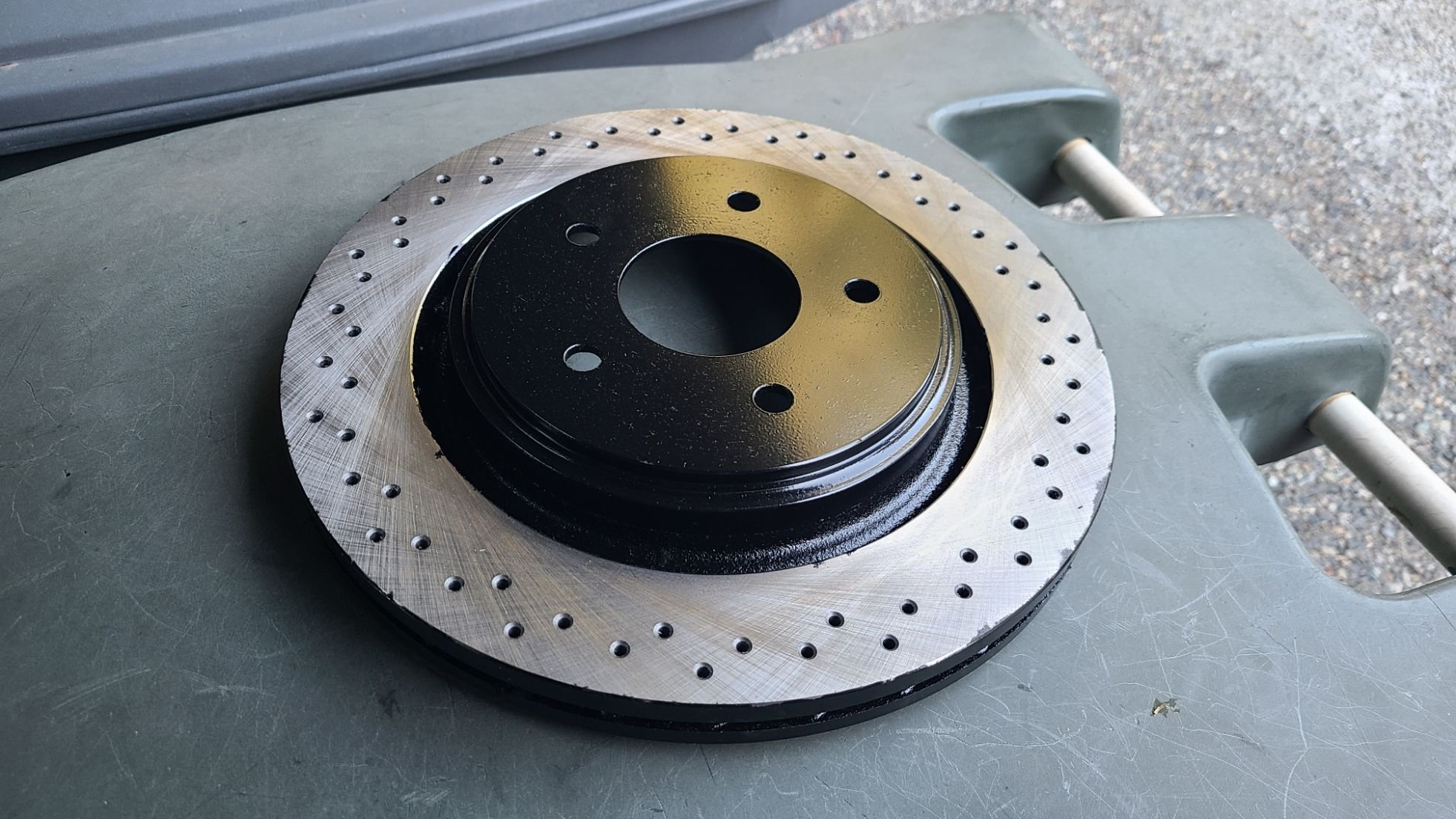

On both my C6s, I took the rotors off, masked the pad contact areas/faces and used VHT high temp black paint on the hat areas. I don't track my car so they still look great and easy to clean.

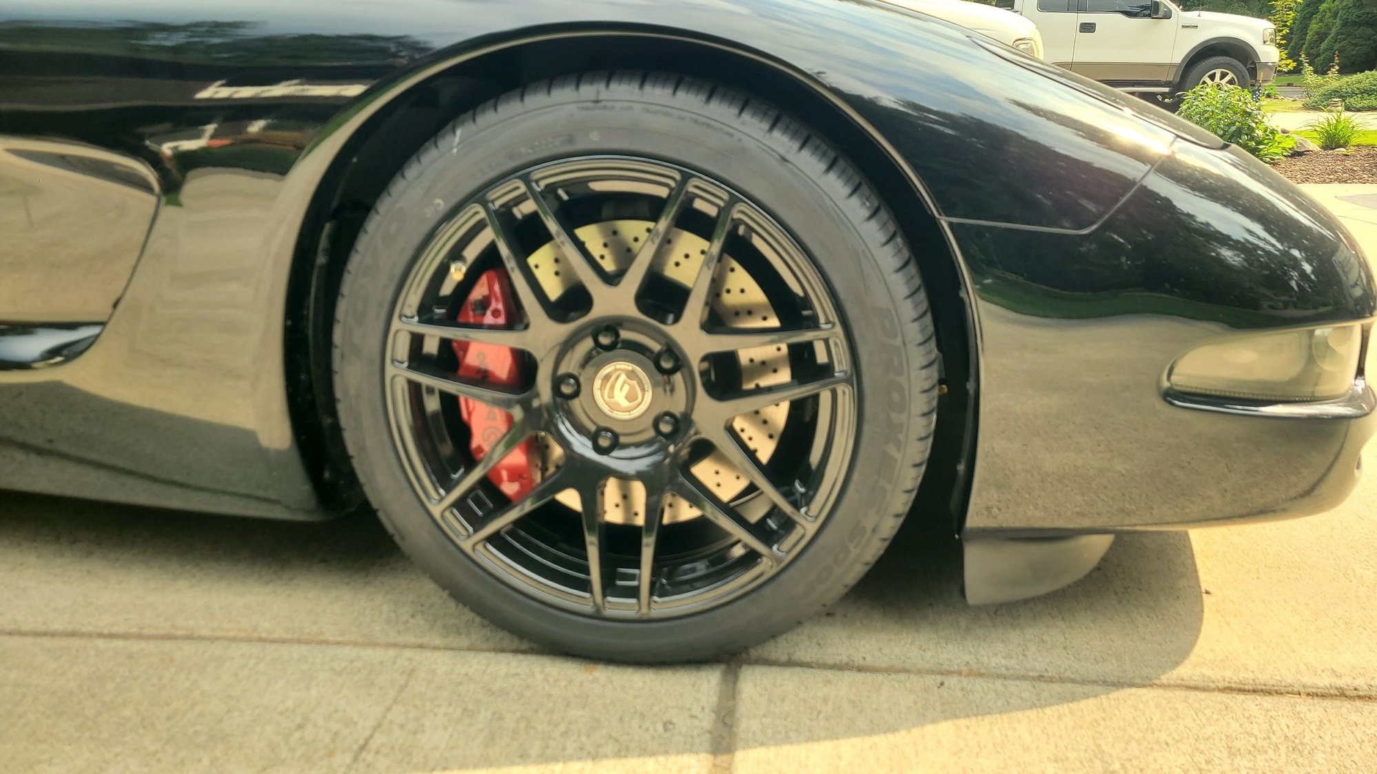

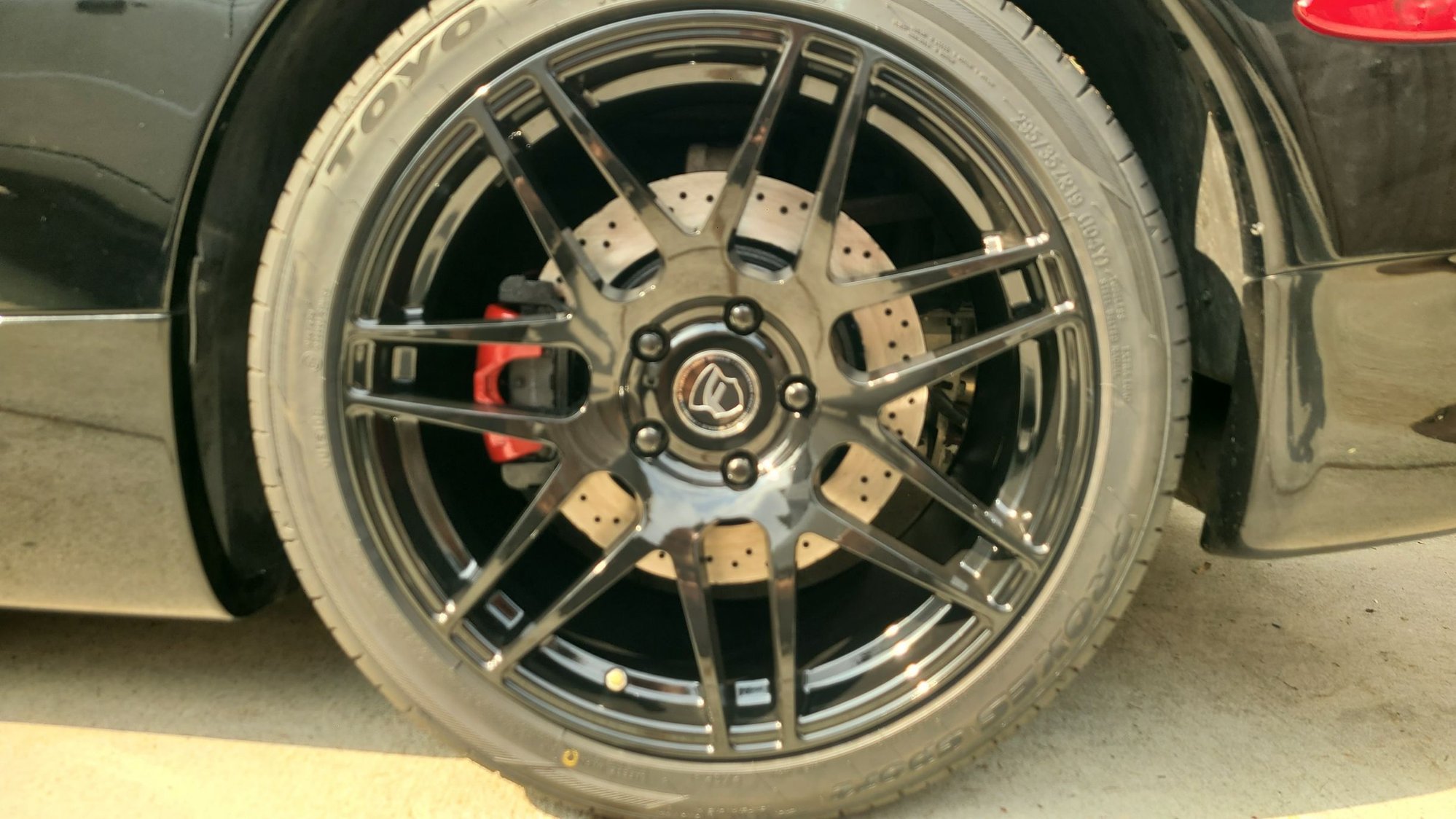

Dumb old Rustoleum on my brake hats.
I also sprayed the vanes too thinking we'll that'll never last lol. It's still on there.

Yeah this. I just used VHT high temp on mine. Looks great like these
