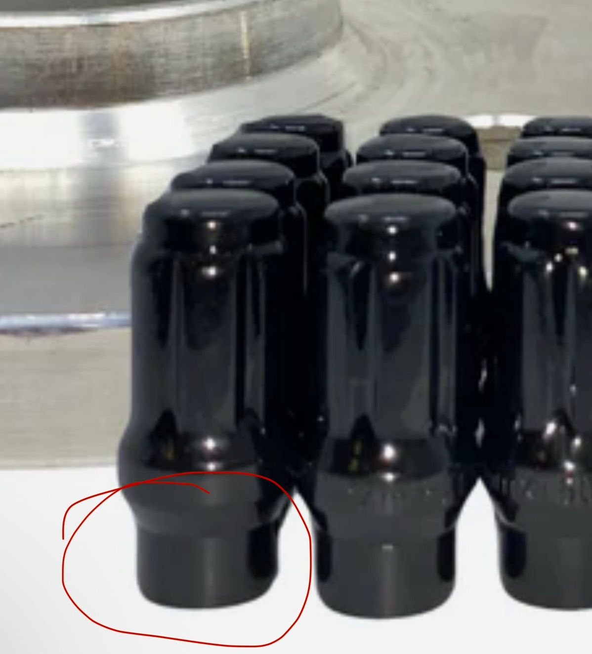

Thanks to everyone that shared their thoughts and ideas. I reached put via email with pictures to broken tap and still waiting for their response,
for visual reference this is what the lug nut looks like whole. This is a stock photo so the one i used; bottom half is a bit longer. When I get a chance ill take an actual shot of what Im using

Judging from the photos of the stock lug nut and what's left of the lug nut in your hand, it appears that it's just the threaded section beneath the lug nut flange that's left on the stud. You may be able to remove the remaining lug nuts and pop the wheel off. The section of that nut that holds the wheel on is already in your hand. Good luck.

great observation! it does look like whats still left on the stud is flanged or tapered and pressed against the surface of the wheel (hope that made sense) only one way to find out I guess. 🥴
