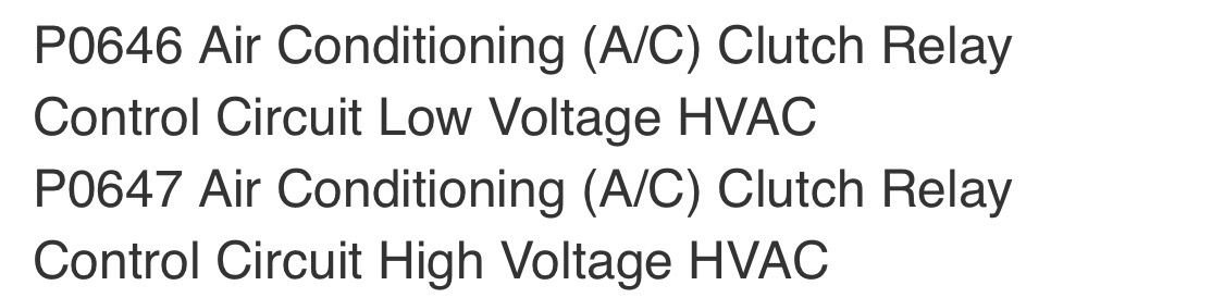

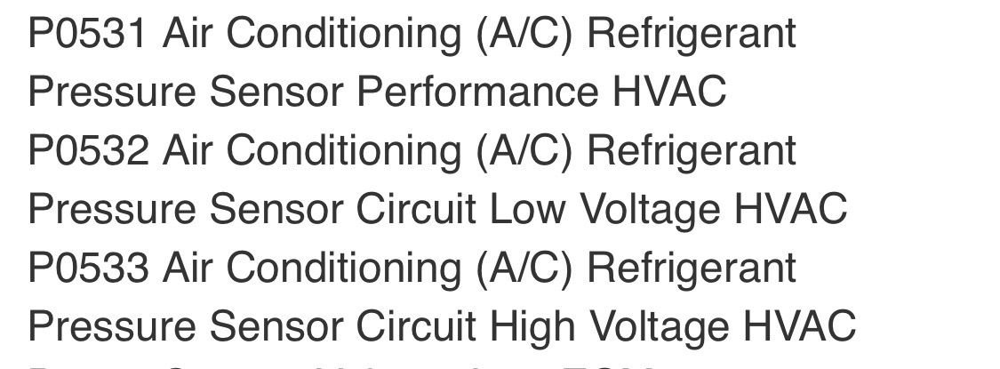

Will I get a CEL in gauge cluster if I remove my AC system?

The only DTC's that will illuminate the MIL are any that will affect the cars emissions...there are a few DTC's below that may set a DTC but not illuminate the MIL.
