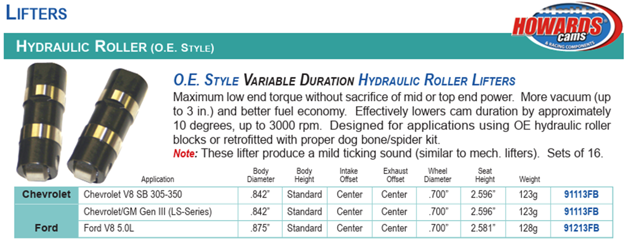

2. Howards Cams OE-Style Performance Hydraulic Roller Lifters 91113FB - https://www.summitracing.com/parts/HRS-91113FB
3. "Caddy Race Lifters" 88958689 - https://www.summitracing.com/parts/nal-88958689
Has anyone used Howards 91113FB hydraulic lifters? They say they're for Gen III and are 0.06" shorter than the OEM ones, so my question is, will they fit my Gen IV LS3? I wrote to Howards support about this, but they haven't responded after a week, so I'm turning to the forum for help.

The Howards look to be a knock off of Rhoads lifters. I used them in an engine a long time ago. Had a pretty rad cam. The lifters reduced the cam lift at idle and pumped up to give you full lift once it got to ~ 3,000 RPM. I had to use 20-50 oil to get them to fully actuate.
Rhoads Original Hydraulic Flat Tappet Lifters
Rhoads Original hydraulic flat tappet variable duration lifters are famous for increasing low-end torque, engine vacuum, and idle quality on engines equipped with performance hydraulic cams, while maintaining maximum top-end power. Better fuel economy and improved emissions quality are often reported by customers with Rhoads lifters. The unique construction of Rhoads Original hydraulic lifters reduces lift and duration at idle by approximately .010 in. to .020 in. Duration is reduced by approximately 10 to 15 degrees. Total lift and duration are restored at approximately 3,500 rpm. Original Rhoads lifters are also anti-pump-up for higher rpm revs. Typical vacuum increases range between 1 and 3 in. Rhoads lifters can be used with either adjustable or non-adjustable valvetrains. Original Rhoads lifters, with their legendary "ticking" at idle, sound similar to solid lifters. These Rhoads Original series lifters are designed for use with high performance street, marine, or racing applications.
