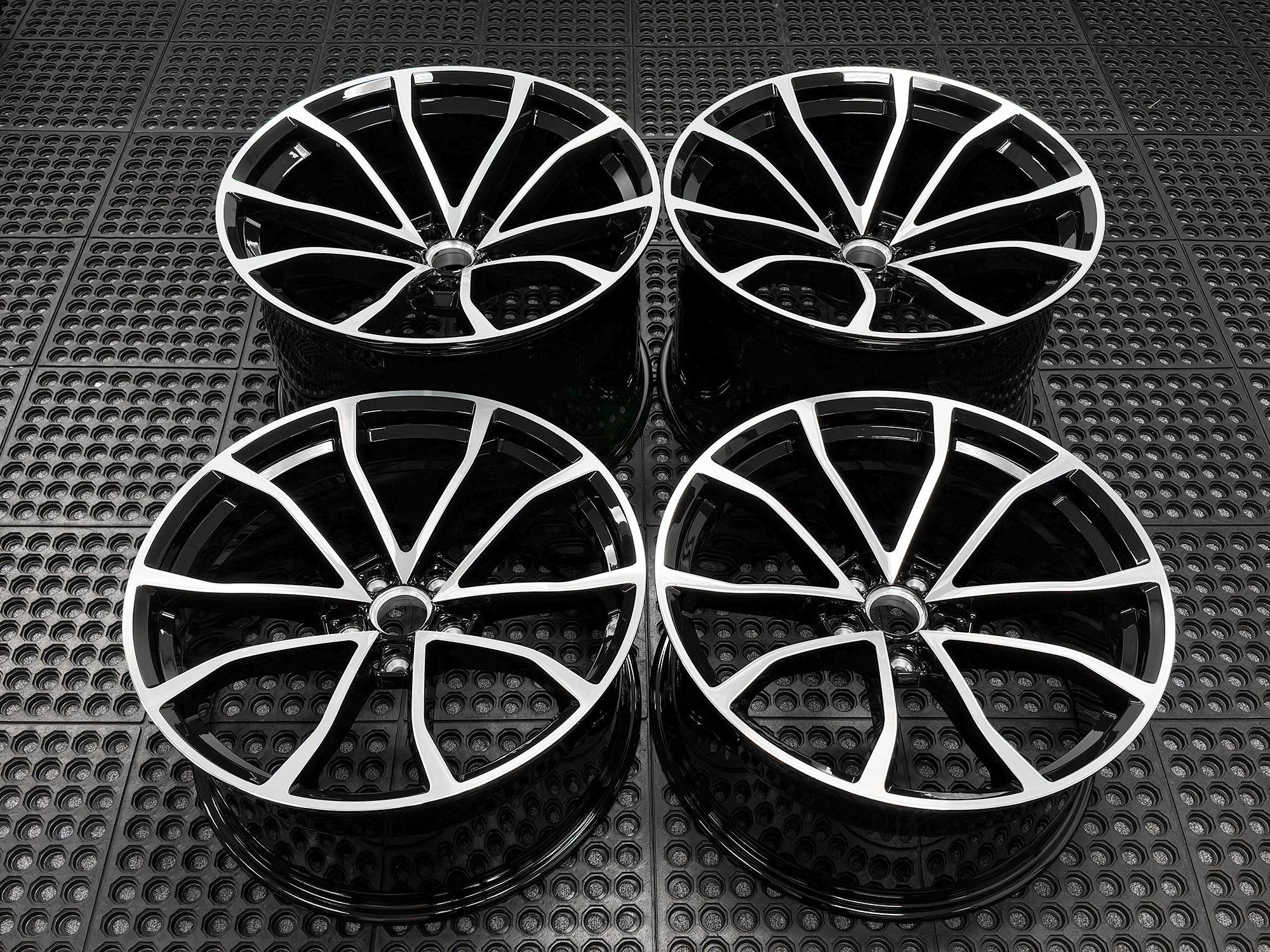

Here is link of some good options from Winn Dynamics Forged (WD Forged) well established company since 2017 that has been producing OE Style Forged wheels for the Corvette Fourm without any issues.
These are made in the USA and start at $4k a set of 4 wheels for Corvette Forum members right now.
https://wheeldesigners.com/collectio...2728=WD+FORGED

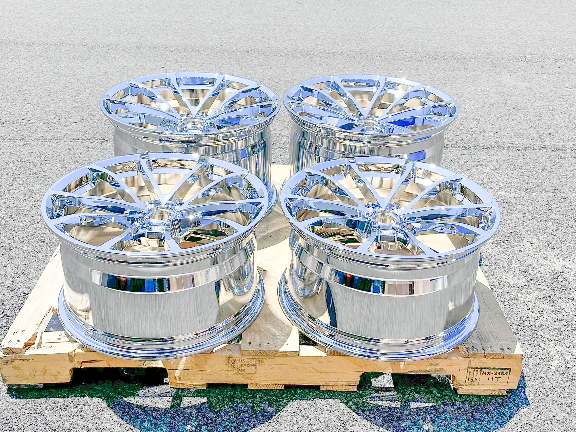

I do have a set of the GS01 in Triple Chrome in stock 19x10+43 20x12+59 OE specs to use eveyrhting OEM also.
Let me know if you have any questions.

They are some beautiful wheels!
