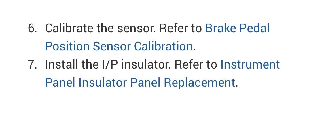

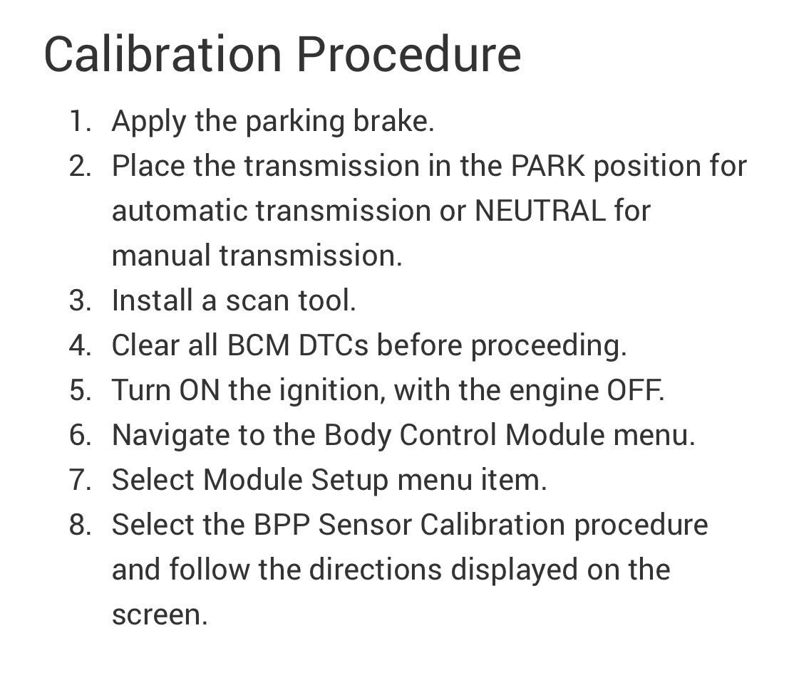

It is not really a brake "switch" but a sensor...did you perform a sensor "calibration" ??...you need to use factory service information...you will need a factory level scan tool to do this.

It's a Tech 2 and there are aftermarket scan tools like Autel or Launch that will do this...any automotive shop can do this do ask them and see what they would charge...will be less than buying a scan tool.
