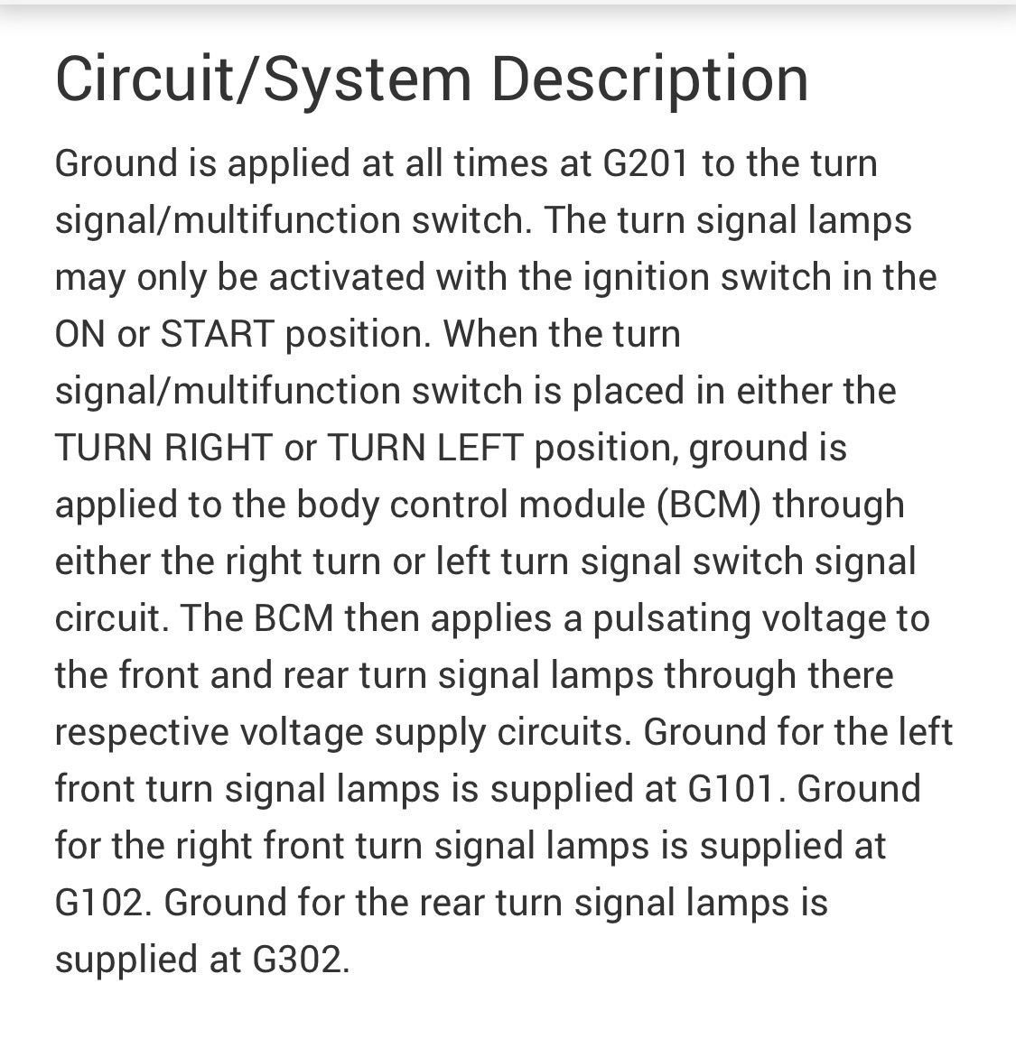

Hey, so I'm really not sure what else to look for here, My Front driver side blinker is not blinking, amber would turn on in DRL but it will not work with hazards, blinking or flashing when I lock the car. I've replace the bulb, and also replaced the headlights in total which replaced the harness with all the plugs, and still I have nothing on the front driver's side. Any help is appreciated thank you.

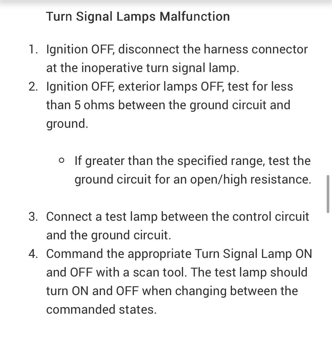

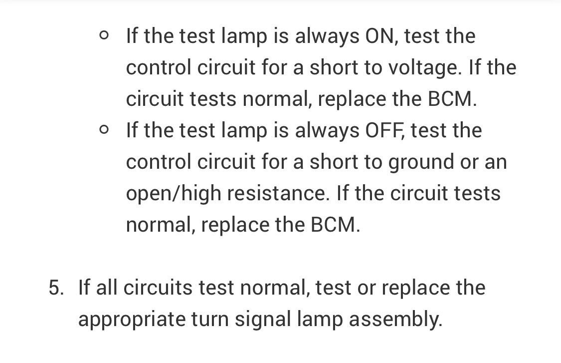

First one must know how the circuit operates and then you must follow a data driven diagnostic approach...a description and a testing method below...if this is over your head seek out an auto electric shop in your area.
