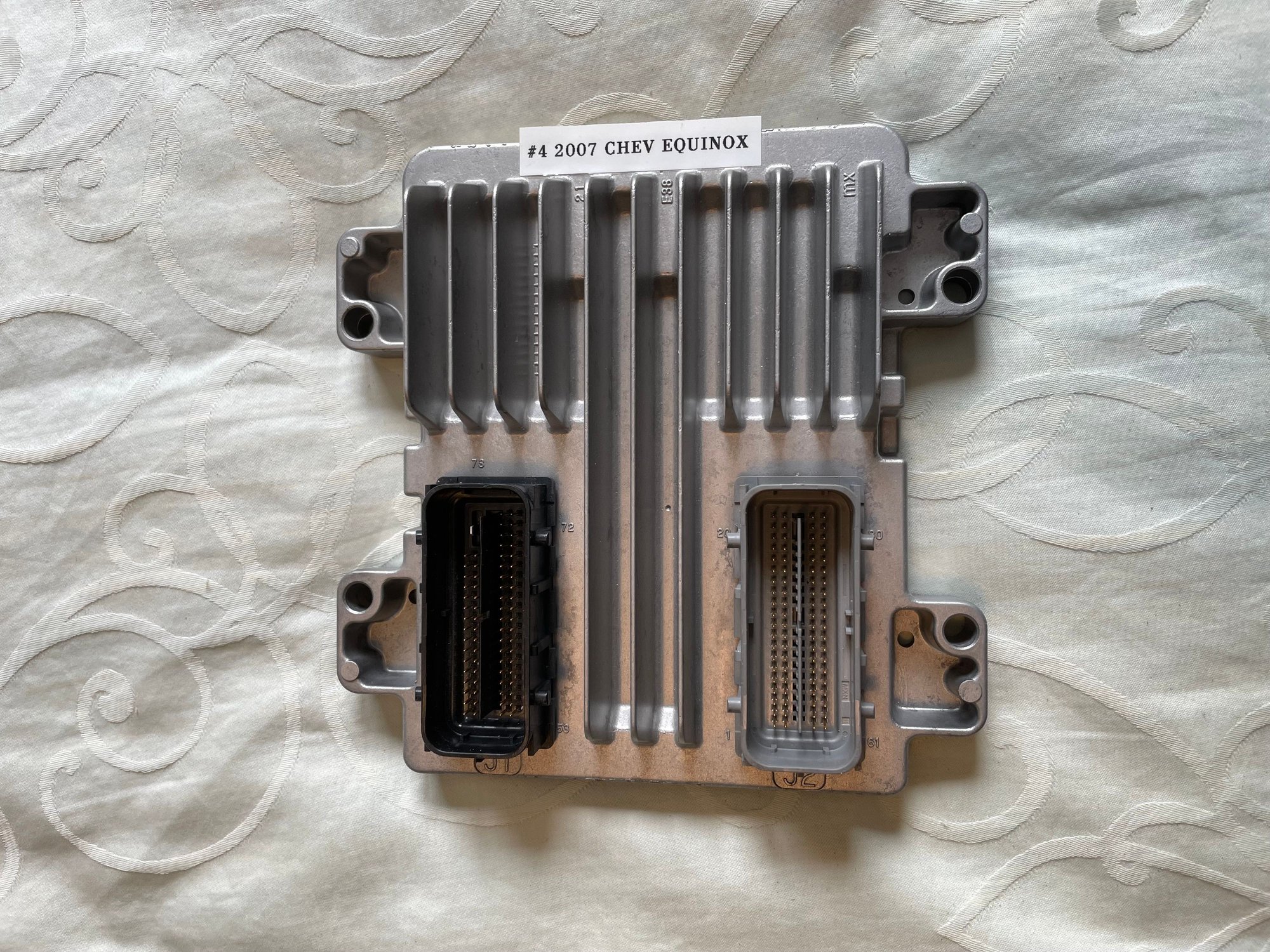

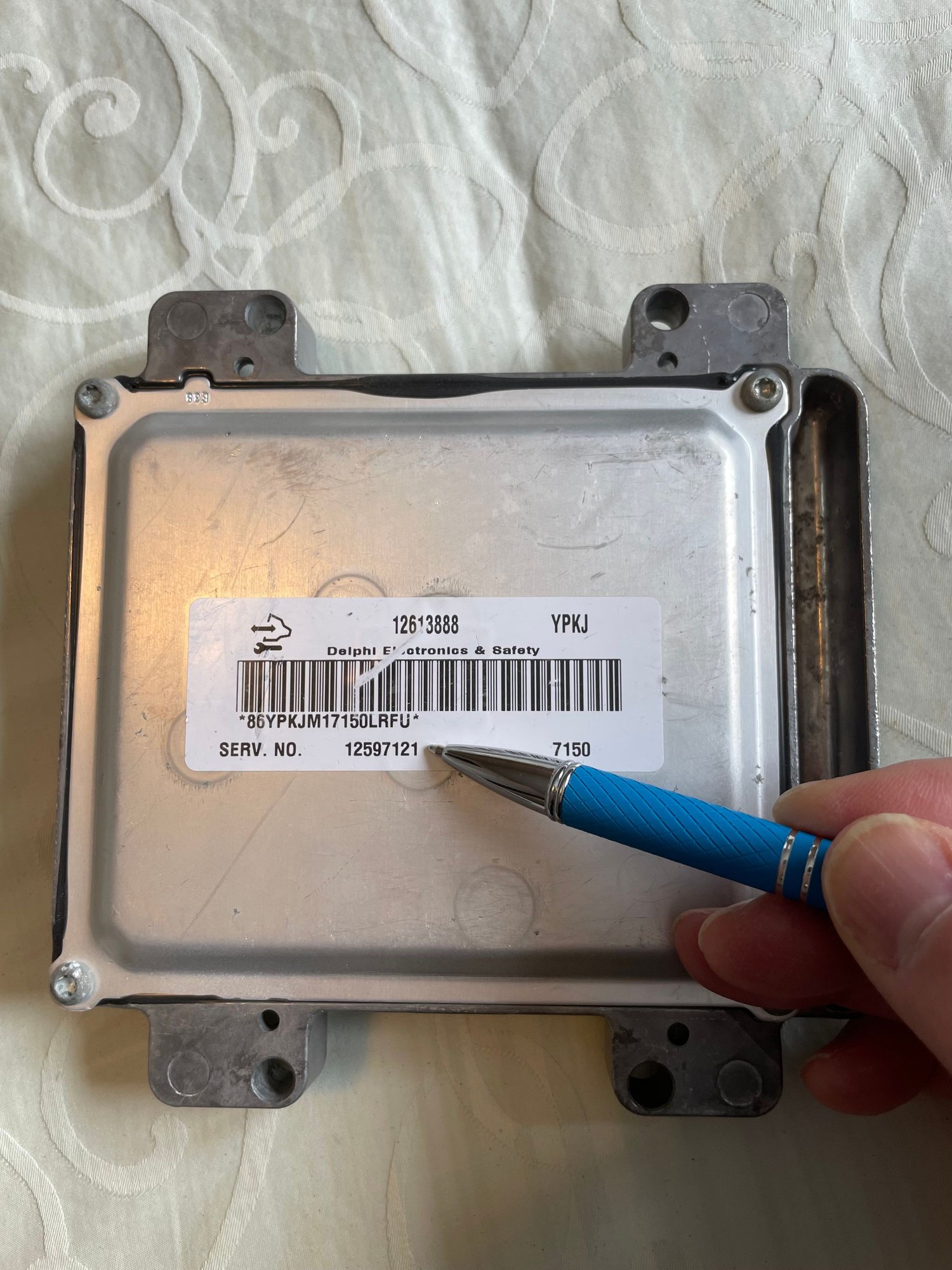

All 06 and 07 C6 Corvettes use the E38 ECM #12597121. The first picture shows my pen pointing to this service number. This is the back of the ECM. Second picture shows the front side. These ECMs were used extensively in 06 and 07 GM vehicles. They are easy to find at a wrecking yard. Expect to pay about $50 or so.
The only problem is they are currently loaded with the software from the original vehicle. Once you purchase one ....you'll have to somehow find someone to upload the C6 Corvette software to it. They will use your VIN number to upload the correct software. GM charges about $45 for access to this software then who ever does it for you will also charge their own fee. You can find people that offer this service locally on Facebook market place. If you have your own J2534 tool you can do it yourself.
You can see in the second picture I pulled this one from a 2007 Chevrolet Equinox.
You can also buy these ECMs on E Bay for about $149 pre programmed to your vin.
