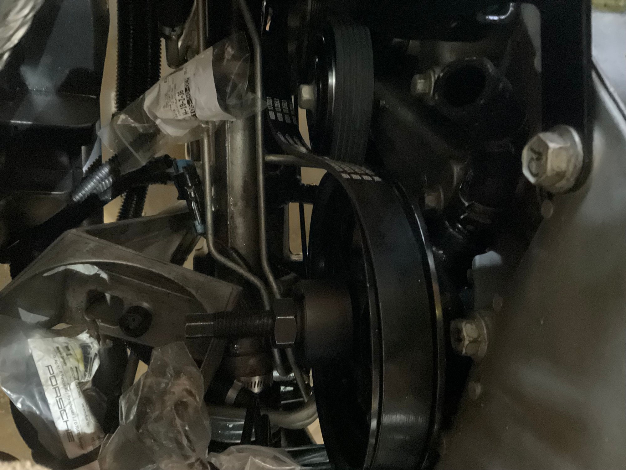

Everything I read and watched said this job is a major PIA. I struggled for many hours before I finally figured out the easy way which I believe is also the method in the factory manual. The easy way to do this job is to just pull the brake module in front of the power steering pump. Once the brake module is out of the way you employ your trusty HF pulley puller to remove the power steering pump pulley. Then you have easy access to the high pressure hose connection and the pump attach bolts.

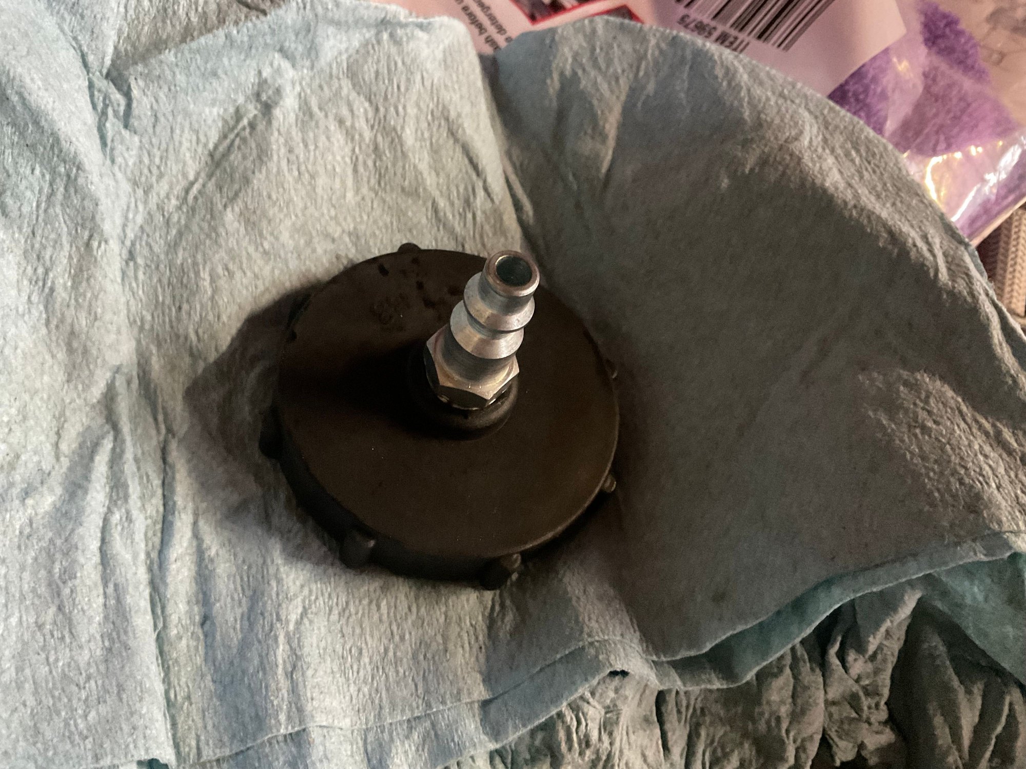

Now you need to bleed the brakes and the brake module. I used my Chinese Tech 2 for this and a pressure adapter for the brake reservoir which lets you just hook an air compressor to the reservoir and pressurize it for bleeding. 20 psi, not full pressure! The Tech 2 walks you through the bleed process to bleed the module and the brakes. Worked great, just refill the brake fluid after each wheel.

Easy to pull the pulley now.

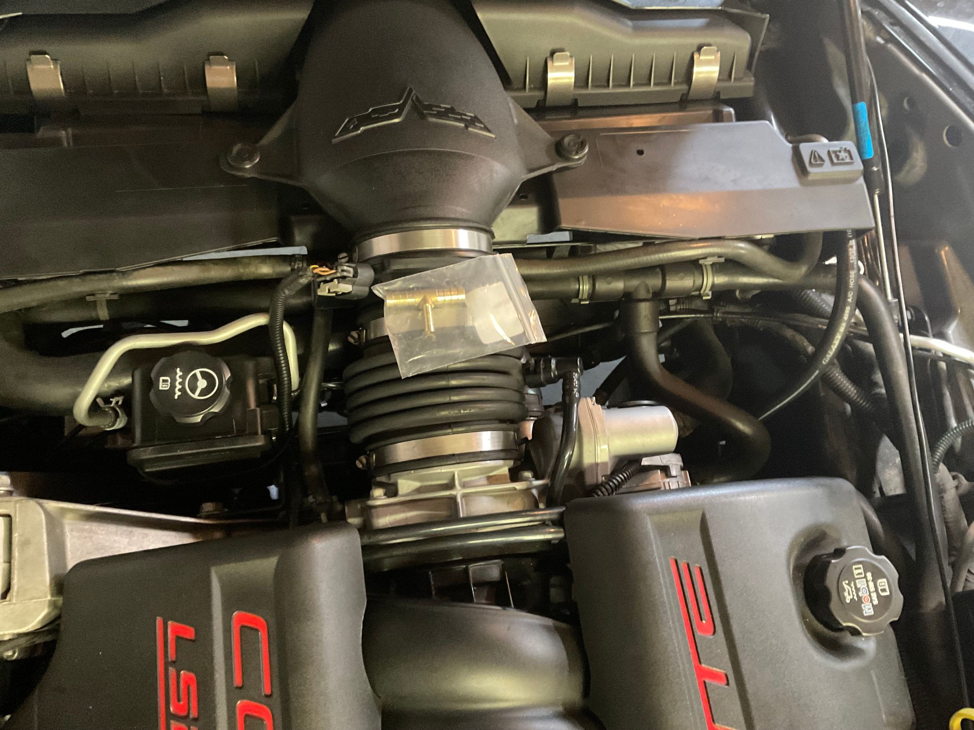

I also replaced the plastic T on the coolant lines under the MAF here since the plastic one broke.  They’re all going to break.   I used a brass one from Amazon.  3/8x3/8x1/4
