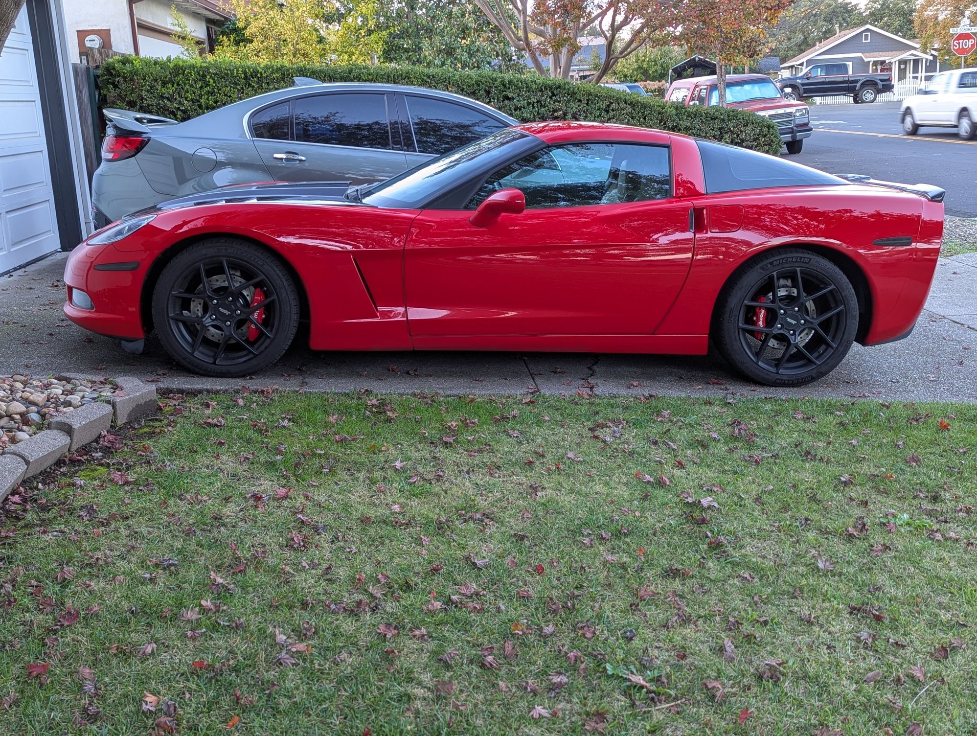

Also as the car sits now without the DRAG pack
As the car sits right now
To 1/4 Mile help please
