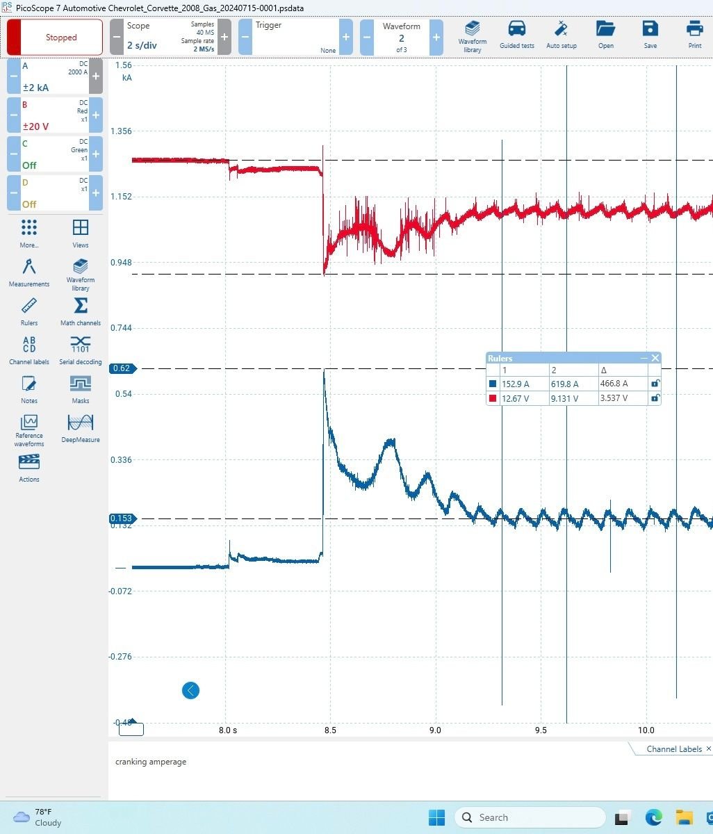

RC (Reserve Capacity) is more important than CCA...get a battery with the highest RC (minutes) that you can get...CCA not that important...more CCA doesn't mean the car will start any better...it only draws about 600-650 amps for a split second to get the motor turning (inrush current) and once the engine is cranking the starter is only drawing around 150 amps !!

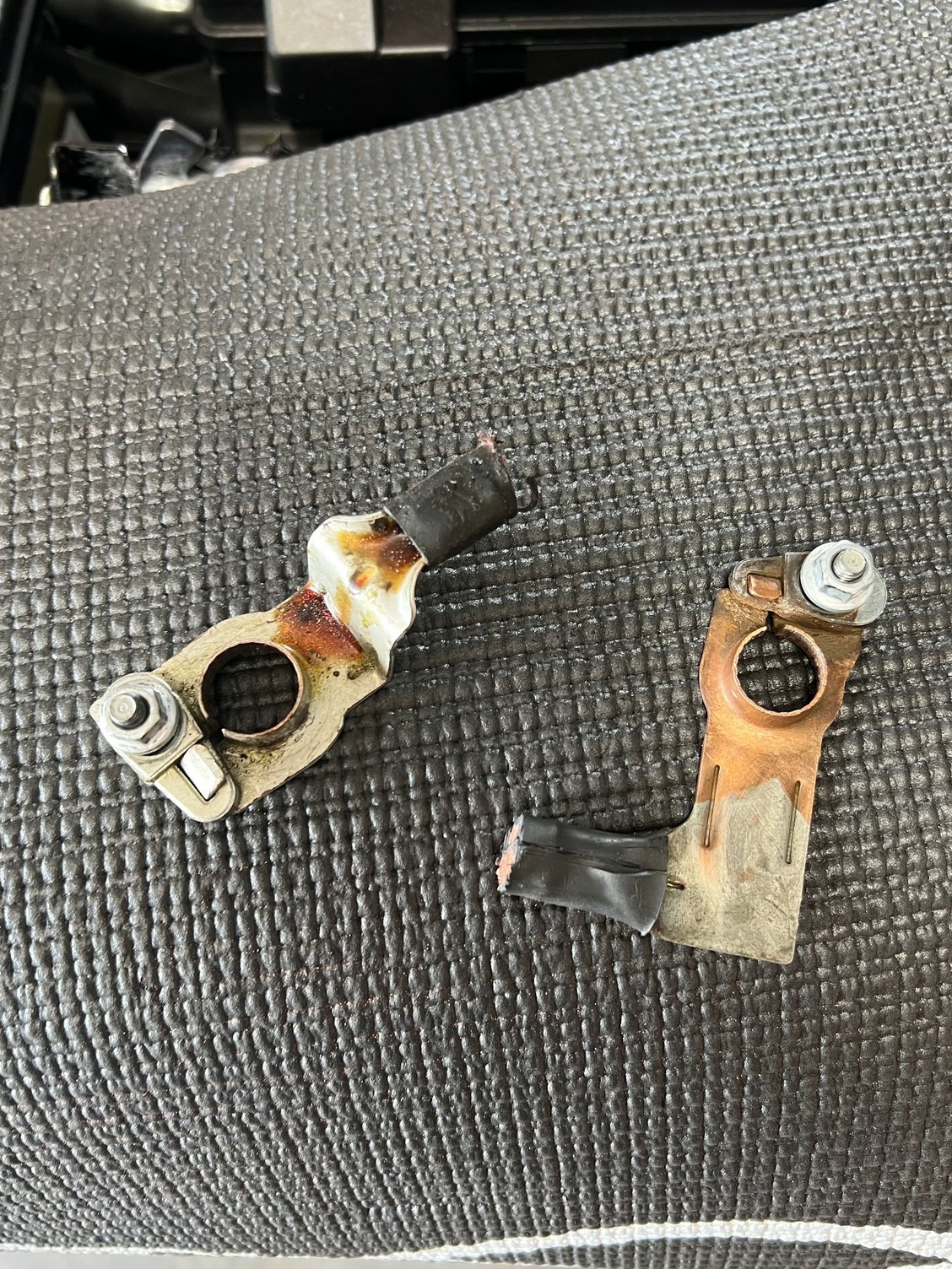

Old Apr 12, 2026 | 04:53 PM
dspanier's Avatar
dspanier
Joined: Aug 2020
Posts: 42
Likes: 11
From: Garland, Texas
Default Took Pic of Terminal
Originally Posted by C5 Diag
That is why we voltage drop the starting system to see exactly where your problem lies...I'd get rid of those crappy OE terminals and get something much better....if you are able to turn the battery terminals by hand they are not tight.
I thought I uploaded this, but I dont see it. The ternimal thats tightened with the bolt doesnt move, its when I push on the cord that the dash lights up. (I should have been more specific). It does look like theres rust on the silver clamp.
I thought I uploaded this, but I don't see it. The terminal that's tightened with the bolt doesn't move, it's when I push on the cord that the dash lights up. (I should have been more specific). It does look like there's rust on the silver clamp.

Omygoodness, I GOT IT! THANKS TO ALL OF YOUR INPUT! It turns out the terminal was not pushed down all the way; wasn't as far down as it needed to be! The pic shows now there's a
Omygoodness, I GOT IT! THANKS TO ALL OF YOUR INPUT! It turns out the terminal was not pushed down all the way; wasn't as far down as it needed to be! The pic shows now there's a "silver bump" where before the silver bump was flat. To the one who suggested the new battery, even though it wasn't the battery having enough load, I'm still SO GLAD I have the right battery to handle this car. But thank you all! This ended up being a simple fix. (I feel ridiculous too, lol)
