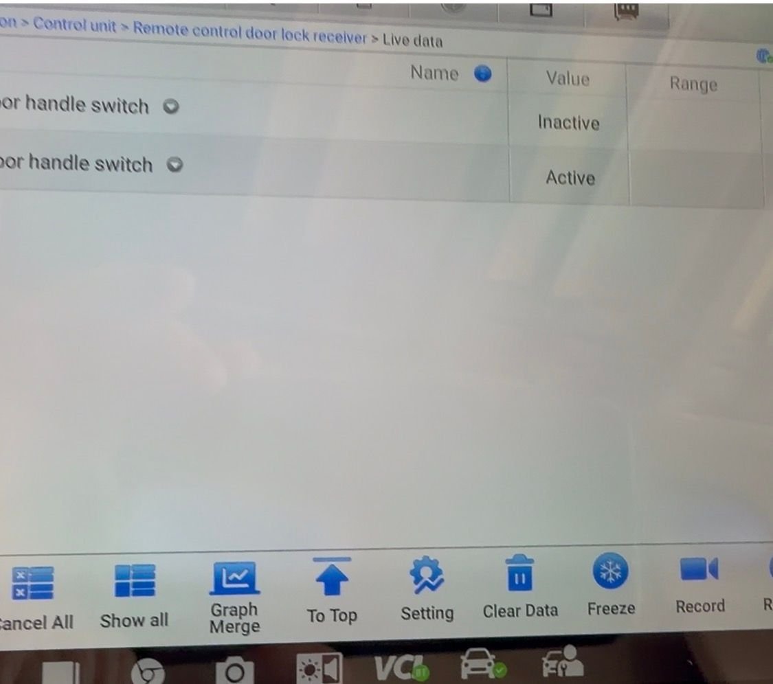

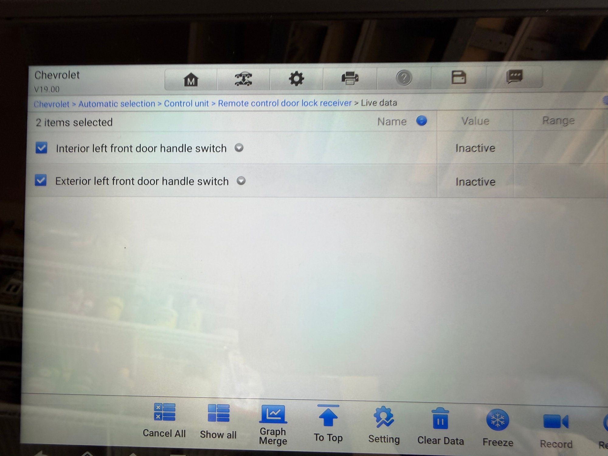

Ok well if it's intermittent it will be difficult to diagnose...now you work with "electronic" techs but do they have any automotive "electrical" knowledge ??...for me these are 2 different areas of knowledge...if you know the difference between inputs and outputs this will make diagnosing easy and it helps to have a factory level scan tool...an "input" is when you attempt to open the door with the door pad...it is a command...your fingers are the input...the output is whatever module that is attempting to move an actuator or something else and these outputs can be commanded with the scan tool also...below is my scan tool looking at RCDLR data showing my driver door exterior switch input when I open the door...it goes from inactive to active...if the input is good then you need to look at the output...wiring or maybe door actuator...unfortunately I can walk you through every step trying to diagnose this with a DMM.

You're absolutely right, the stuff I work on is different, but I prefer to fix my own stuff whenever possible. That looks like it would be a useful tool to have. I have a friend that has a scan tool that I think might do that kind of stuff. I can't remember what model, but it's an autel tablet type scanner. I was quite impressed with it when he was showing it to me a couple years ago, and I know we were able to turn on the hvac afterblow in my car. If it stays acting up again maybe I'll see if I can borrow it.

I was using an Autel scan tool and it's the MS906...it is an aftermarket factory level bidirectional scan tool...you can get a good Autel for $500.00 these days.
