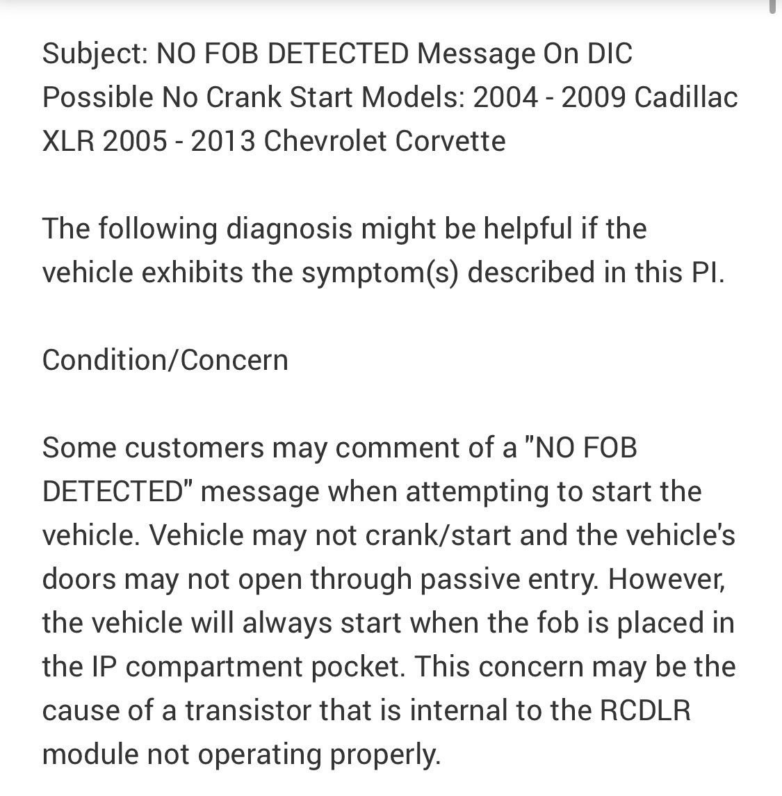

Have you done any mods to the car since this all started like LED interior lights or anything that plugs into the car like a cell phone charger ??...there is a TSB that addresses a no start unless the FOB is placed in the glovebox...read the 1st and last long paragraphs.

Old May 15, 2026 | 05:34 PM
C5 Diag's Avatar
C5 Diag
Moderator, Tech Contributor
Posts: 15,508
Likes: 4,000
From: Cape Coral, Florida

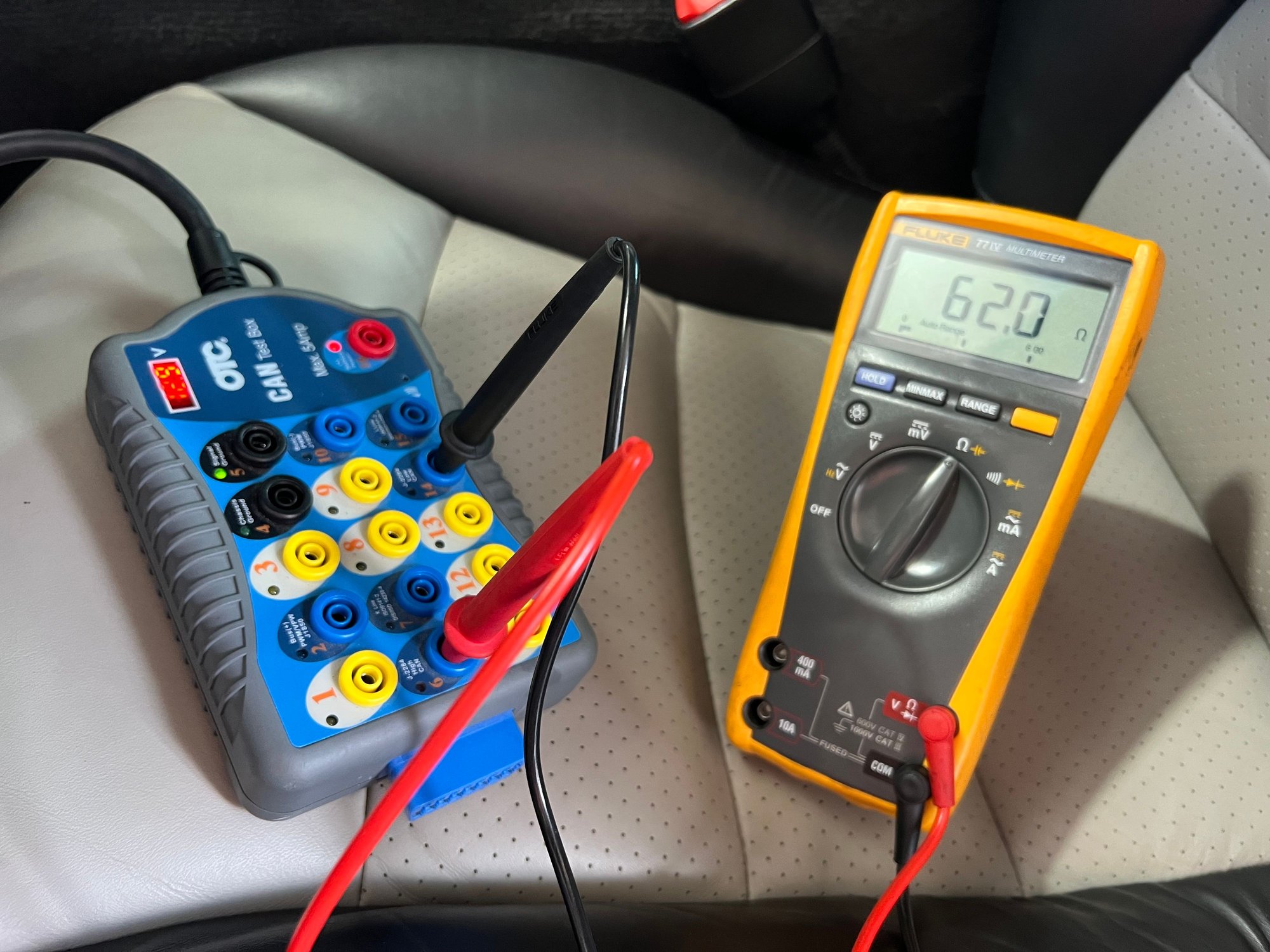

If the comm wires were shorted to ground or each other you'd have issues...those wires are not near your headers...how much electrical diagnostic experience do you have ??...if you know how to use a DMM I'd disconnect the battery and with your ohm meter place the leads on terminals 6 and 14 at the DLC...CAN high and low...you should see 60 ohms...if you see 120 you have an open in the "physical layer"...CAN lines, a connector or the CAN transceiver located within the module...checking terminal 2 (serial data bus) to a good ground you should see around 4K ohms (4000 ohms)....now reconnect the battery and with your DMM you should see 2.5 volts roughly on terminal 6 to ground and 14 to ground...you should also see a fluctuating voltage on terminal 2 to ground.

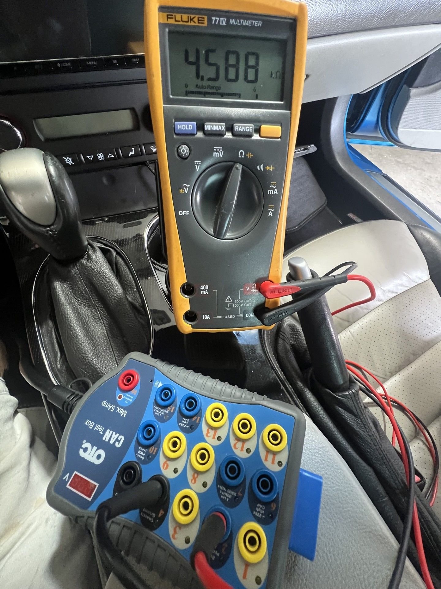

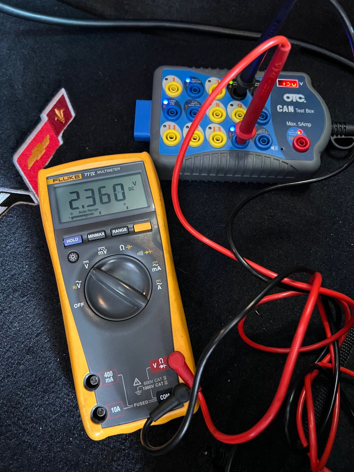

across 6 and 14
across 6 and 14
CAN low terminal 6
CAN low terminal 6
CAN high terminal 14

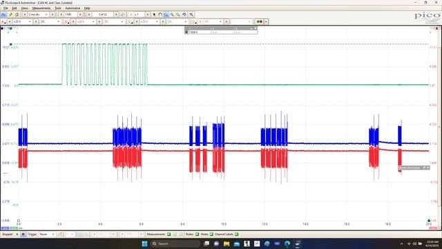

Good High Speed and Serial Data                 waveform.
terminal 2 to ground --4.588K ohms...4588 ohms

Good Class 2...fluctuating voltage of less than 1 volt...with scope you will see a 0-7 volt square wave,

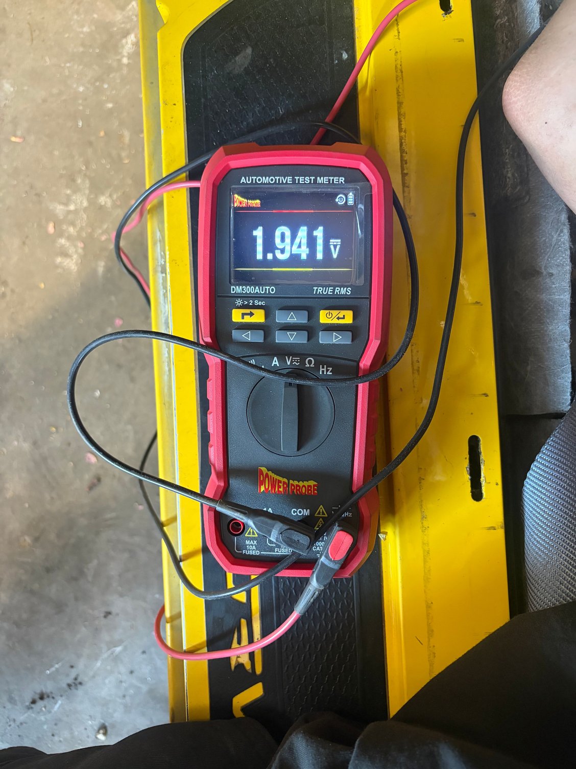

these are the 6 and 14, 2 was fluctuating as well. Are these within spec?

these are the ohms, this is when the car is cold. It always starts when it’s cold.
should I drive it until hot when it usually has troubles getting power after I turn it off and do the same test?

Is 6 and 14 with ignition ON ??...thought you had NO ignition function ??...with ignition off you should just see some "ghost" voltage on either on !!...this is my 6 and 14 ignition ON...roughly 2.5 volt bias...with battery DISCONNECTED you should see roughly 60 ohms with one lead on 6 and other on 14.
