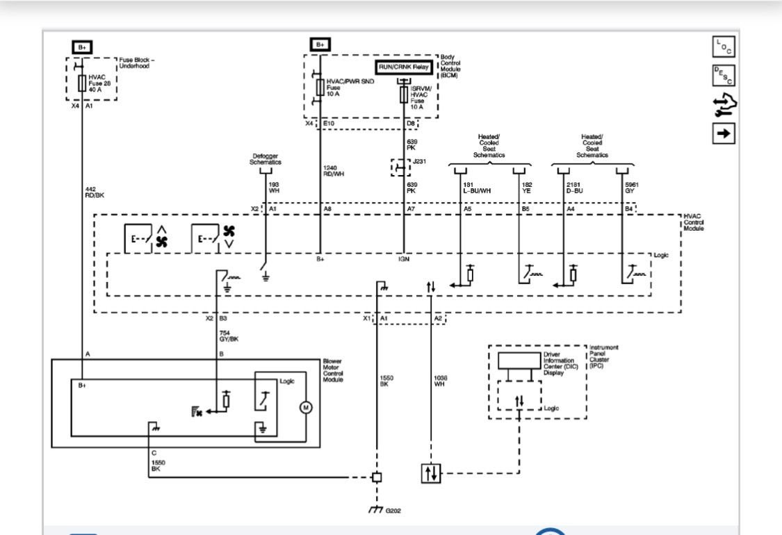

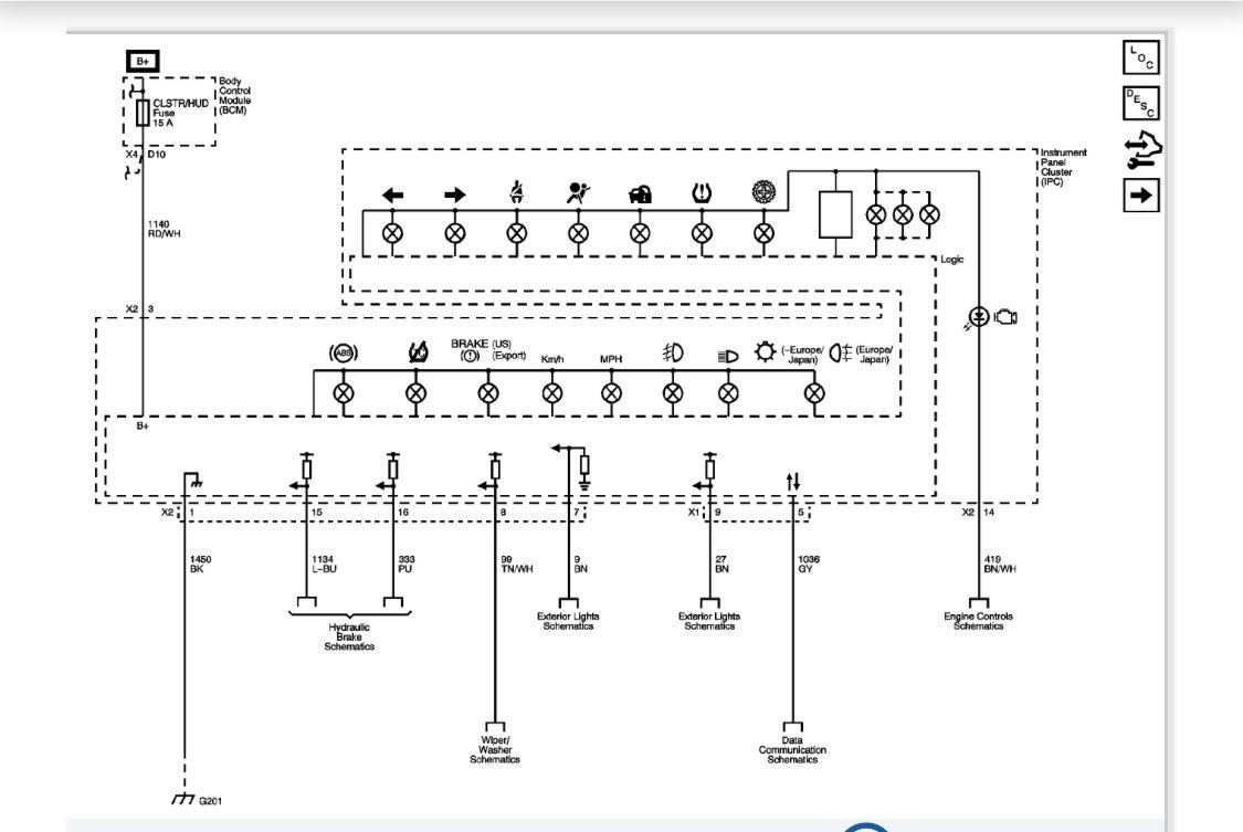

If the car doesn't start that is a quick way to check for a bad body ground...let me check the wiring schematic and see if the IPC and HVAC grounds are tied in together.
Old May 23, 2026 | 09:33 PM
C5 Diag's Avatar
C5 Diag
Moderator, Tech Contributor
Posts: 15,546
Likes: 4,022
From: Cape Coral, Florida
2 different grounds.

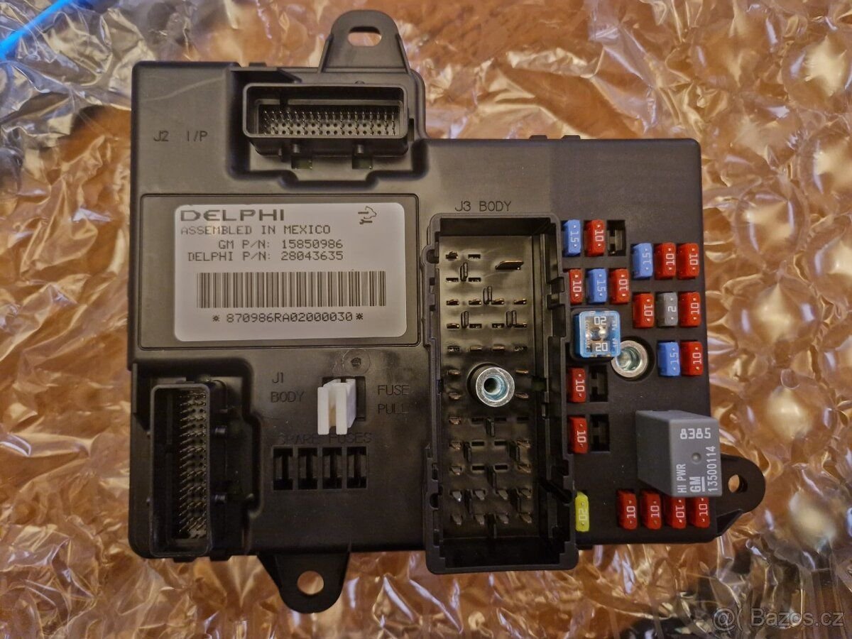

If the voltage is dropping that low into the 12's and while that is happening and the engine is running take one lead of your DMM and connect it to battery positive and take the other lead and place it on the STUD of the under hood fuse block B+ cable and now read the voltage...it should read close to 0 volts which means you have no voltage drop between the battery and the fuse block...if over 0.5 volts (and even if it's less than 0.5 volts) remove battery negative and then remove the nut that holds down the B+ cable...the nut may be loose or you have corrosion on the B+ terminal there...remove it and clean with some emery cloth install and retest with DMM...also make sure that the bolts holding down the fuse block are tight...at the BCM with battery negative still disconnected remove the J1 and J2 connectors clean with contact cleaner and reinstall...remove the nut securing J3 and also clean with contact cleaner...now remove the BCM and on the back side of it remove the nut holding J4 down and clean those connections down also...reinstall the BCM and then battery negative and see what happens.
