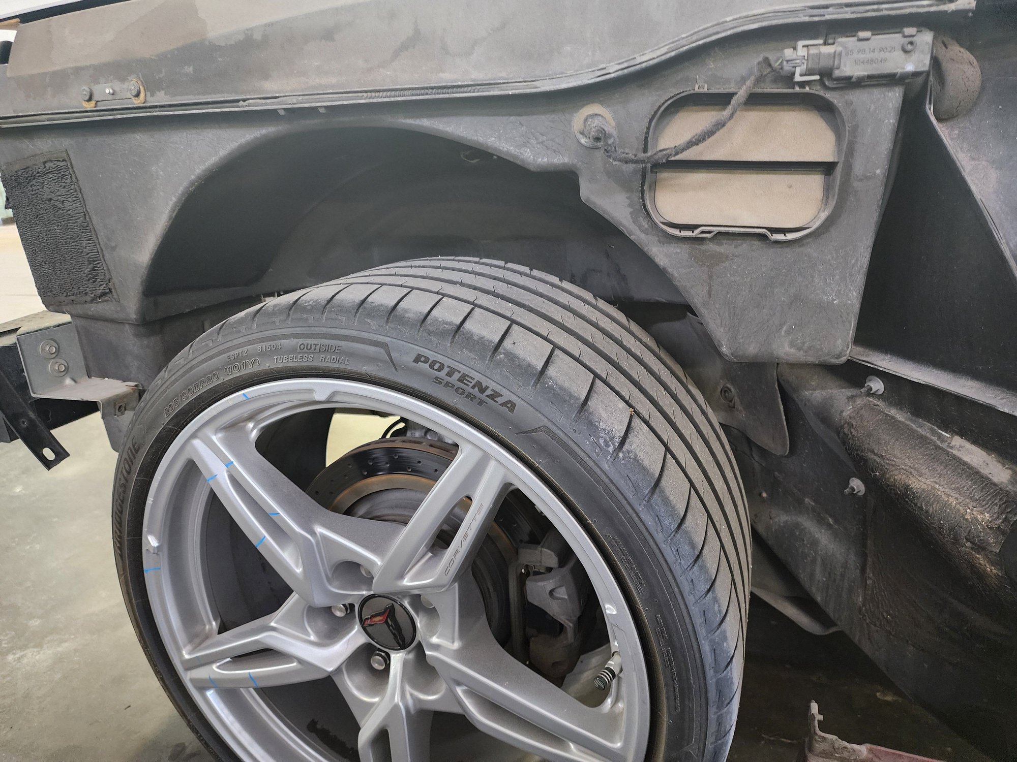

Has anyone changed the pke antenna for the drivers side of their coupe? I'm looking for the location of the antenna. The fsm only shows for a convertible. It shows it to be in the b pillar. It's not there.
Anyone that's done it and definitively knows the location, it would be greatly appreciated.

Nvm, 100% you have to remove the quarter panel.

For anyone else interested. Here's a picture.
