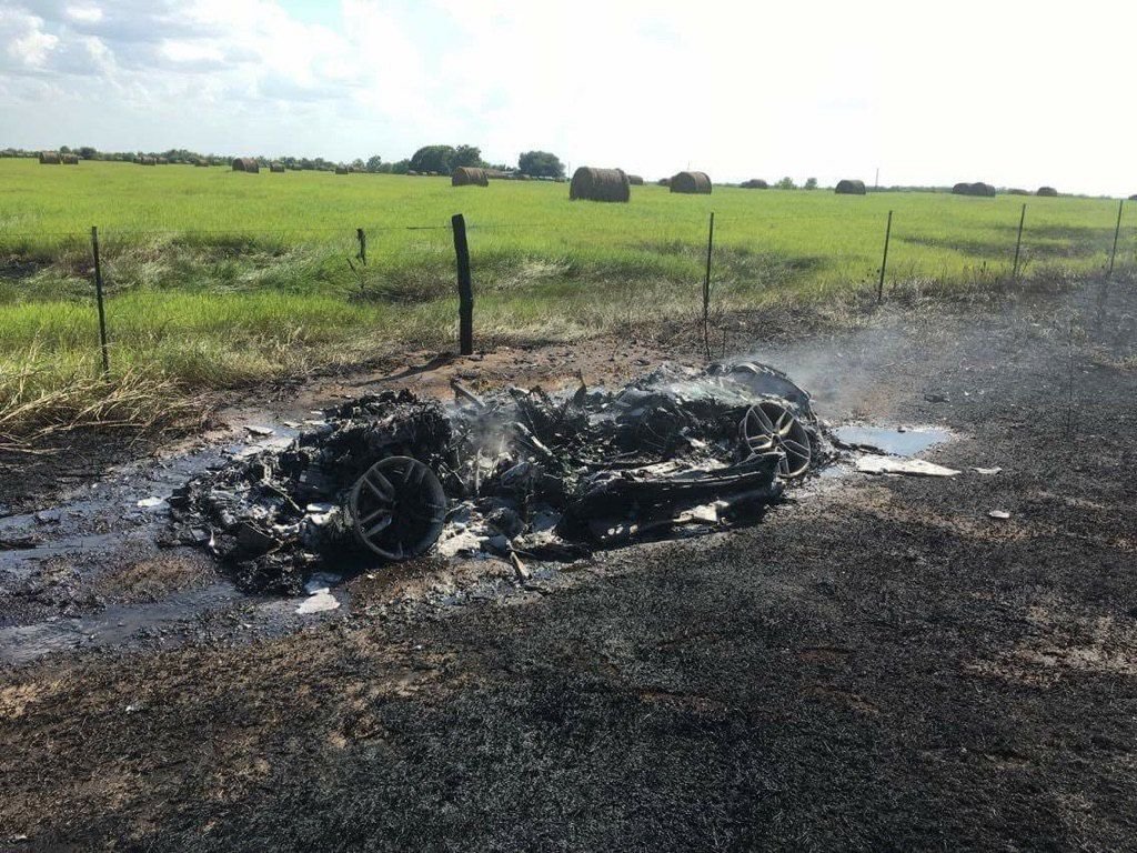

On the first test drive the car caught fire. It put my brother and I in the hospital with 1st to 4th degree burns. I'll post more tomorrow
To Horsepower possible?
Old Jul 18, 2016 | 12:47 AM
T/A KID's Avatar
T/A KID
Joined: Jul 2005
Posts: 1,646
Likes: 188
What???? Glad y'all are ok, what the hell happen????
Old Jul 18, 2016 | 12:56 AM
Spulbus2013's Avatar
Spulbus2013
Joined: May 2012
Posts: 227
Likes: 14
From: Houston TX
Holly Crap!!!
Old Jul 18, 2016 | 07:46 AM
officermartinez's Avatar
officermartinez
Joined: Nov 2014
Posts: 687
Likes: 83
From: Fort Worth Texas
Omgggggggggggg! You can always buy another car, but your burn trauma is no joke. You two are in our prayers!
