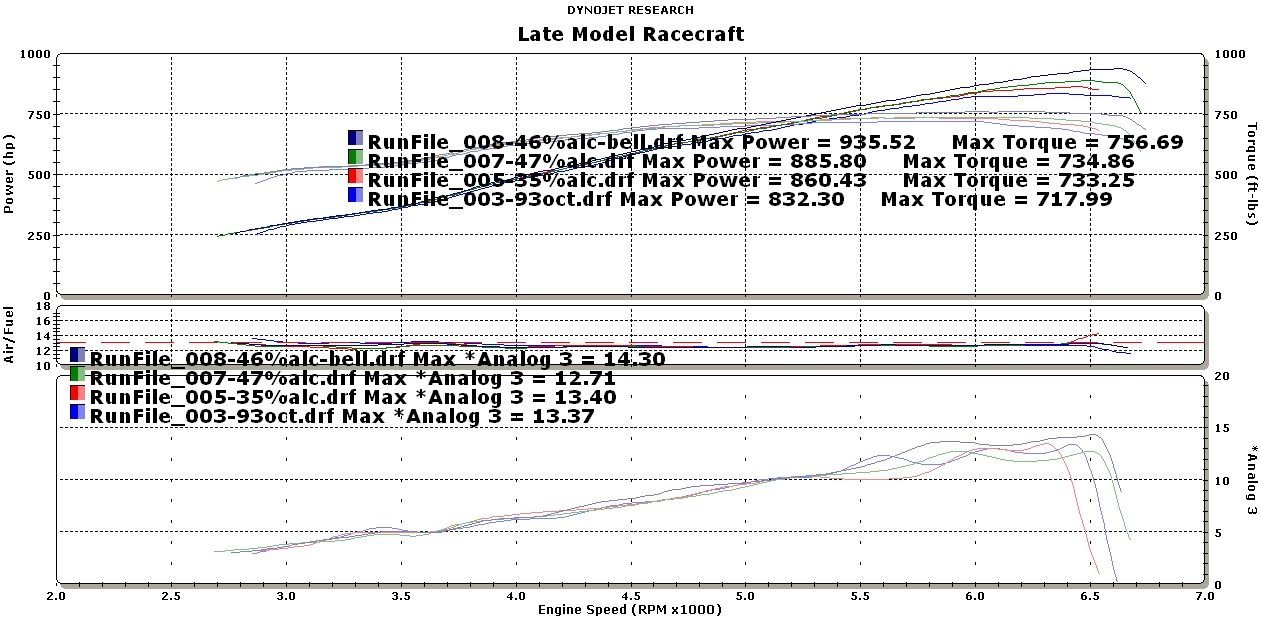

The LT4 loves E85!!! This is a 2016 Z06 that came to us with modifications done from another shop. Customer wasn't happy with the track performance so he brought it to us to see what we could do for him. The blue line is the way it came in. Green line is 93 octane and meth. Red line is E85 and meth. To say the least, the customer is now in love with his dream machine. E85 is well worth it on FI engines.

I too recently did the flex fuel conversion on my car. Did a new shortblock, heads, flexfuel, LT4 HPFP and injectors, and added another meth nozzle. Oh and of course a clutch.
I was able to run about e47 on the dyno, but you can see the car came alive with the corn. Run file 8 was with a bell on the blower:

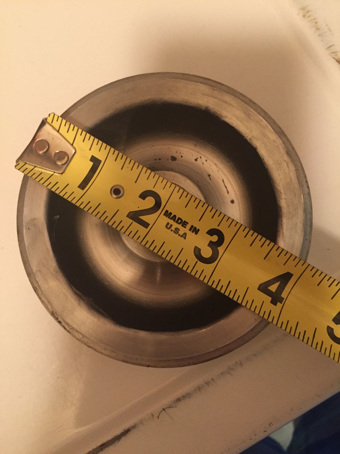

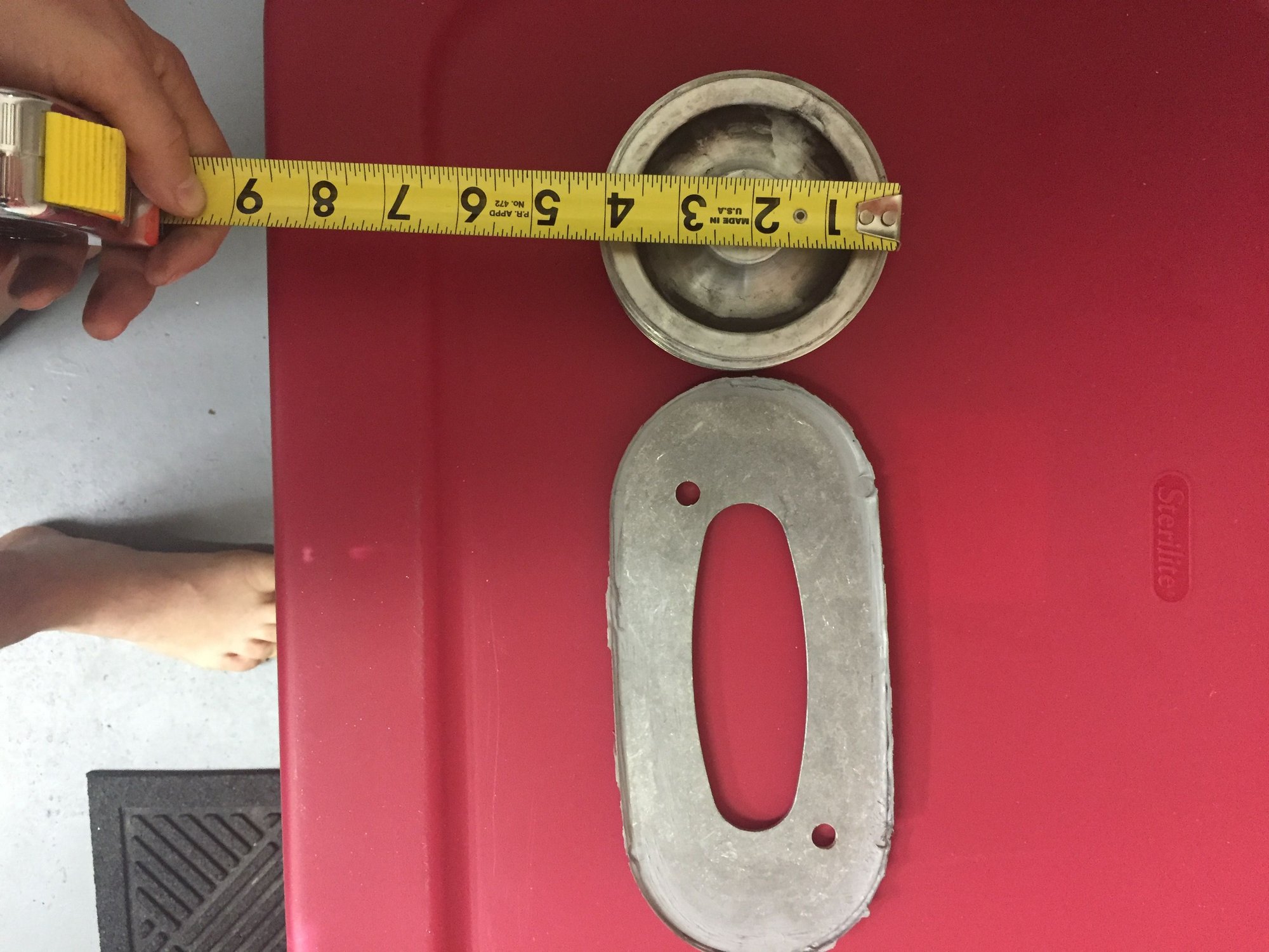

Guys the base ECS kit comes with a 4.1 inch upper and restrictor plate and 8.2 inch lower. Here is a picture of both. Unfortunately I didn't take a comparable picture of the new pulley but I can assure you I ordered the 3.75 directly from Chris at ECS. Here is the thread where we had the discussion about it.

Are you measuring the pulley lip or grooved section only? If that pulley has a lip then it's a 3 inch pulley in that pic.

That's the pulley that came with my novi1500. 4.1 inch, doesn't have a lip.
