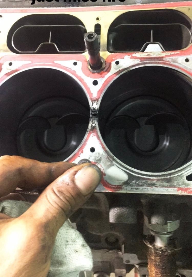

Build is going to be late, Engine builder just told me that the block is hurt

Wasn’t expecting that, i have everything new and ready except the block, idk how did that happen but he said its might be a head lift! The car never made more than 865 on the old setup and it had a head studs!
you had stock bottom end right?

Any ideas what could it be from! Now looking for a good used bare block or a good priced new one
