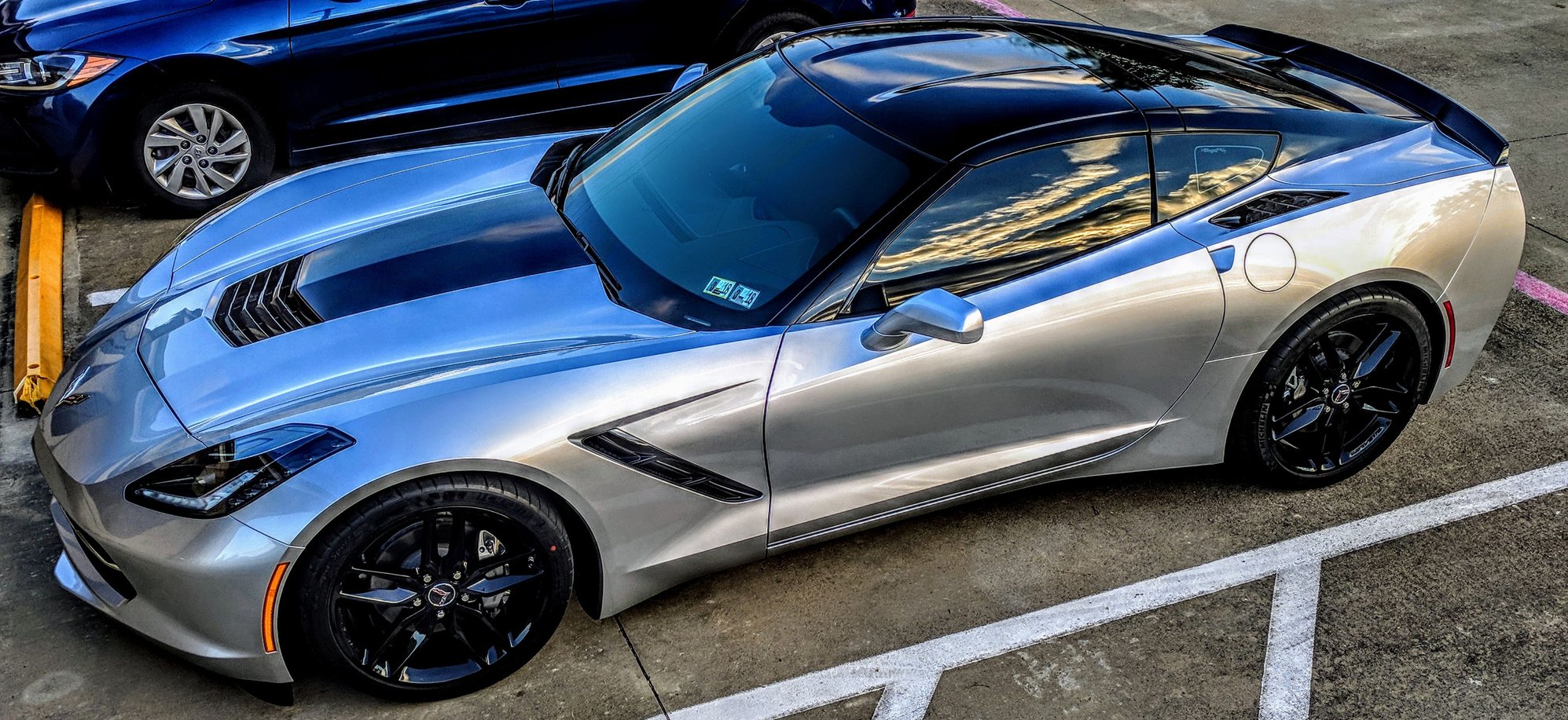

I wanted to say Thanks to Chris Edwards for the great deal on a new A&A kit and the Alky Control. The kit arrived this Friday and we started working on the car at 6pm Saturday. Sunday evening we were test driving her. Stay tuned for numbers when we get time to get this thing on the dyno.
17 1LT Stingray M7
Parts installed for base tune: 477 RW
TSP Headers and midpipes
Vararam Intake
Ported TB
Ported Intake
DSX Tuning E-85
James Karger Tuned
We will see what James can do with the Methanol and the 3.6 Pulley on a SI-V3.
