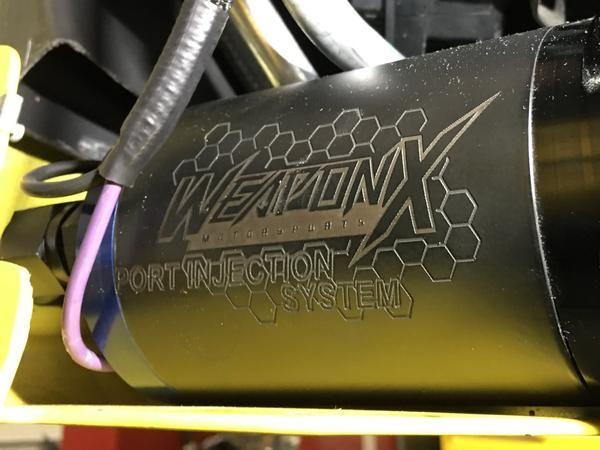

We have had a lot of success with these so far and to my knowledge is the only kit that is a complete solution with controller, custom plug and play harness, low side kit complete with premade lines, fittings, regulator, billet rails, big fuel pump, injectors, flex fuel sensor for petrol to E85 auto tuning, dual widebands, fuel pressure gauge, custom mounting plate for the gauges, etc! The kit has dual wideband control for bank to bank fueling if necessary and closed loop correction as well as an auto learn feature - all for under $5,000 for the kit and we have an installed sale price of $2,999 installed and tuned. This controller and components are all top notch, this is by no means some off brand alternative, and while we offer a full Pro version of the controller as well with launch control, boost by gear, etc that I have on my compound boost ZL1, you simply do not need a full on stand alone controller for something that is simply driving the injectors. GM proved that with their port controller introduced on my ZR1, but we even have a lot of extra bells and whistles like closed loop wideband control and dual bank wideband control as previously mentioned, along with several other channel inputs.
PS we're even raffling one off for our Independence Day Sale starting Wednesday
SPI Kit Info:
https://weaponxmotorsports.com/produ...=5777974296603
You'd have to modify the PC manifold unless you did the G1 Pro manifold which we did on our flagship C7 build with an air to water intercooler inside and our chiller kit. I'll get more info on that up this week, but this setup is chilling the F1X air temps by 160* and this is also controlled with the SPI kit if equipped!
We're even rolling out our own billet fuel rails for the SPI kits! Here are a couple shots of the prototype.
