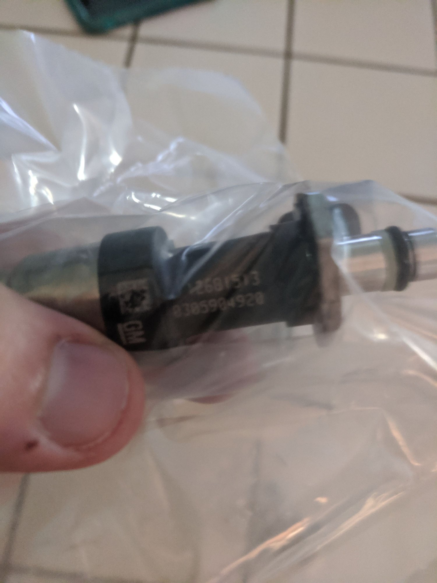

Old Sep 11, 2019 | 06:41 PM
sevinn's Avatar
sevinn
Joined: Jul 2009
Posts: 3,755
Likes: 190
From: Baton Rouge LA
St. Jude Donor '14, '16
Just wanted to update that these part numbers are confirmed to cross.
I bought a set of 8 12686277 from summit, which is a part number for a kit and the injectors have individual part numbers of 12681513 on them.
