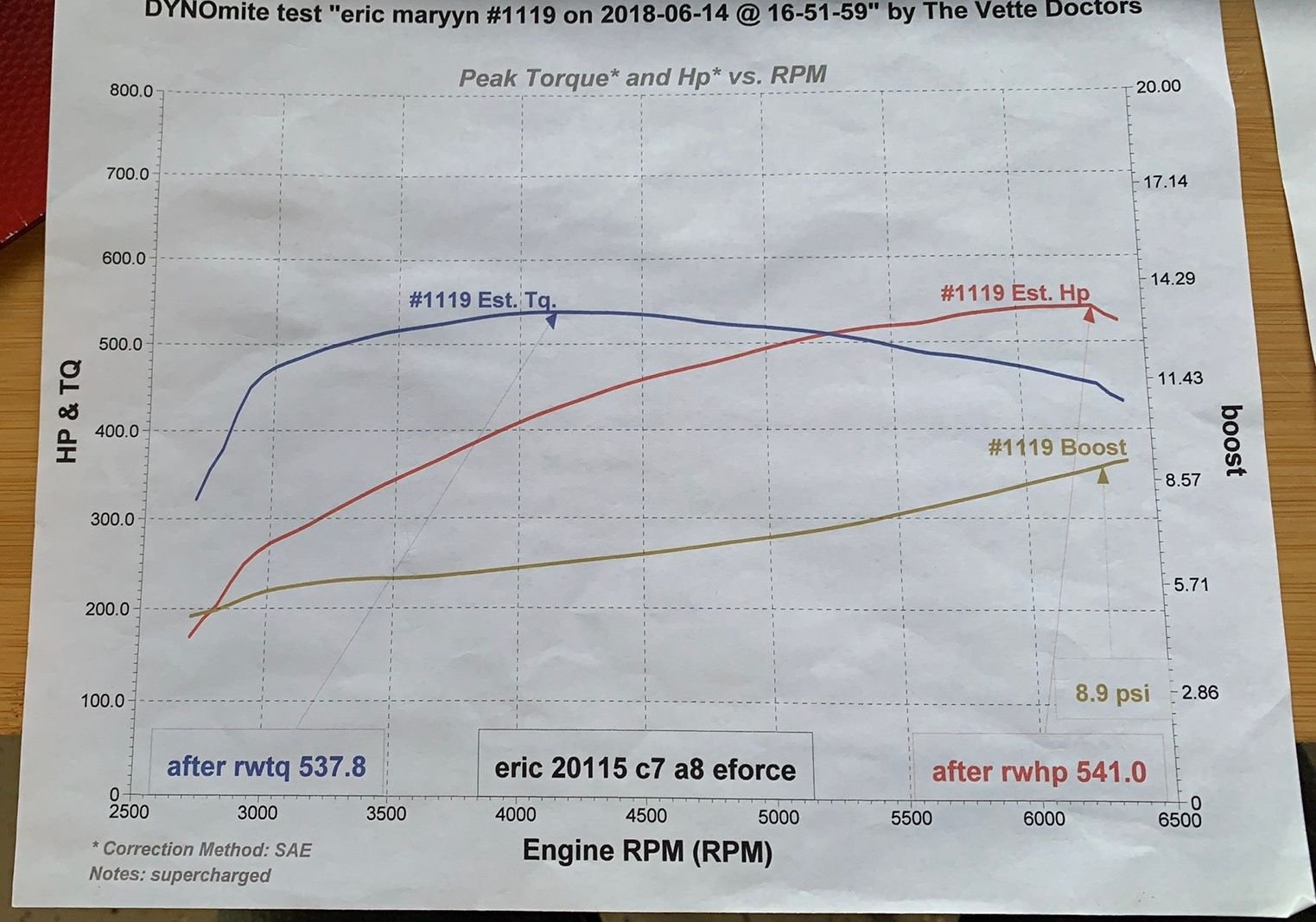

I have to data log this week but was just looking for insight. I have a 15 Z51 with an Edelbrock stage 2 E force, Borla X pipe GM CAI and made 541whp on a dynomite Dyno on 9 psi.

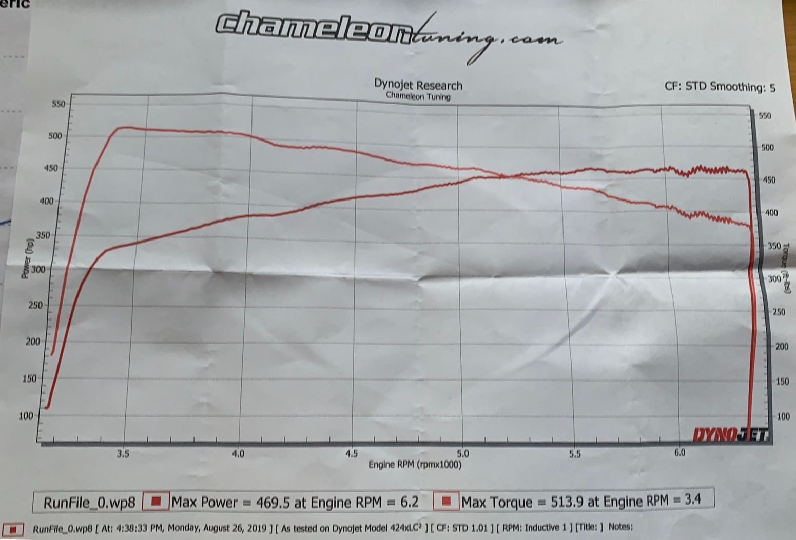

Since the above dyno pull I added the new 95mm LT5 throttle body. That alone brought me up to 10 psi. of boost. I was then getting a few degrees of KR so I had the car retuned for 102 octane (Boostane) by Chuck Cow. The car felt great but now felt somewhat sluggish. I made a few dynojet pulls yesterday and I’m way down on power. The car runs smooth at idle and drives great but now I’m make a ton less power 469whp. Any ideas?

Well it looks like it’s two different dynos at two different times of year? So there’s that....
However this sounds tune related to me.
