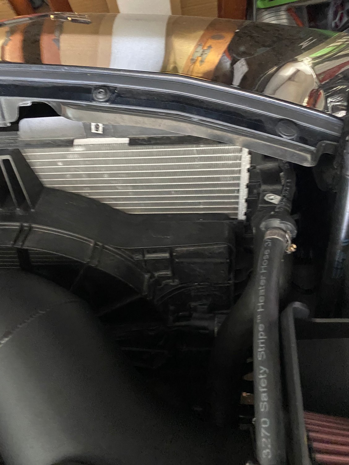

Let me know how it fits. I may decide to swap over as well, just curious on fit since the eforce reservoir is right where the can looks to mount

From: Long Island New York
I agree it looks like it will be tight mounting the MMS catch can with the E force reservoir, I sent Mighty Mouse a bunch of under hood pictures as per his request, I’m pretty sure he will have a solution.

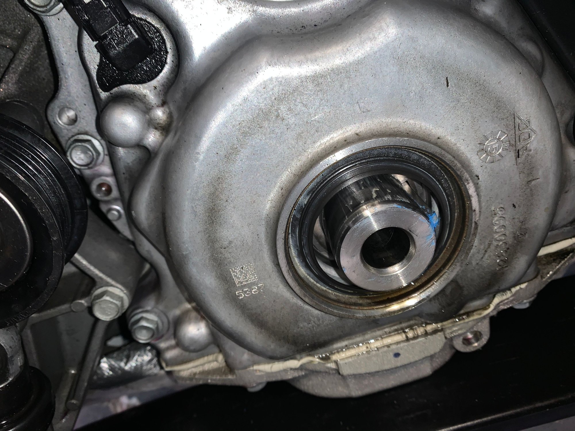

Think I found the problem
Old Mar 21, 2020 | 05:52 PM
sevinn's Avatar
sevinn
Joined: Jul 2009
Posts: 3,755
Likes: 190
From: Baton Rouge LA
St. Jude Donor '14, '16
Yes sir! Luckily the balancer is a pretty easy job on a c7.
