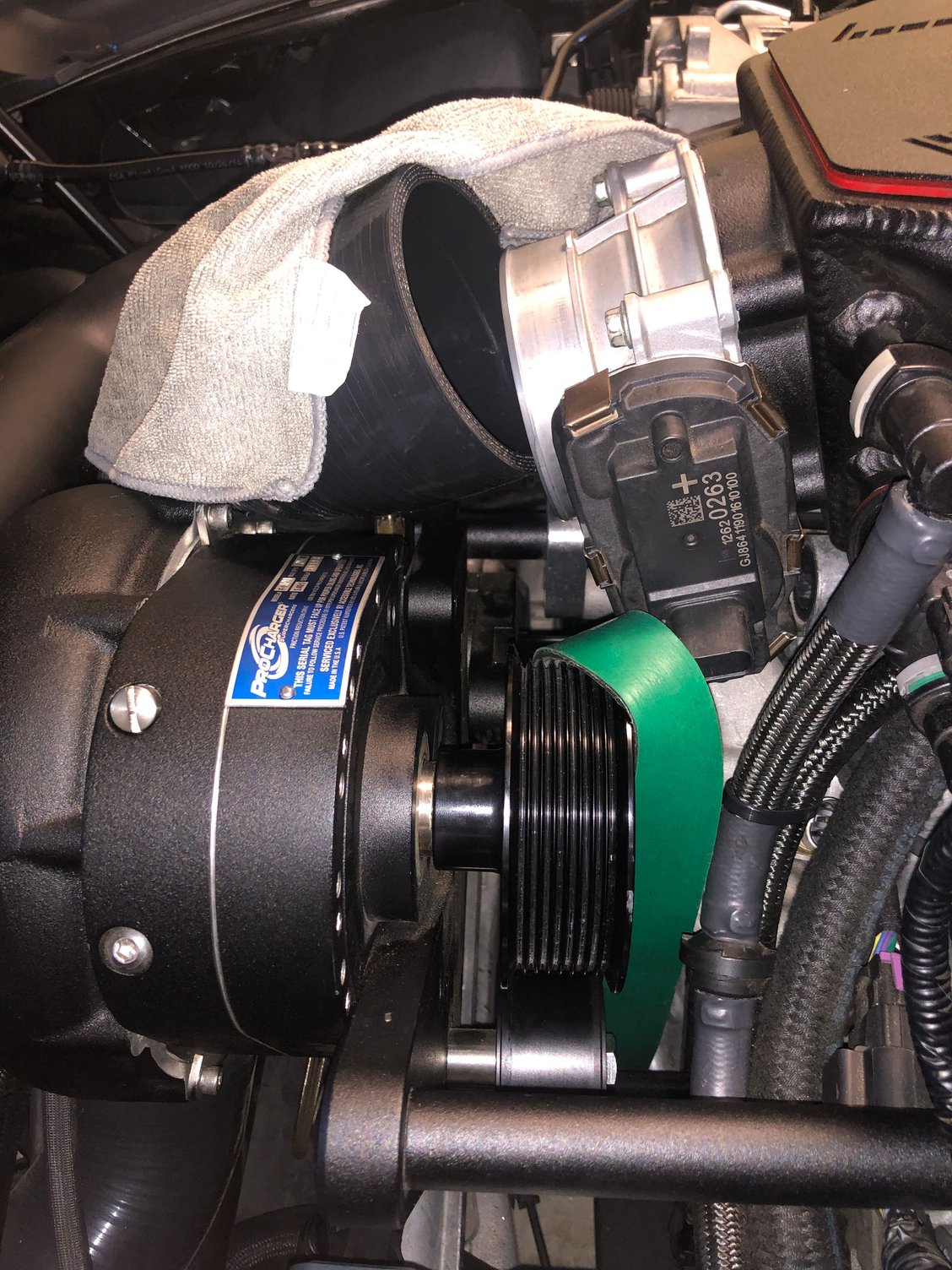

Can someone give me any tips/tricks to getting this new belt on my F1A-94? Picked it up from the shop after having a 3.8 upper put on with a K080435HD on it but was told the belt was slipping so it would be best to go with a K080427HD. Long story longer, I figure no problem I’ll bring it home to get it done. Why did I say that lol? Got the old belt off, the idler pulley moved to the outer most position (told to do so by the shop), new belt routed through but that’s where I’m stuck. Seems like I’ll never be able to get this thing onto the pulley. Tried pulling up on the tensioner, removing all tension while trying to get it on but stills seems too damn tight. Any help would be greatly appreciated.

I remove the blower pulley and the idler pulley. When going back in put the belt on blower pulley first then install blower pulley followed by the idler pulley. After a few times you’ll be able to do it in 10-15mins easily.
when going to install the blower pulley I use a long pry bar to pry the tensioner up and with other hand slide the pulley on to blower. Same with idler pry the tensioner up and slide the idler pulley with bolt on. Try to get the bolt hole closest to tensioner as it will give you more belt wrap on blower pulley. With the 4.0 it won’t go but with anything smaller you can get the furthest bolt hole.

On the PD blower I always slid the belt onto the idler last. A lot easier than going over a pulley lip and all the ribs on the pulley itself.

I'm following you up to the point on mentioning where to put the idler pulley. Are you saying you’re agreeing with using the outer most hole with the shorter belt?
if your standing in front of car looking at engine go with the one farthest left if you can get it on. The bolt hole to the right is for larger pulleys as belt will be too tight to get it on the left bolt hole. Always use the left one if belt length permits as it gives you more belt wrap around pulley.

You wouldn’t need to remove blower pulley, I have changed belts in 15 mins before you need to install the belt on the blower pulley without the idler pulley installed that will help give you space to install the belt on the blower pulley, after you install the belt slide the idler pulley against the belt until the bolt line up with hole
