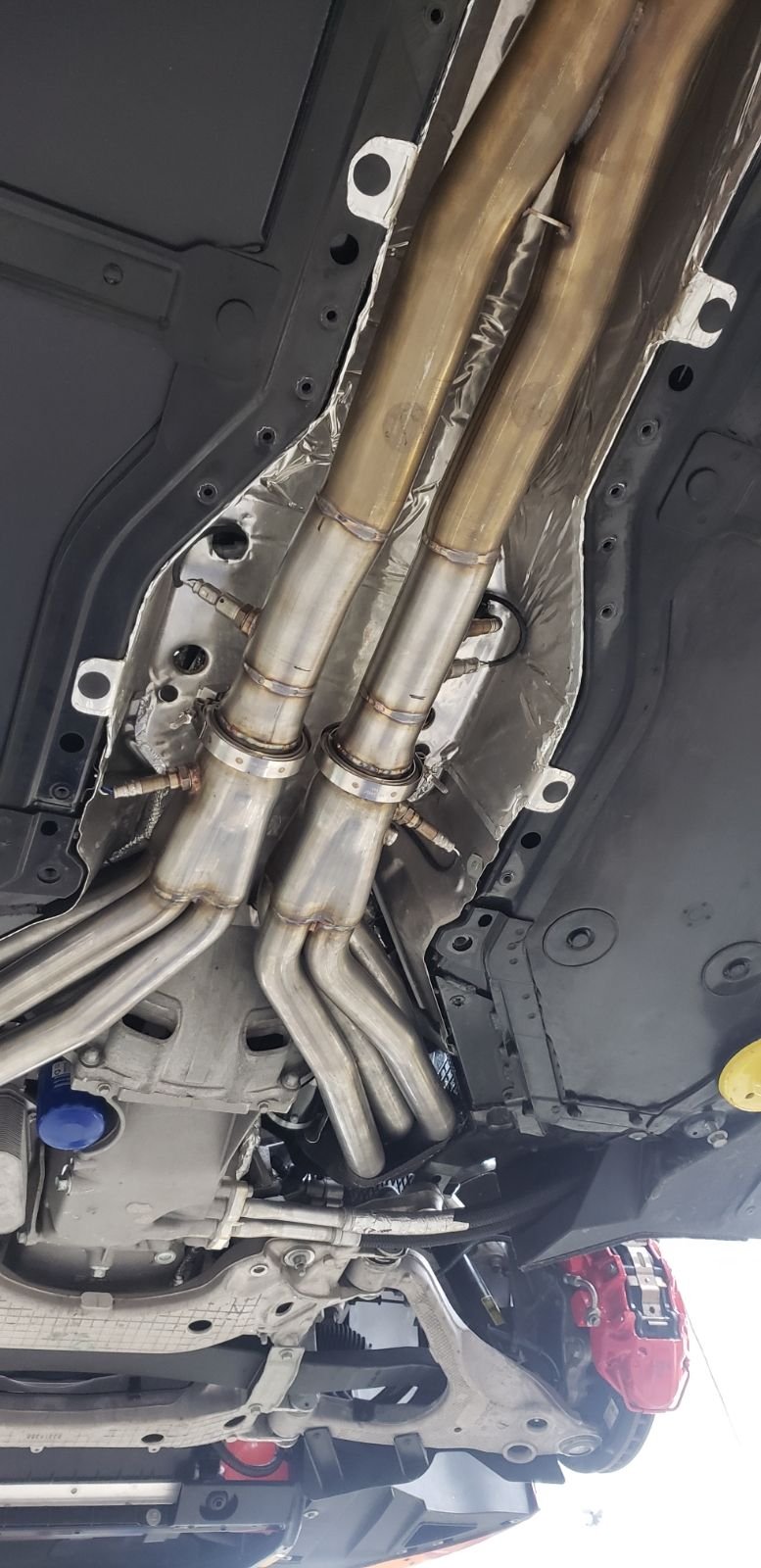

You can use whatever you want if you can weld good enough lol. Stainless Works headers and discontinued Borla x-pipe.
Pretty work.
