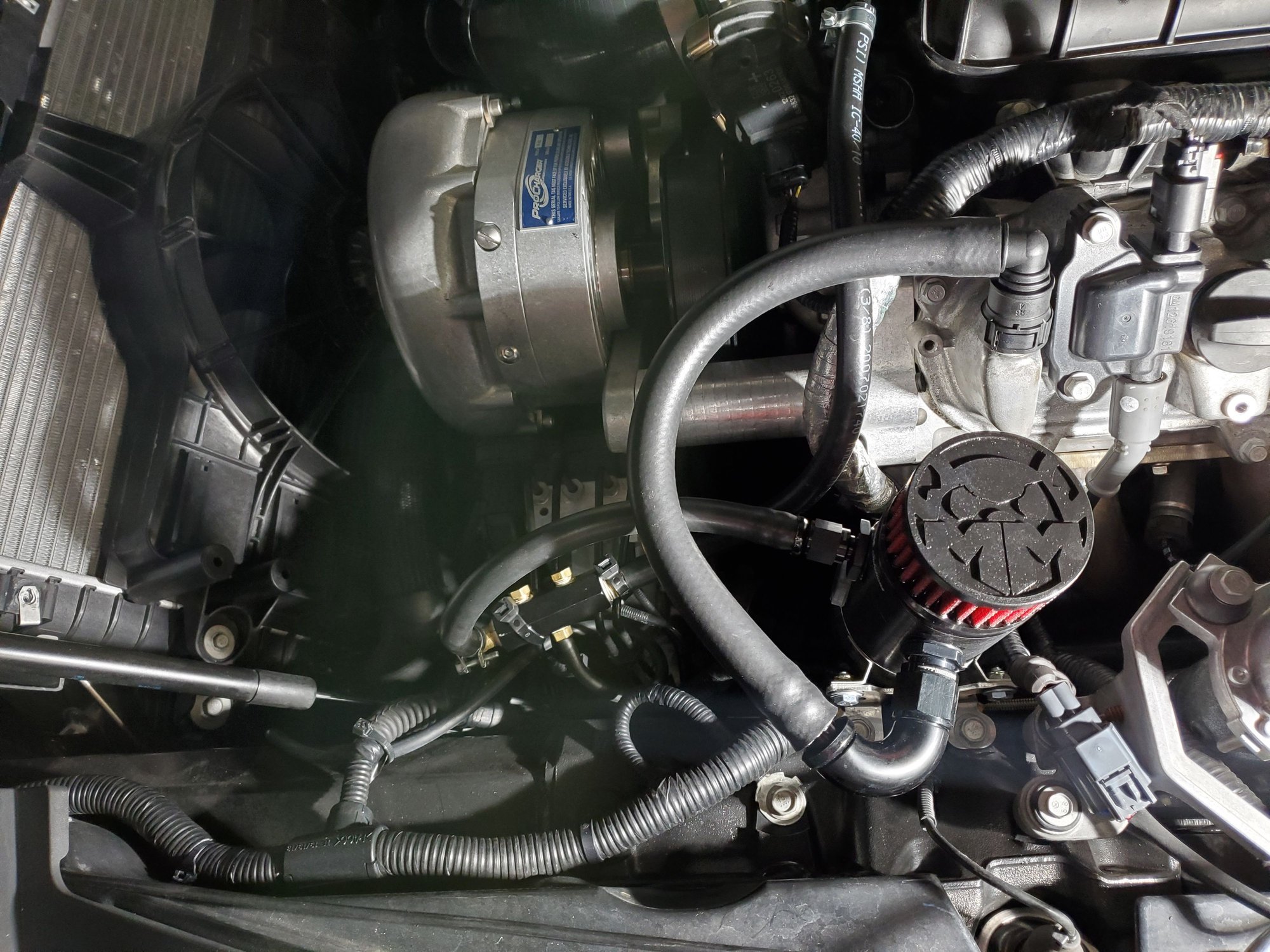

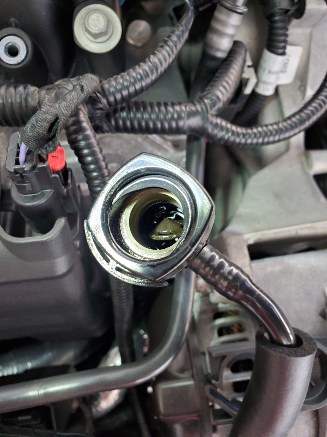

I got the MMS wild catch can installed a few weeks ago and all has been well since with no oil leaks. I did find something that could have been causing some problems during the install. I was poking around with the pcv system and found the passenger side valve cover connection was at least partially blocked. It seems they removed the check valve ball on both sides in those oem quick connection fittings on the valve covers but on the passenger side the little "thing" that I assume is supposed to stop that ball from getting stuck in the connector was still in the connection and was lodged in there sideways (pic below). Looks to me this was probably at least partially if not almost completely blocking that pcv connection on the passenger side valve cover. The pic below is exactly how I found it.
MMS Wild can installed (I highly recommend this product)
It was time to change the procharger head unit oil last night since it's been about 500 miles since install. I'll have to say the shop that did the install hooked me up with the addon braided line procharger sells to make changing the head unit oil easier. It was a pleasant surprise they had installed that line to drain the oil because if not it would have meant I needed to remove the head unit to change the oil. I don't see any way I could have gotten to the bottom of that thing without removing the head unit. Also changed the engine oil even though it only had about 1500 miles on it. It looked clean no signs of metal in the oil.
If there's an issue with the motor I guess I'll just run it until it blows up and hope there's no damage to the block.
