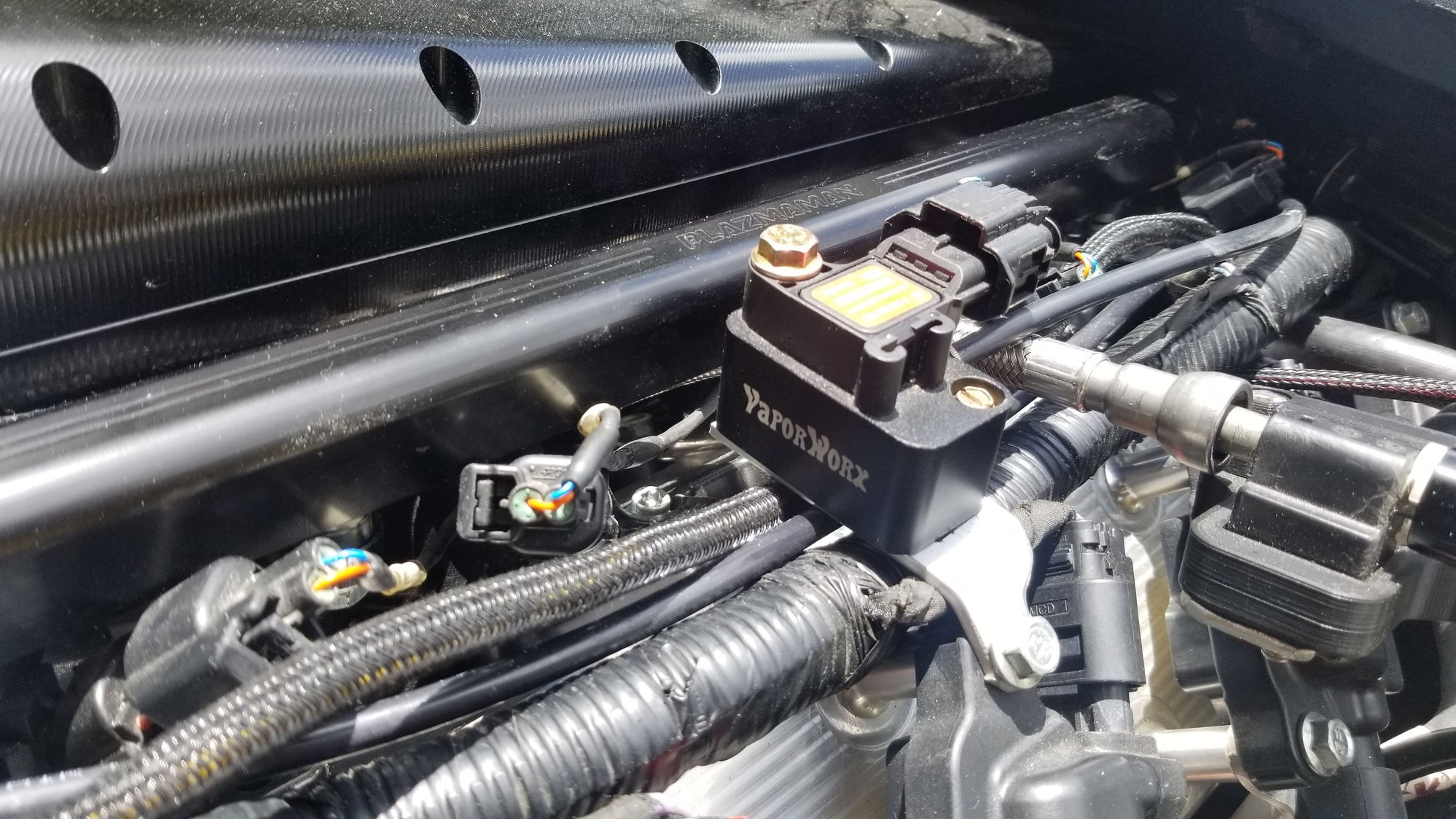

Originally Posted by edsc7
There is no port for evap , you’ll need map sensor extension harness as it relocates it
did you have to use the LT4 fuel line? Also where did you get your map sensor extension? Looking at getting one of these this weekend

I am using a vaporworx map relocation. I made a bracket mounted on the coil pack. I don't have that particular intake but should be the same principal.

guy in Texas had one new in the box so I scored it, got a GPI harness extension, temped it on but for sure need the LT4 fuel line so it’s ordered be all back together Wednesday.
