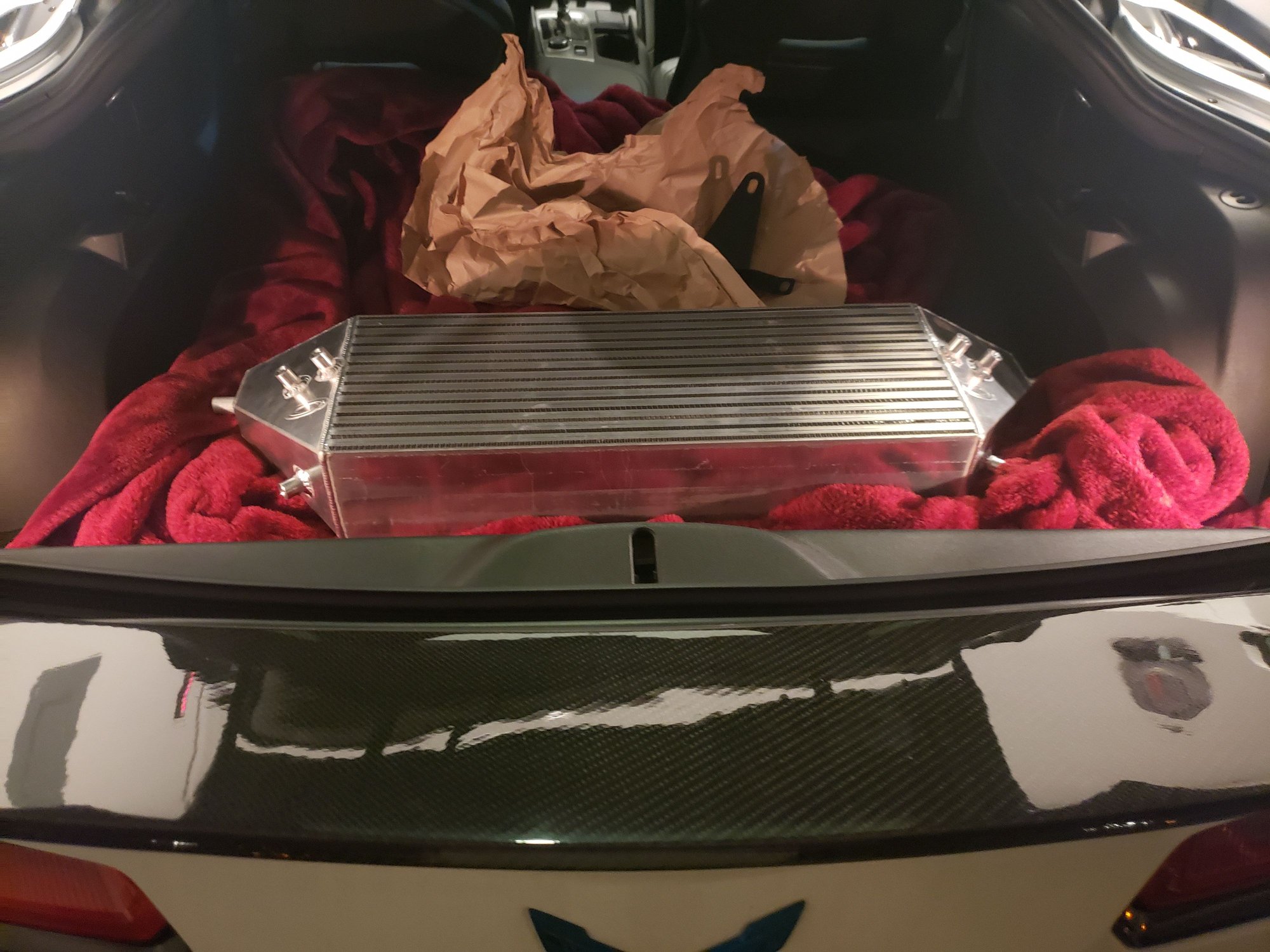

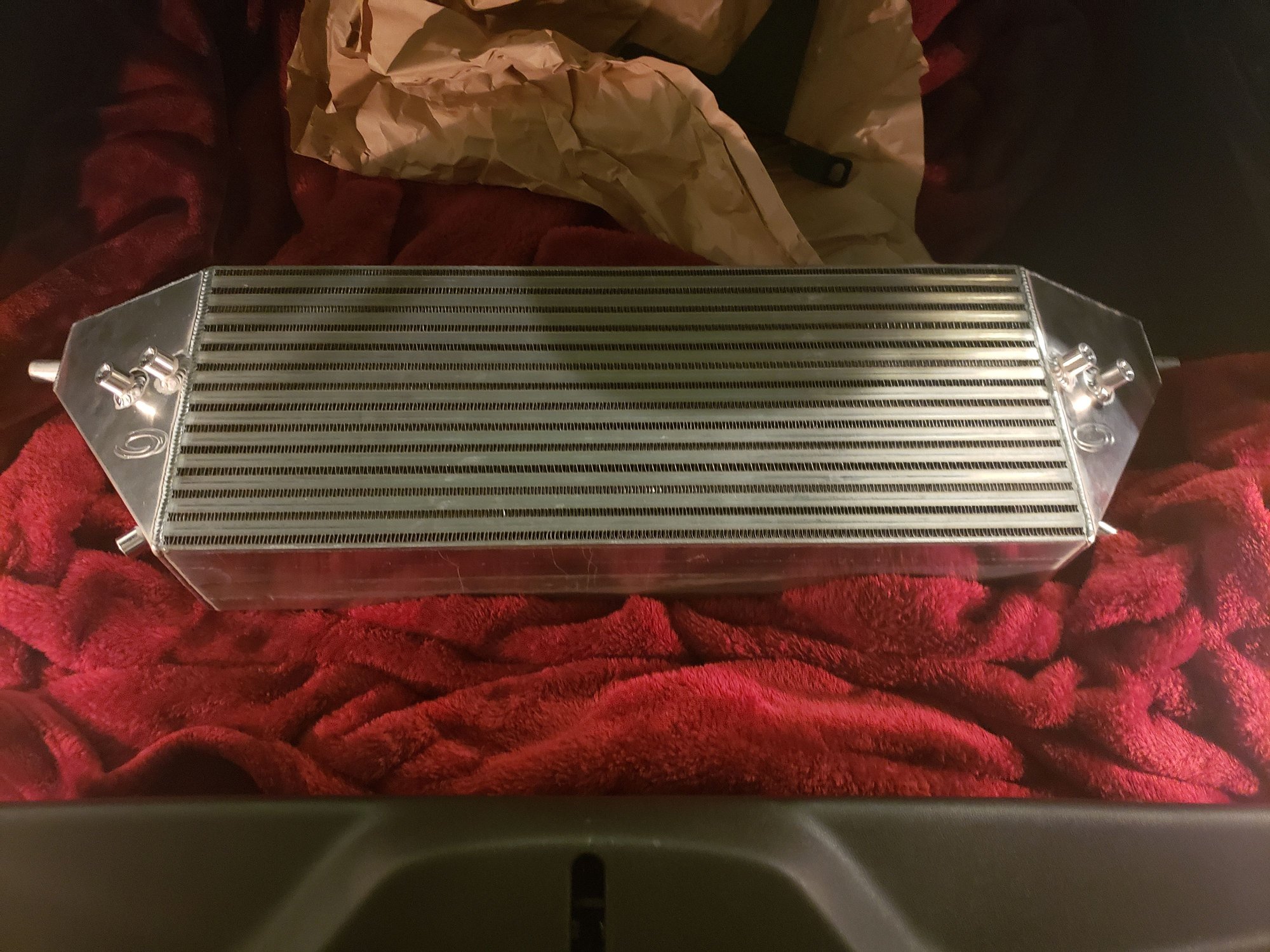

Old Aug 5, 2021 | 01:32 AM
16 Stingray's Avatar
16 Stingray
Joined: Feb 2019
Posts: 417
Likes: 38
Default Intercooler finally arrived
Replacement for A@A. Hoping to drop IAT'S 20-25F. Car is being tuned after install. Probably be 825rwhp with 15psi boost. I was looking for options besides meth.

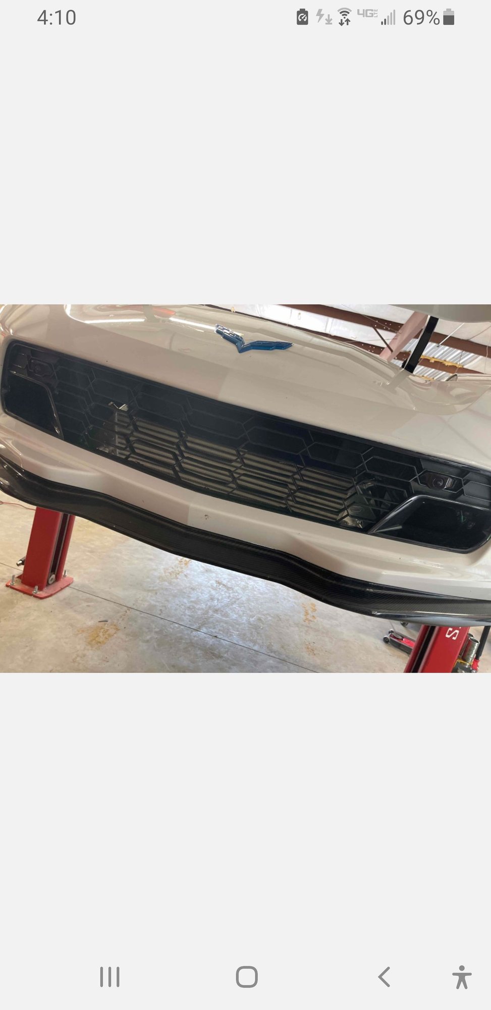

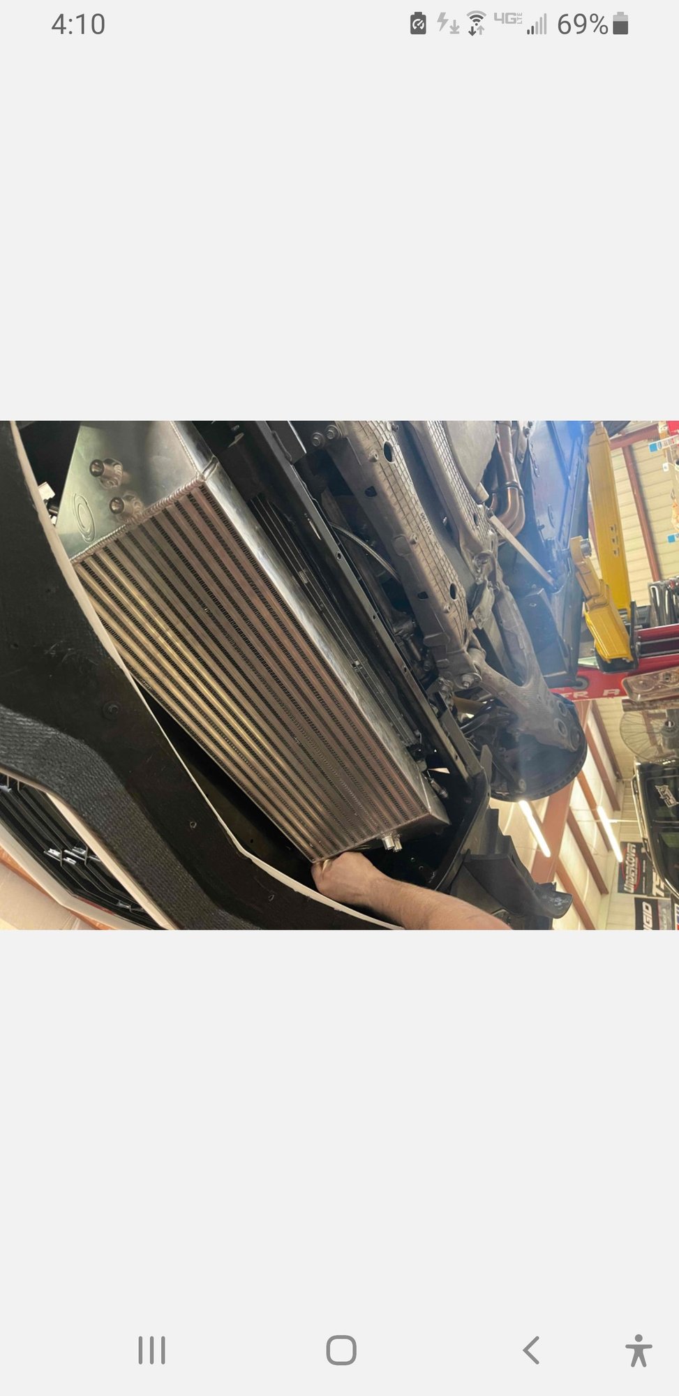

Old Aug 11, 2021 | 05:14 PM
16 Stingray
Joined: Feb 2019
Posts: 417
Likes: 38
Procharger intercooler installed. Just required trimming of the hoses supplied initially by A@A. Dyno tune scheduled for tomorrow afternoon.
It looks like its completely blocking the radiator
Old Aug 12, 2021 | 01:19 AM
16 Stingray
Joined: Feb 2019
Posts: 417
Likes: 38
Please tell that to Procharger. This is the intercooler that is paired with all their C7 kits. I'm most concerned with IAT'S. Which this will drop them significantly

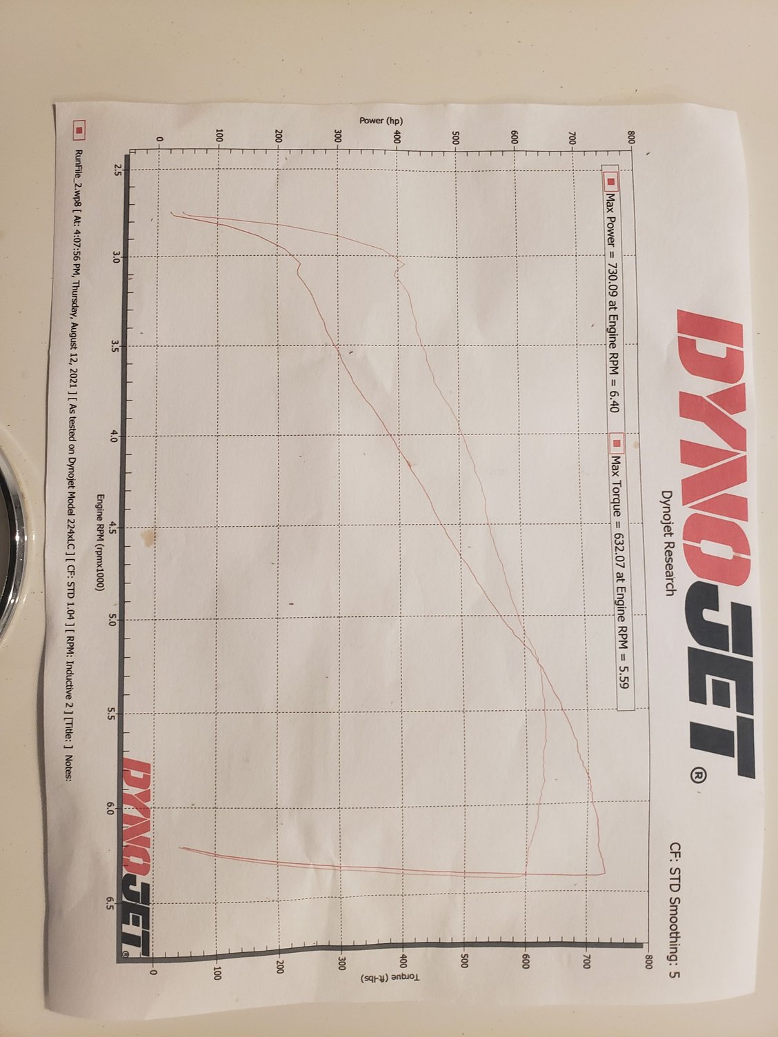

Old Aug 12, 2021 | 08:23 PM
16 Stingray
Joined: Feb 2019
Posts: 417
Likes: 38
No over heating. Car never reached 220f on my way home. It was 91f with a real feel of 100f here. Car made .5 psi more with the new intercooler. Intake air temps were 20 above ambient going in the car. It made 730rwhp. Plenty of fuel and in this scorching heat. This was on a very stingy 25yr old dyno jet 224.
Old Aug 12, 2021 | 08:42 PM
Gary barnes 1098's Avatar
Gary barnes 1098
Joined: Sep 2016
Posts: 1,583
Likes: 866
100 rwhp than you were expecting?
Old Aug 12, 2021 | 09:25 PM
16 Stingray
Joined: Feb 2019
Posts: 417
Likes: 38
Back in Chicago with no humidity and 60f car made 785rwhp. The heat and humidity greatly influence dyno results. Lol

Old Aug 15, 2021 | 02:28 AM
16 Stingray
Joined: Feb 2019
Posts: 417
Likes: 38
Cool…..Be safe.
Dyno from xxx in Pensacola. Tuned by John weeks. 93 pump, no meth. 91f ambient temp. Model 224, ancient. Know as the Stingy dyno on the panhandle. SOTP is sick. Thanks, Procharger and John Weeks tuning. Notice it was still climbing. I told him where to let off.
Old Aug 15, 2021 | 06:36 AM
Gary barnes 1098
Joined: Sep 2016
Posts: 1,583
Likes: 866
730 I a strong number . I really believe for a c7 mostly on the street that’s the happy spot. Anything more and your really losing a lot of it thru the tires. I’m at around 625 and I think I can go a little more without hopefully wrapping myself around a tree.lol
