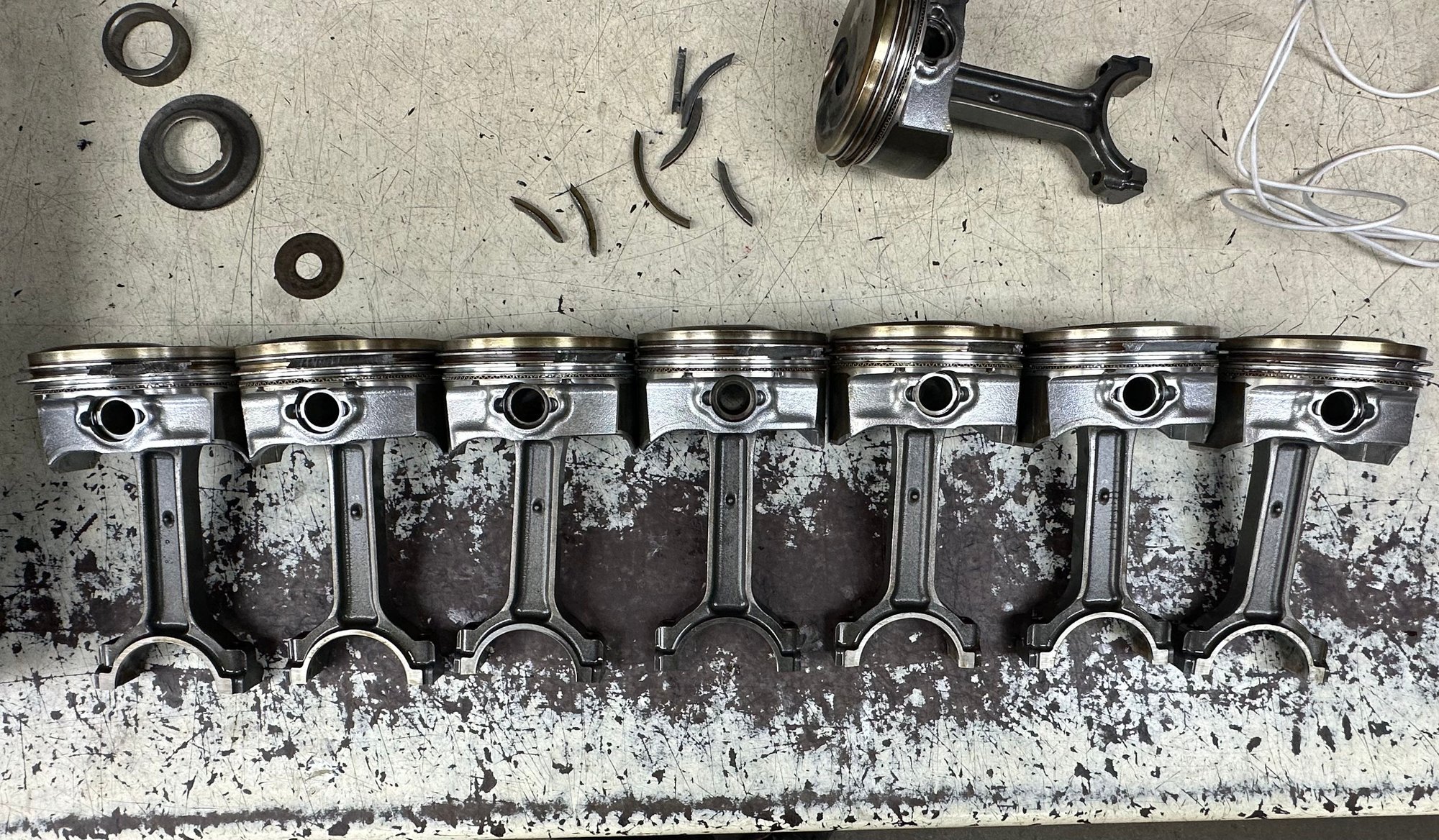

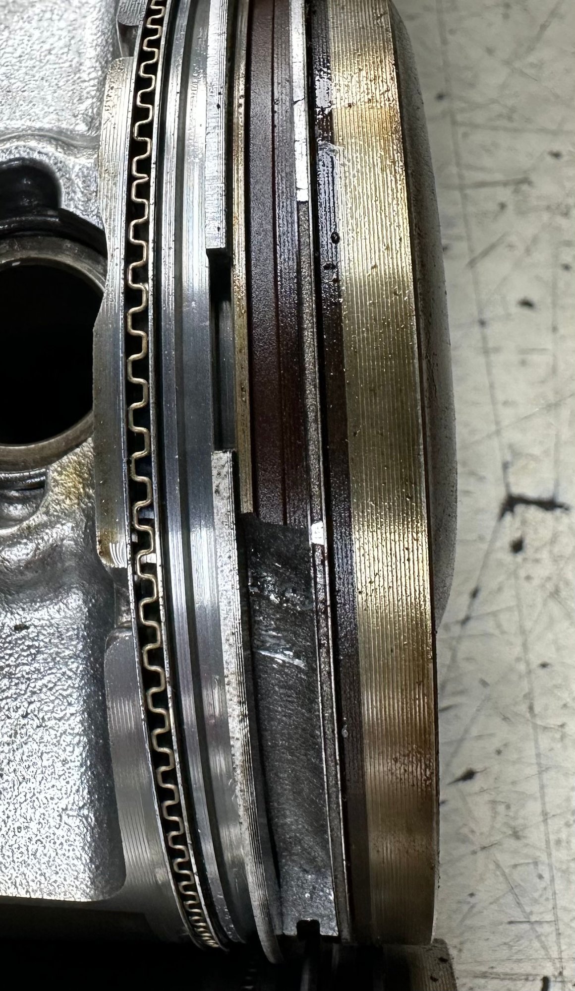

Default LT4 supercharger on my 6.2 LT1 broken piston rings
Originally Posted by johny125
I am new to superchargers and have read a bunch about how the LT1 is not the best platform to supercharge. Issues relating to the high compression ratio, piston ring tolerance, fuel starvation, etc, have me discouraged in adding a centrifigal or roots supercharger. So the question is........Has anyone actually experienced a supercharger FAILURE on an LT1 supercharger that is tuned correctly with 7# of boost? I am SO MUCH on the fence. Some installers say the injectors and fuel pump need to be upgraded to Z06 and some do not. Would it be cheaper and safer to just save for a Z06??
LT1 Corvette with a LT4 supercharger installed after approx 15,000 kms of driving engine is now torn apart as per broken piston rings on 7 out 8 pistons .
Broken piston C7 6.2 LT1 with LT4 supercharger installed .
Note : If your going to put a supercharger on your LT1 6.2 litre my best advise install forged pistons and rods lower the compression ratio to 10.5:1 or lower or your going to end up with a broken piston In the future .

What were the other aspects of the build? WHP? meth, any other mods?

No methanol could have helped , stock C7 with LT4 supercharger installed 573 RWHP. Aluminum pistons and the close ring gap along with 11:5:1 compression can’t handle 9 plus psi boost that’s it . Don’t make the mistake I did . I’m currently rebuilding my motor lowering the compression ration installing forged internals so the lower end can handle the 9 - 14 psi boost pressure.
Doesn't sound like you went over board at all. What were you up to when it popped?
I've put 10k miles on my stage 1 Edelbrock (which from what people say is the most docile kit you can get) 5.5lbs boost and its the only mod on the car. Car puts down a conservative 500whp/500tq which was my goal as i wanted the car to feel like my Gen III Viper.
