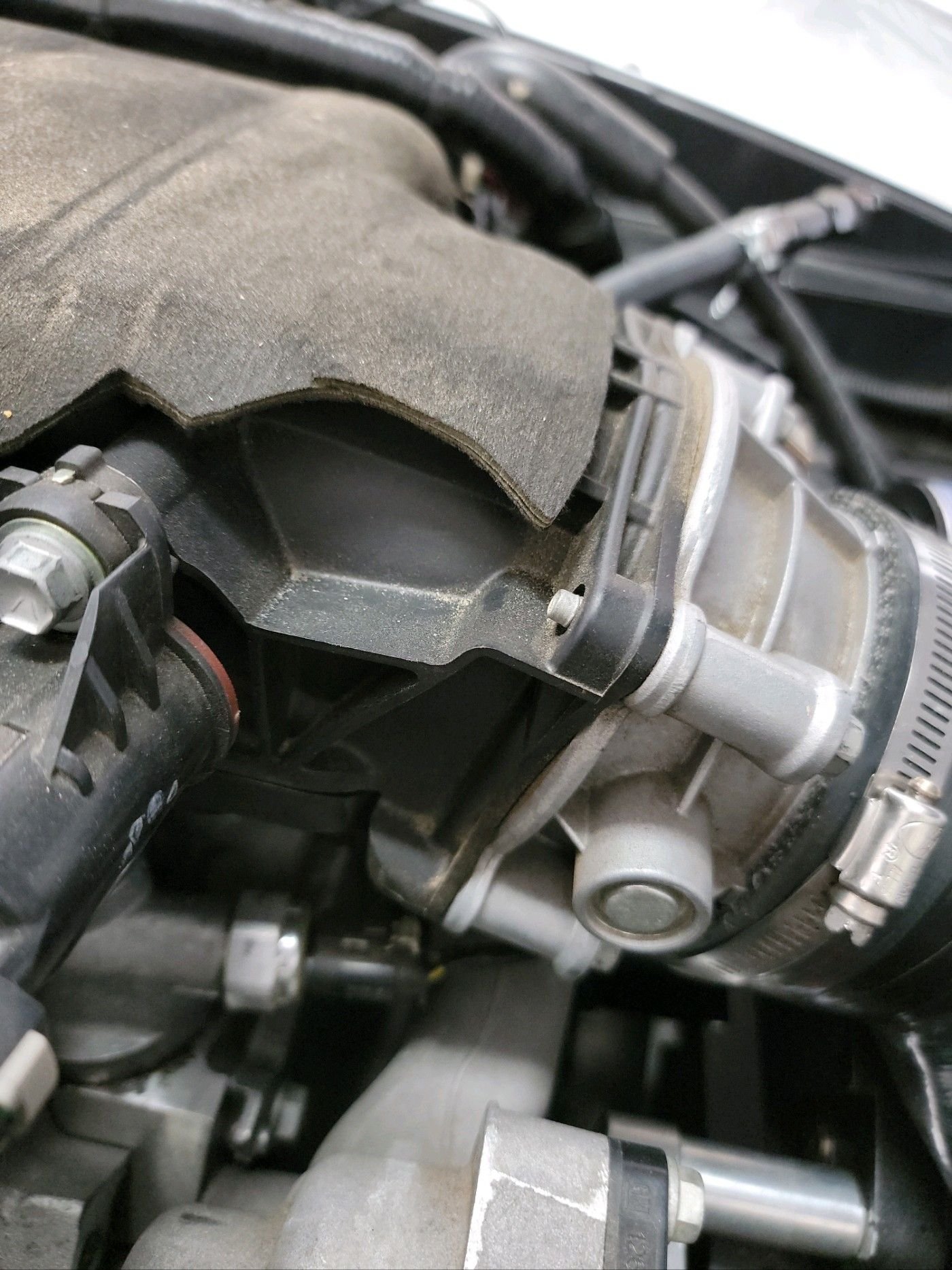

IN first picture below during the early stages of my install, you can see where you plug in the Breakout Harness in , and where my OEM MAP sensor is laying on the wire harness. This " wire mess was all tidied up after lol

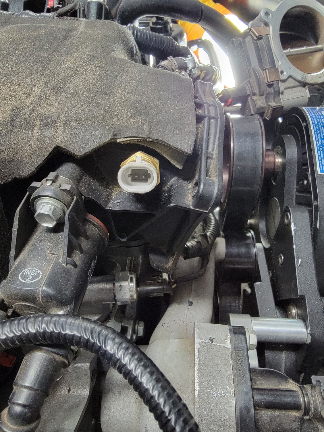

In the picture below you will see where your OEM MAP sensor is located on the manifold , this is the one you replace with the 3 bar ( this picture was taken before I installed the blower )
Because I was able to load a start up tune first , I dont know if you need a start up tune so the car would run , you might want to ask your tuner if you should have him install it as I am not sure how it will run if you plug all this in without being tuned
Dave
